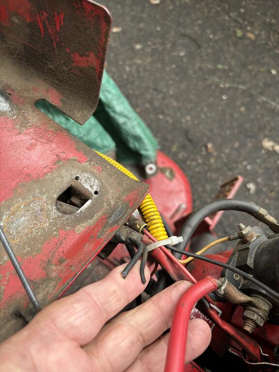

No spark
lynnmor

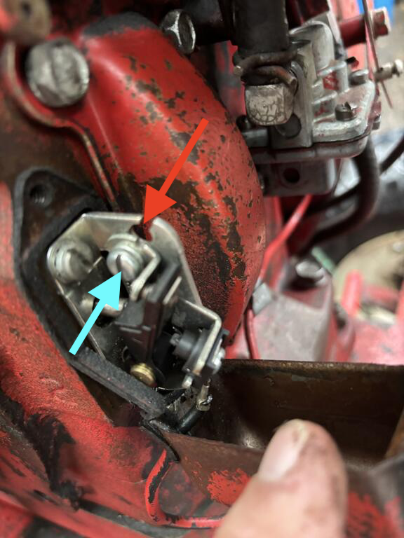

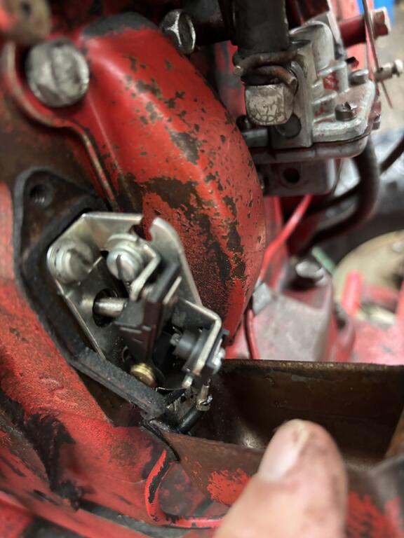

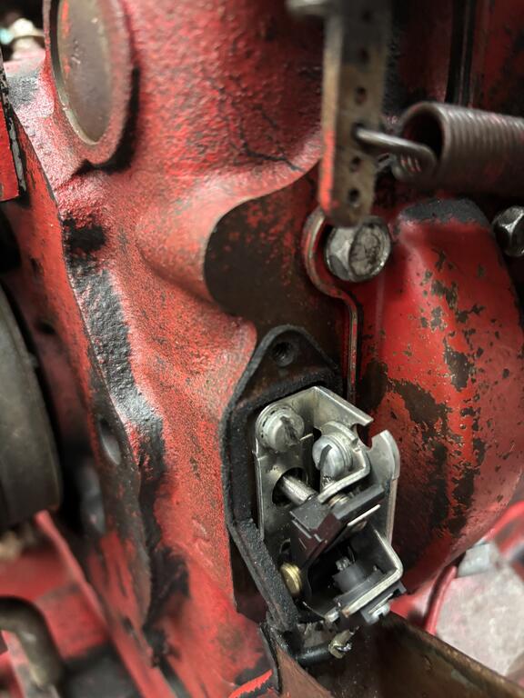

1 hour ago, slk said:
What should I try now?
Report back with the points gap.
slk
What should the gap be?
953 nut
Points gap should be 0.020" at their highest opening, watch this video.
