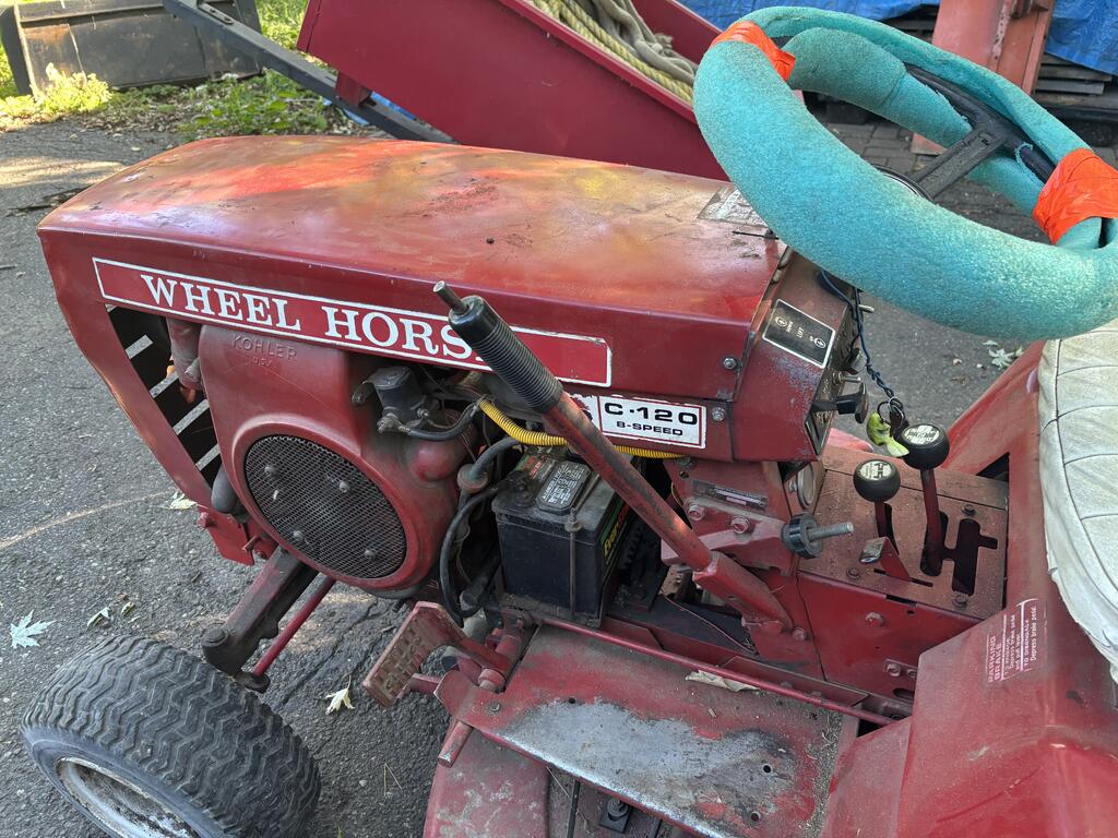

slk 38 #1 Posted September 16 Hey guys I just acquired this wheel horse c120 8 speed. I’m am not getting any spark. I cleaned the points and they looked good. I have no idea how to test anything else. I know where the condenser is and the coil but have no idea from there how to check. I have seen someone say there is a switch on the clutch pedal but I have not seen it. If there is I would not know if it is functioning or not. This tractor is new to me so I have never started one in my life. Need some help. Steve 1 Share this post Link to post Share on other sites

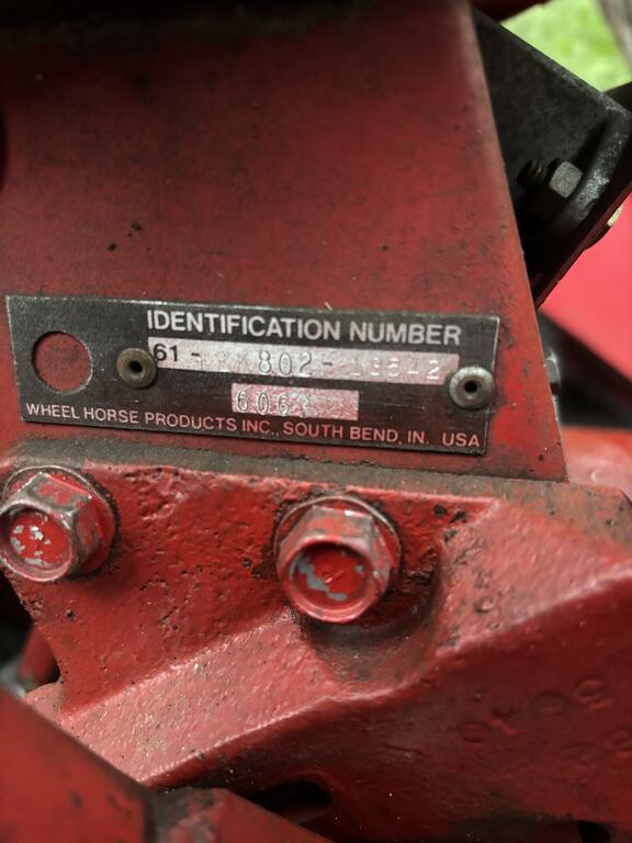

slk 38 #8 Posted September 17 I will have to take a better pic tomorrow but I do see the id tag on it now. it is in this pic but unreadable with this pic. will get more pics tomorrow. 4 Share this post Link to post Share on other sites

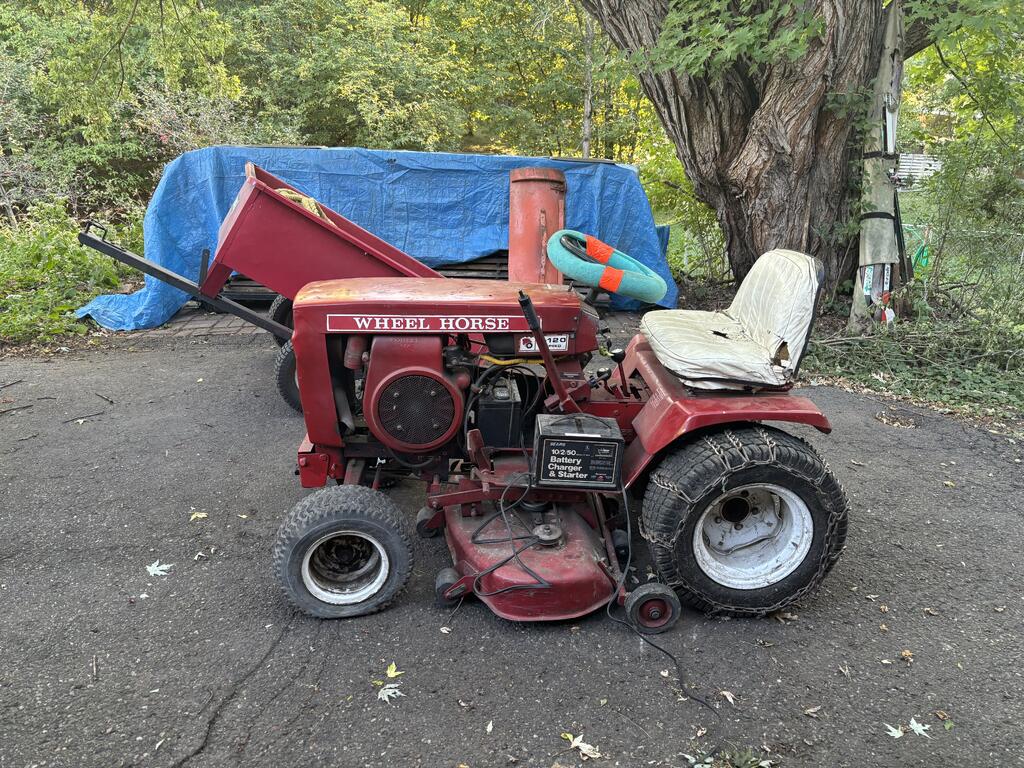

oliver2-44 11,802 #9 Posted September 17 (edited) That pool noodle on steering wheel is a first for me Nice looking tractor. Does it crank? If it does, see if you have voltage (12v) to the plus side of the coil. If you do, that says the switch and clutch safety switch are working. On my C160 the clutch pedal has to be depressed all the way down for the switch to engage. Edited September 17 by oliver2-44 Share this post Link to post Share on other sites

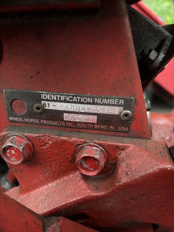

slk 38 #13 Posted September 17 (edited) Here is that ID tag info 61- 12K802-13542 6063 Edited September 17 by slk added more info Share this post Link to post Share on other sites
gwest_ca-(File Mod) 12,524 #14 Posted September 17 Thank you for posting those. Have added your data to the serial number records and that is in a file that contains SN in the title. Here are 19 files in no particular order for the 61-12K802 https://www.wheelhorseforum.com/search/?q=61-12k802&quick=1&type=downloads_file You should have a switch controlled by the pto lever. With the pto off 1/2 of that switch powers the ignition coil. Sometimes playing with the pto lever in the OFF position will close the switch. Wear in the linkage may be showing it's face. With the pto ON the seat switch powers the ignition coil so operator required in the seat to close the switch. Not a good thing but the previous owner may have disconnected this switch. Share this post Link to post Share on other sites

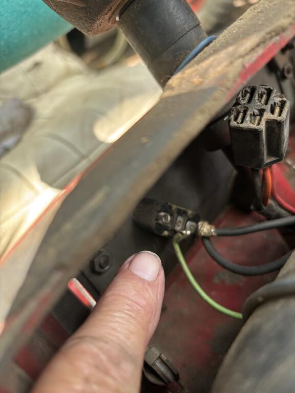

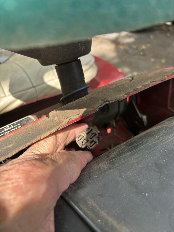

slk 38 #16 Posted September 17 This is what I was talking about with the ignition switch what the previous owner did. I have no idea if it will work right or not Share this post Link to post Share on other sites
953 nut 70,130 #17 Posted September 17 The momentary toggle switch probably takes the place of the START position of your ignition switch. You said there is no spark, I presume the engine will turn over from the switch, is this correct? If the engine will turn over from a switch then we can continue the trouble shooting and go on from there. Is the PTO Lever pulled back toward you? If not, pull it back and try again. Once you get the engine to turn over we will look for ignition. Connect a small insulated wire from your battery + to the + terminal on your ignition coil then crank the engine over checking for spark. If there is no spark disconnect the condenser from the coil and recheck. If there is no spark disconnect the temporary wire to the battery, remove the cover from the points, reconnect the temporary wire and use a plastic or wooden stick to open and close the points, you should see a spark. presuming you have a spark at the points disconnect the temporary wire and connect the condenser to the - coil terminal, reconnect the temporary wired and repeat the test at the points. There should still be a spark but probably a bit less. Once we have ignition spark we will go on to the rest of the wiring. Presuming you want to go original wiring you will need a 103990 ignition switch 1 Share this post Link to post Share on other sites
