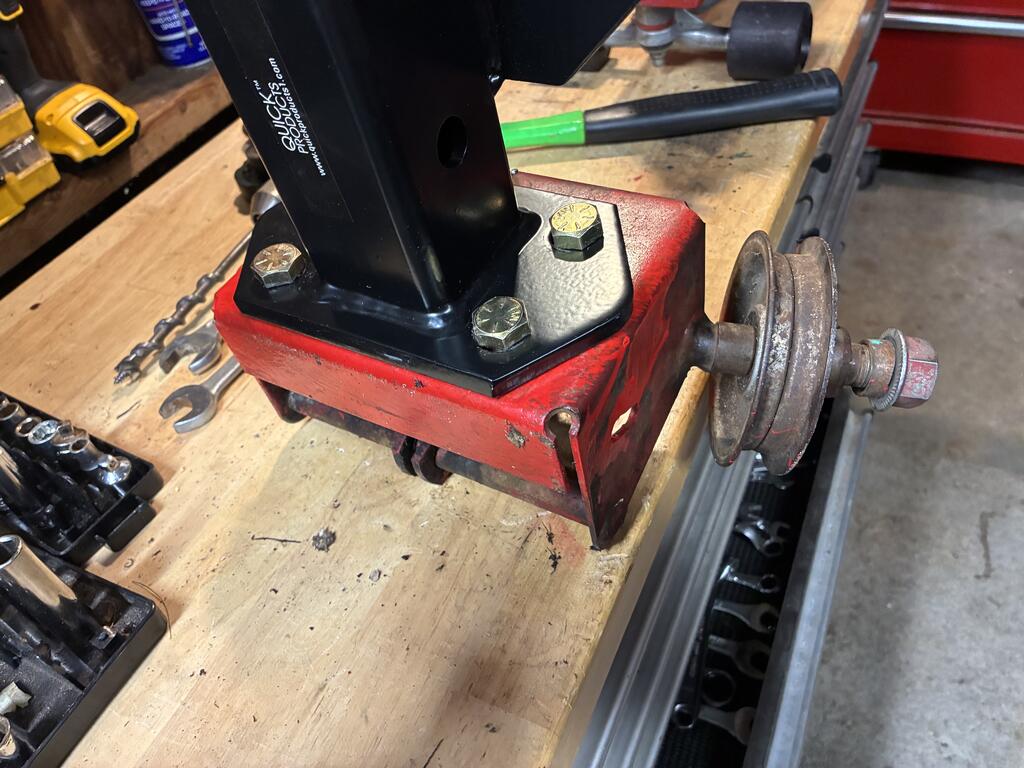

SylvanLakeWH

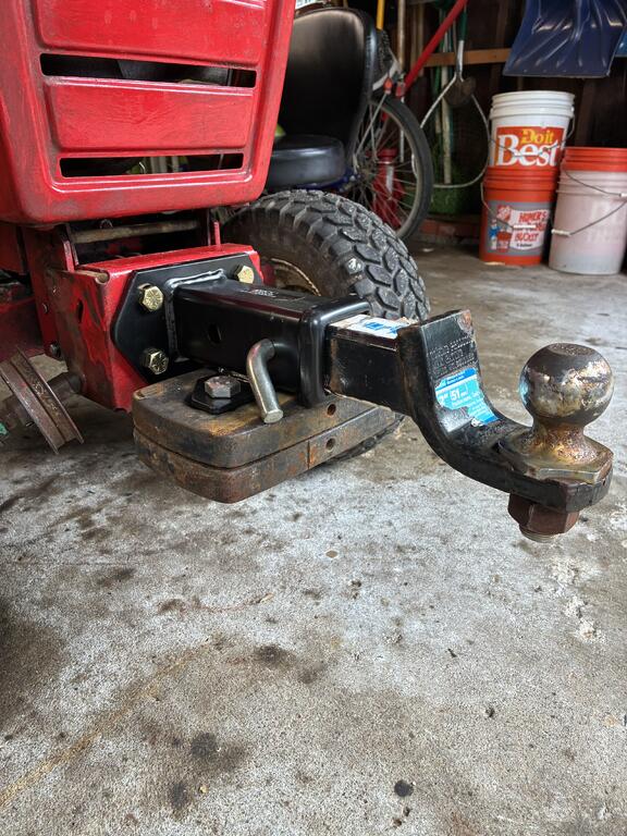

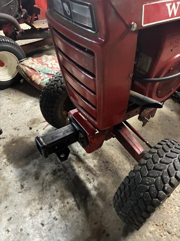

Today's progress:
C clips for the front tachomatic latch bar thingy (there were none...) :scared-eek:

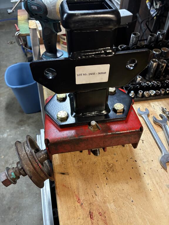

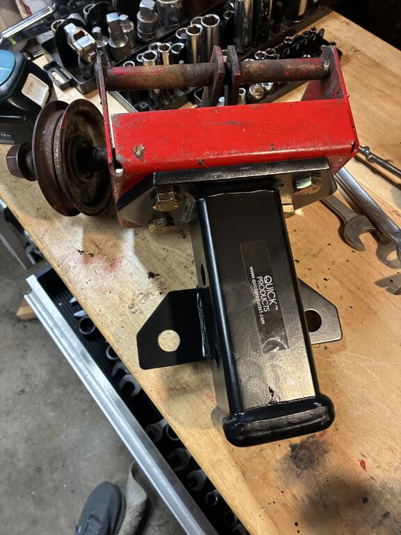

then converted it to a front 2" hitch. Can be easily converted back for mowing - remove 4 bolts and put knob back on...
can use for trailer maneuvering, weight, winch for plow etc... older I get more I like looking straight ahead at what I'm hitched to...
  • Like 5
  • Excellent 4

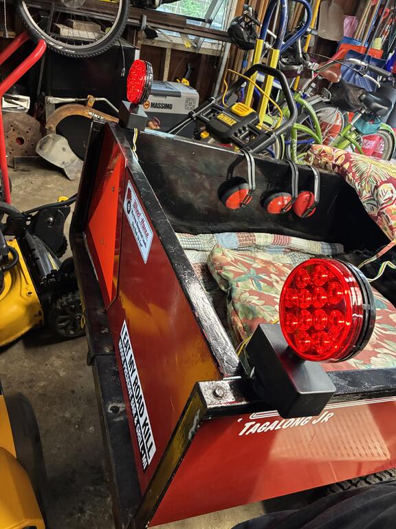

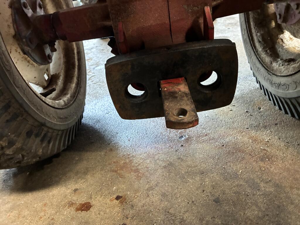

SylvanLakeWH
Today's progress:
Added 4 prong connection for magnetic trailer lights. Now when I'm hauling littles around the hood I have both the slow vehicle triangle and taillights...
Also fabbed a new hitch pin and added some weight front and back...
Finally, ordered taillights to complete the lighting system.

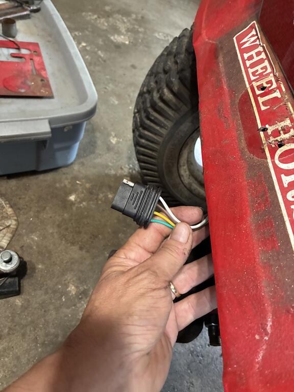

Handy Don
Pic of the connection, please?
  • Like 1
SylvanLakeWH
Here ya go...
Pilfered off old trailer wire set I had laying in the parts bin.
  • Like 1
Handy Don
18 minutes ago, SylvanLakeWH said:
Ah, I may have a couple of those in my “low voltage electrical supplies” box.

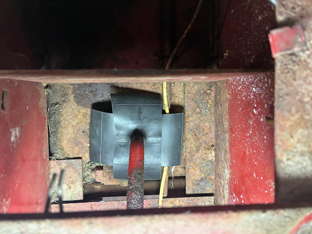

Added my custom designed transmission shift boot. 2 pieces of bicycle inner tube, overlapped... works shockingly good for the price... (Free) :handgestures-thumbupright:

Evening progress:

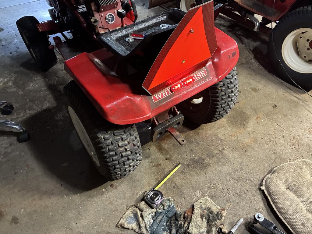

Tail lights installed. Yes they are on top of the decal. PO drilled and placed a light there - long gone - so I reused holes to extent possible and covered up the torn decal...
  • Like 3

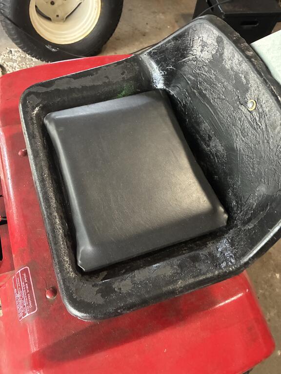

SylvanLakeWH
Today:
Seat pad made from materials on hand.
Ran around the hood - no surging!!!
Edited by SylvanLakeWH
  • Like 1
  • Excellent 2
ebinmaine
54 minutes ago, SylvanLakeWH said:
Seat pad
Hunk o' foam in that?
SylvanLakeWH
Yes

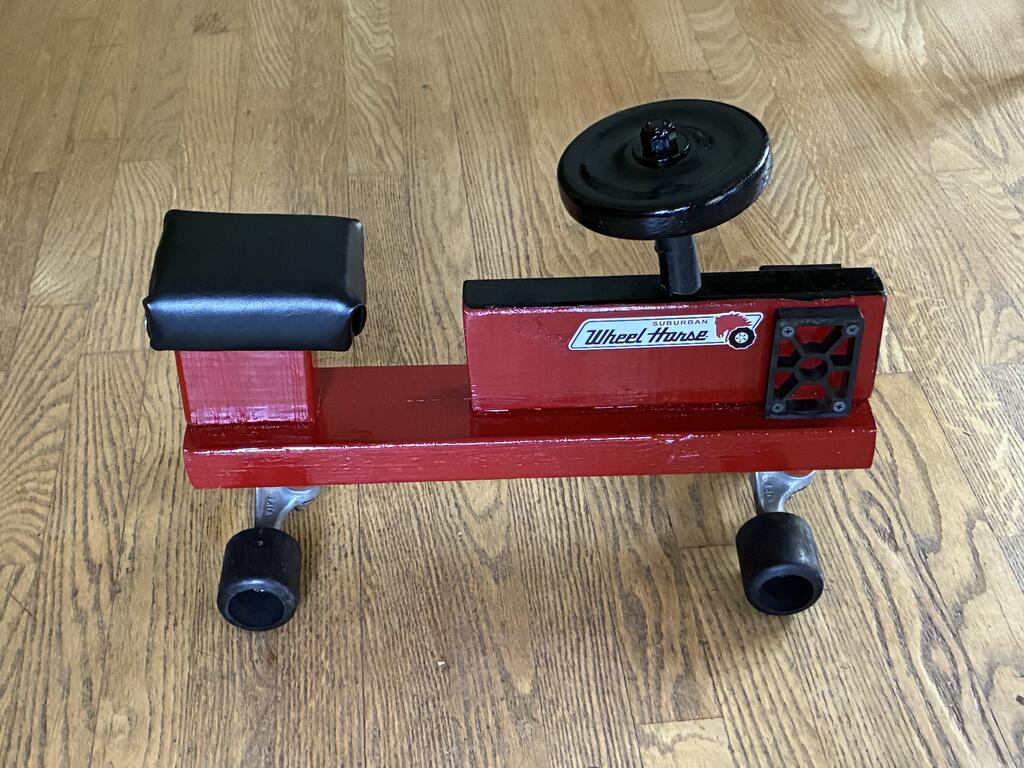

Old ensolite sleeping pad over pvc board with vinyl top... used for numerous applications... including another model WH that I'm working on. Here's the first one... 1 and 3 year old testing engineers approved...
  • Excellent 1
  • Heart 3

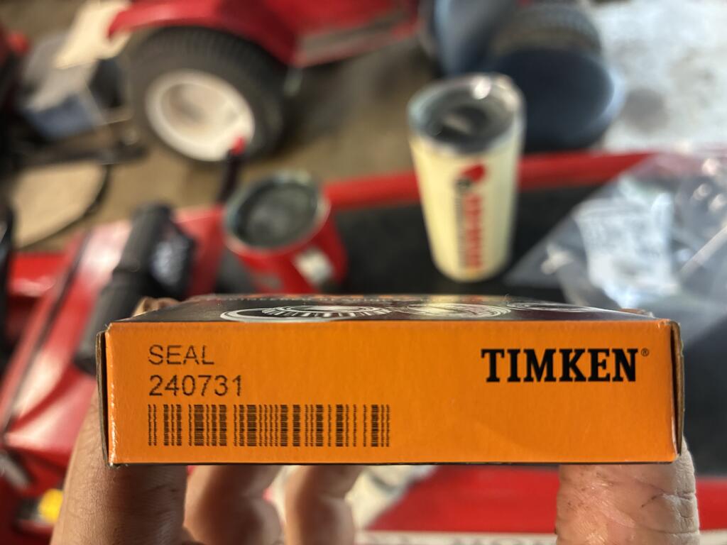

SylvanLakeWH
Replaced leaking axle seal. Hub puller worked perfectly again...
1" axle seal #'s
100863
SKF9815
Timken 240731
Sourced at local auto shop for $7.50 each. Called at 7:30 am, picked up at 11:30 am. :handgestures-thumbupright:
My thanks to @squonk for guidance on the seals...
  • Like 5

SylvanLakeWH
Posted (edited)
Couple things I used to make life easier. I'm sure many of you already know/ do these, but they are tricks that make life easier so I'm passing them on...
1. I use a 1" ID piece of pvc pipe about 6" long to press in the oil seal. Works for bearings too. Gentle taps with small hammer and they seat just right.
2. I use a 15mm socket backwards on a 1/2" socket wrench/ torque to tighten / loosen the axle set screws with the funky square head. The set screw head fits perfectly on the 3/8" side and the 1/2" socket wrench holds perfectly on the 15 mm side.
Typo
