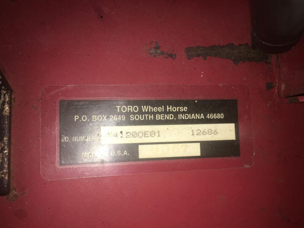

sqrlgtr 4,035 #1 Posted September 7 Just wondering what the top right number (serial# maybe?) and the number on bottom of this id tag represents. I understand the top left number and know it signifies that its 1991 520H. The bottom # is hard to read and believe it says 0067? Any ideas? Share this post Link to post Share on other sites
702854boy 1,152 #2 Posted September 7 (edited) Yes, the bottom number is 0067 but I'm sorry I can't tell you what it means Edited September 7 by 702854boy 1 Share this post Link to post Share on other sites
gwest_ca-(File Mod) 12,494 #3 Posted September 7 The 0067 is considered the Julian build date and actually it is the date that they scheduled your batch of tractors to be built. Click on the picture in this link to see where yours lands. Adding We had already recorded the 12686 serial number from somewhere. 1 Share this post Link to post Share on other sites
sqrlgtr 4,035 #4 Posted September 7 6 hours ago, gwest_ca said: We had already recorded the 12686 serial number from somewhere. Now that I think about it, I believe I sent it to you a while back. I found the model list and said it was a 1991 but was wondering about the other numbers. @gwest_ca thanks for the info. I dont understand how they get March 8 1990 out of 0067 though . Share this post Link to post Share on other sites
gwest_ca-(File Mod) 12,494 #5 Posted September 7 With Julian dates the first 0 indicates the year. That could be any year ending with a 0. The 067 is the 67th day of that year being March 8. Share this post Link to post Share on other sites
sqrlgtr 4,035 #6 Posted September 7 11 minutes ago, gwest_ca said: With Julian dates the first 0 indicates the year. That could be any year ending with a 0. The 067 is the 67th day of that year being March 8. Thanks for clearing that up for me I just couldn't wrap my head around how they came up with it. In my own defense I haven't par took of my regular coffee bean fix this morning...... 1 Share this post Link to post Share on other sites
