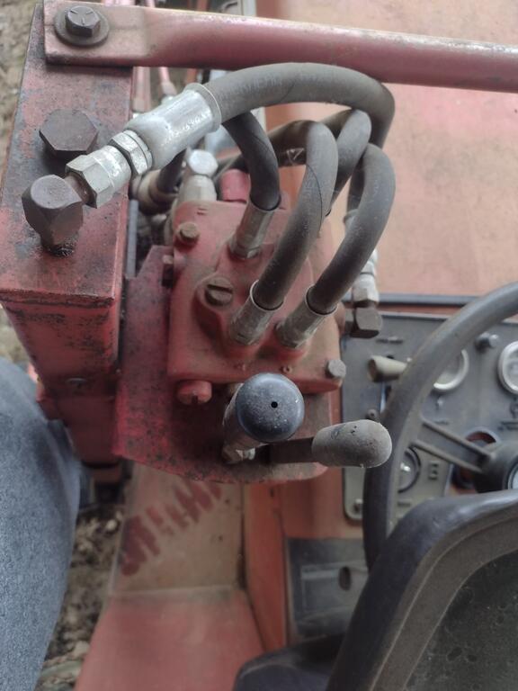

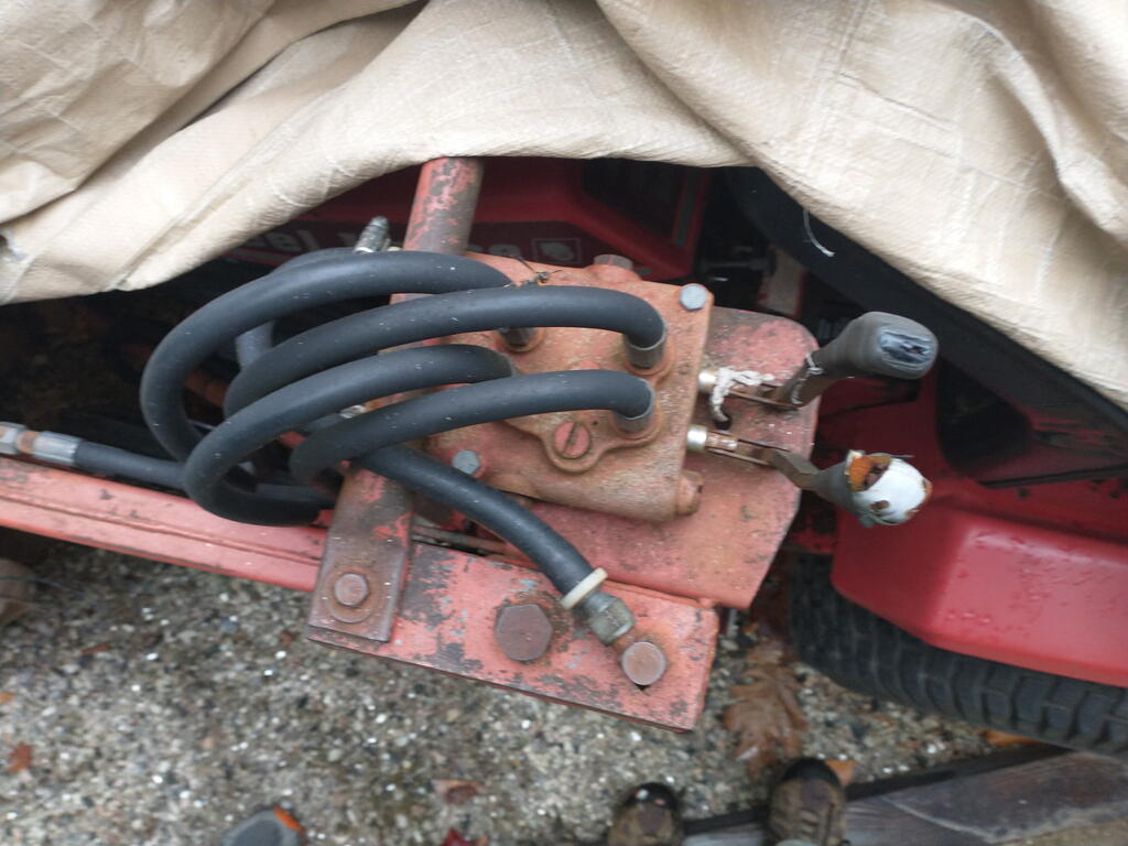

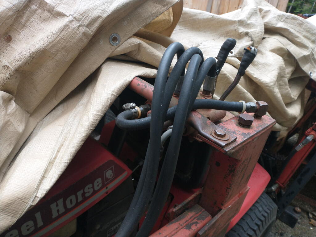

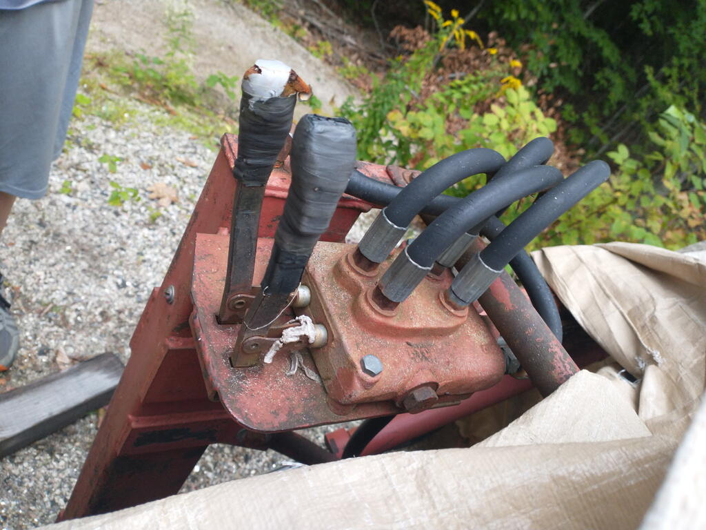

Finally getting around to working on my ark loader.  The previous owner said he thinks the problem is with the spool valve.
As I've learned a bit more about hydraulics now, I'd like to get this all sorted out.
I noticed the power beyond port is connected to the reservoir return.  Is that right?
Anyone see anything blatantly incorrect?

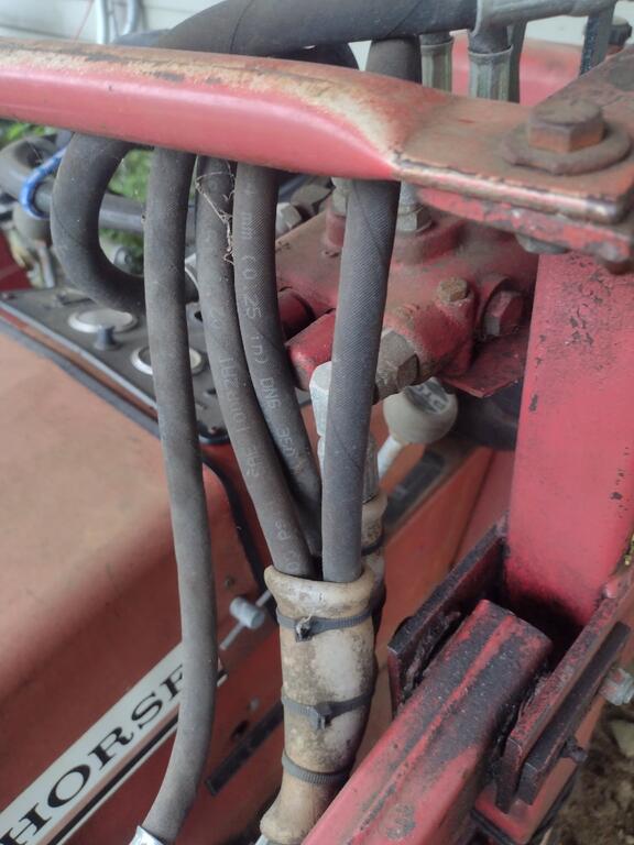

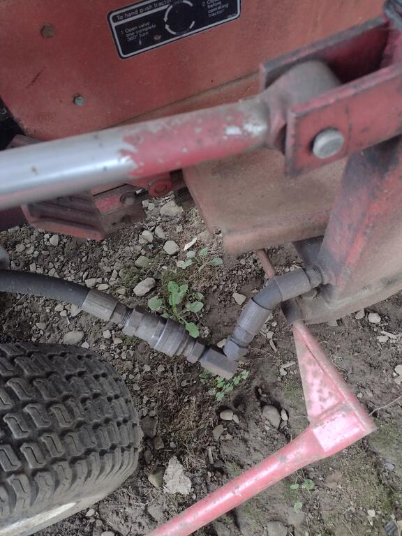

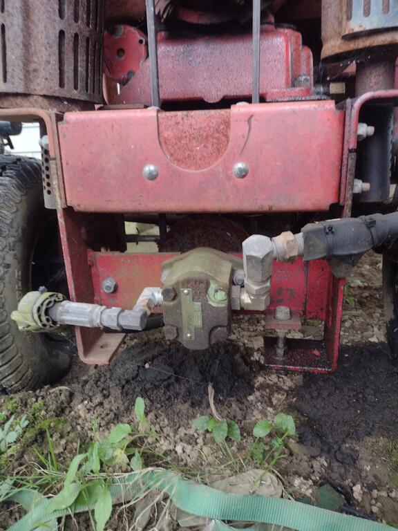

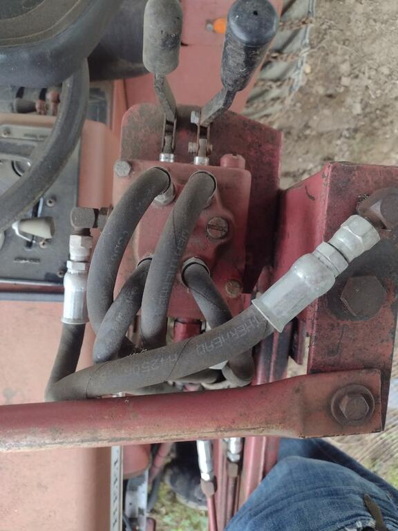

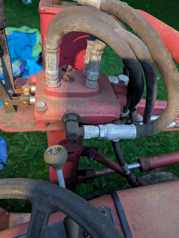

Some extra photos.
Also, 1980 WH D-200 with 550? Loader
Looks correct to me. The Power beyond port is an out port.
What kind of trouble are you having that needs to get sorted out?

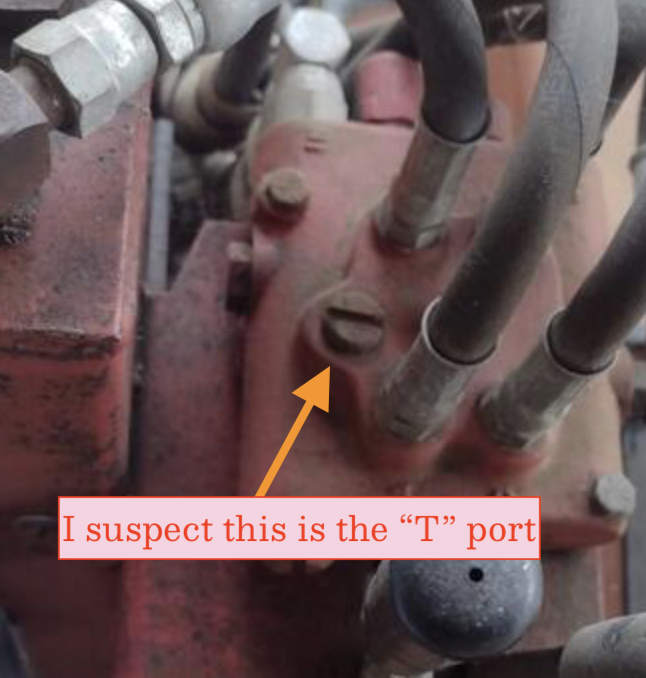

I don’t know that control valve specifically, but with Power Beyond (typically labelled “N”) connected to the reservoir is there a separate Tank (“T”) port on the valve and, if yes, where is it connected?
T and N are both “out” ports, but they have different purposes.
T always gets plumbed directly to the reservoir (i.e. the Tank), can often use lower-pressure hoses, and should never see much pressure. It’s job is to route fluid from the non-pressure side of a cylinder into the reservoir while the pressure side of the cylinder is being filled
N typically get plumbed to the P port on an additional control valve (which must have its T plumbed to the reservoir) via hose that can support FULL PRESSURE. N's job is to allow working pressure fluid to reach “beyond” the current valve while still supporting full pressure/flow to cylinders attached to the current valve.

Have you verified the pump is actually pumping? You can remove that return hose going to the reservoir and direct it back into the reservoir or catch it in a container.

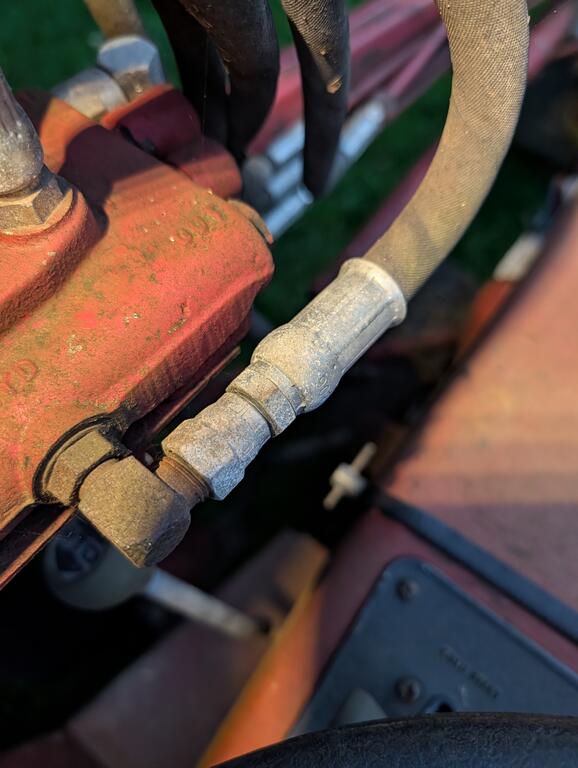

I didn't see a label on that.  I assumed it was a mounting bolt or something.
I'll see if I can turn that plug loose and take a look.
Handy Don
 Its just that the location between the A and B ports for the two cylinders seems appropriate.
That said, I’m assuming that the unit did work at some point with the current plumbing so I would leave that alone until other diagnostics are done first.
Anyway, unless you are planning add more hydraulically-controlled stuff, the N (power beyond) to reservoir is suitable plumbing. Actually, this is incorrect. SEE NEXT POST.

Surprised no one called me out on this, but the T port must be connected to the reservoir or else there is no exit for fluid from the low pressure side of the cylinders when they are being activated.

I'm thinking that if the N port is connected to the tank would be equivalent to a short in electrical wiring - the pressure and flow would drain off into the tank, not leaving any to operate the device connected to the directional valve.  Hydraulic pressure and flow is like students - it follows the path of least resistance.
Handy Don
The N flow gets intercepted when a control in the valve directs fluid to its A or B port.
A chain of valves with N’s connected to P’s where the last valve’s T connects to the reservoir is a complete circuit. Any valve in the chain can divert the flow to a cylinder thus temporarily “starving” the valves downstream. Holding that valve open at the cylinder’s travel limit, causes the pressure relief valve to dump the flow direct to the reservoir.
On equipment where multiple cylinders must operate simultaneously, they are all controlled via a single, “ganged” control where a single supply “gallery” ports to all the cylinder valves. The ARK loader’s two-spool control is a “ganged” control.

Mine were all marked IN OUT BYD and the rest were the cylinder ports.
Handy Don
So “IN” was “P”, “OUT” was “T”, and BYD was, “N”.  Unless used, BYD should be plugged.

@ebinmaine Hey Eric, can you post a pic of that loader valve?
  • Like 1
Handy Don
The ARK control may be one which has OUT and BYD internally joined unless a special plug is inserted to separate those two ports.
Need the specs.
ebinmaine
Be happy to. Later today.

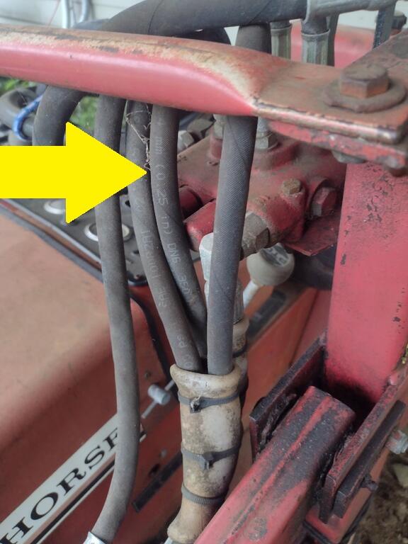

ebinmaine
  • Like 1
wallfish
Is there a port on this corner? If so, move the plug from it to the BYD and the hose to that port.
None of your pics show it very well but I can see some lettering there like the ID for a port.
IMG_20260830_164058970.jpg.e4abe91cf6e8d2ee6b6eaea0f53c23a5.jpg.cd651ad6eae9c84bf6782a97c305a5b8.jpg
Yes there is an out port on the front.  That is probably at least part of my problem.
