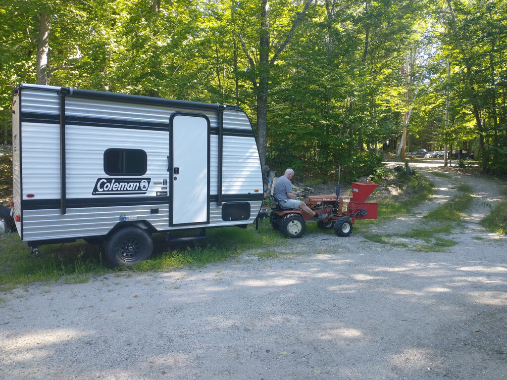

Juat yesterday we moved our camper with one of my tractors.
This is a specially prepared rig built for heavy duty towing.
