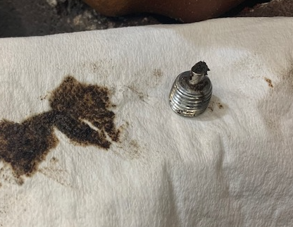

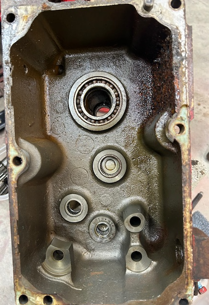

JoeM 10,318 #3 Posted August 30 Sure wish there was a sure fire answer for this question. Flushing and refilling is a bit of a gamble. The inside of those cases is not painted. If left unattended for any length of time, rust forms and is pretty hard to get out without disassembly. Flushing pretty much will remove the watered down oil but in the past I have found the rust that forms on the inside of the case on top remains. Of course the best is to disassemble inspect and clean. @stevasaurus has good vids for this on the tube. Does require some general mechanical ability. This case was flushed and then disassembled, note the rust on the top of the case. One indicator is the dip stick, if it is real rusty that is telling you something. A magnetic drain plug can help but has limitations. 4 1 1 Share this post Link to post Share on other sites
ri702bill 13,303 #4 Posted August 30 1 hour ago, JoeM said: One indicator is the dip stick, if it is real rusty that is telling you something. Excellent point. A couple of things...... Flushing with diesel, instead of engine oil, is better because of its lower viscosity. This will make leaking seals - and those on their way out - very apparent. If you have one failed seal, you probably have more. Plan on changing the shifter boot for a good fitting new one. The shifter acts like a wick if it gets wet. (That is most likely how the water got in). 2 1 Share this post Link to post Share on other sites
