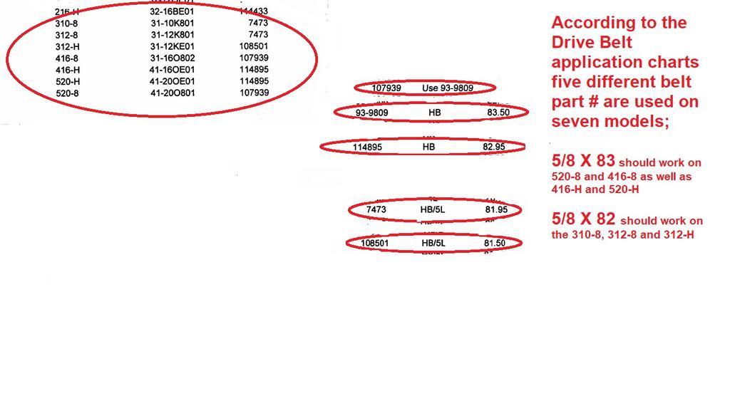

953 nut 70,262 #9 Posted August 29 I took a look at the belt application chart and here is what I came up with, you be the judge as far as how much longer or shorter belt may work, to me we aren't launching Artemis 3 to the moon, just driving a Wheel Horxse. Share this post Link to post Share on other sites
