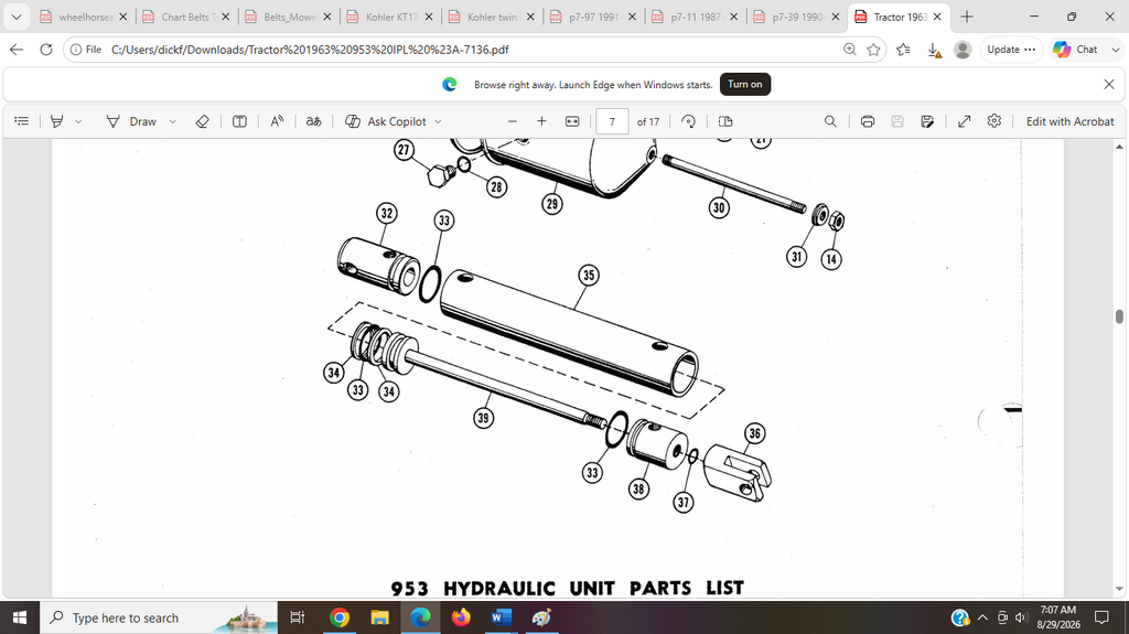

drivermanjeff@gmail.com 0 #1 Posted August 29 How do you take apart the hydraulic cylinder on a 953 tractor Share this post Link to post Share on other sites
Ed Kennell 47,431 #2 Posted August 29 to the Hydraulics for dummies.*Help* - Wheel Horse Tractors - RedSquare Wheel Horse Forum Share this post Link to post Share on other sites
953 nut 69,604 #3 Posted August 29 (edited) The majority of 953 hydraulic cylinders are easily disassembled by removing the hoses. Once the hoses are unscrewed the clevis can be unscrewed from the shaft, the front guide can be removed by applying a little air pressure to the place the hose had been connected to on the rear head and rear head can be removed by clamping the cylinder in a vise and using a long bar through the 3/4" hole to twist it a bit. This manual should be helpful. Edited August 29 by 953 nut 2 Share this post Link to post Share on other sites
drivermanjeff@gmail.com 0 #4 Posted 5 hours ago Thanks everyone for all the help I got from so many. I got it all taken apart, rebuilt, and put back to use really smooth. It's been mowing great for a good amount this year. Share this post Link to post Share on other sites
