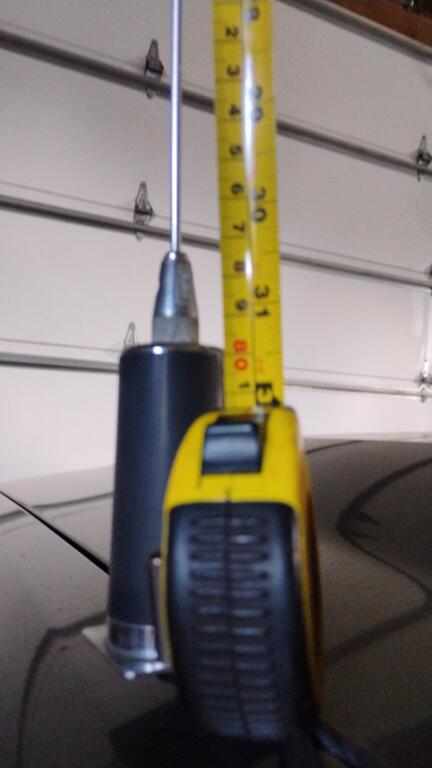

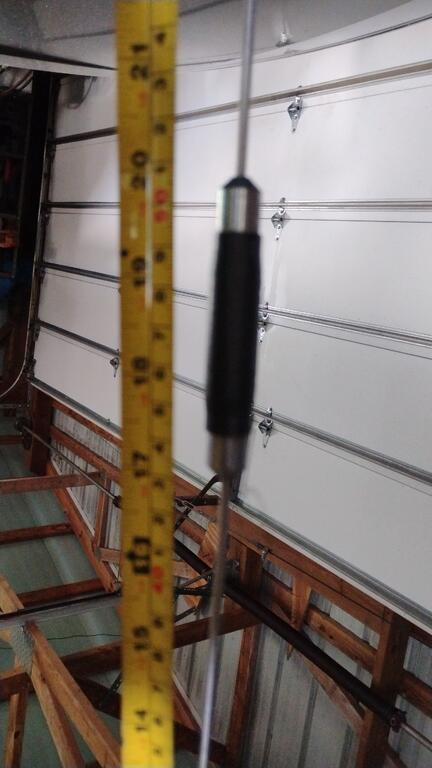

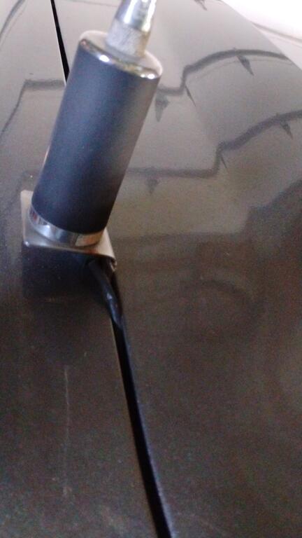

Ed Kennell 47,308 #5 Posted August 26 My radio guy installed this one on my 2010 F-150. The black thingy is slid up and down to tune and locked with set screws. 1 Share this post Link to post Share on other sites
