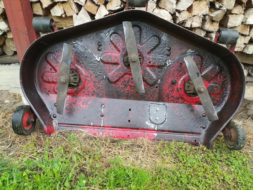

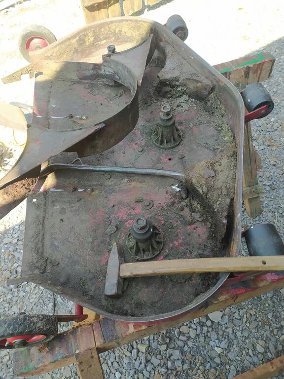

Stan50 247 #1 Posted August 25 Convinced by @peter lena, I cut the baffles out, and did some minor repairs. I hope that will extend life of the deck and shorten cleaning time for sure. 1 2 Share this post Link to post Share on other sites
ri702bill 13,365 #2 Posted August 25 As I recall, at least one model of the 3 blade recycler deck had bolt in removable baffles - THAT sounds like a solution & a good idea... 1 Share this post Link to post Share on other sites
953 nut 70,584 #3 Posted August 25 My baffles removed themselves one day while mowing. One side fell down, dug into the ground and stopped me dead in my tracks. Had to back it up all the way to the shop to remove the rest. Those big clods of grass that built up at the baffle intersections would have rotted the deck out. 2 1 Share this post Link to post Share on other sites

Bugzilla46310 68 #5 Posted August 30 If you just removed the 2 triangular pieces, wouldn’t you get similar results with respect to the grass clippings not packing in behind the baffles? Share this post Link to post Share on other sites

Stan50 247 #7 Posted August 31 19 hours ago, Bugzilla46310 said: If you just removed the 2 triangular pieces, wouldn’t you get similar results with respect to the grass clippings not packing in behind the baffles? I have 1.5 acre grass to cut, terrain varies from small orchard, plain lawn and even small old hayfield so grass is often wet,and deck without the baffles is easier/faster to clean. I have mole problem too, so grass is sometimes packed with soil. Share this post Link to post Share on other sites
