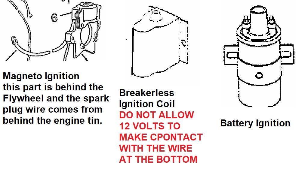

pfrederi 21,339 #2 Posted August 23 Very likely at some point in the removal reinstallation process they fried the Breakerless system by letting voltage get to the coil. You have to wire it like a magneto system. Before anything make sure the ignition switch is for a mag system ie. There is an M terminal on it Test to see if there is spark with a tester or just lying on the head. Kohler service manual covers breakerless Click on picture to download it. 2 Share this post Link to post Share on other sites
953 nut 70,564 #3 Posted August 23 (edited) Just to be sure we are all talking in the same terms take a look at5 the drawings and ensure you are working with a breakerless ignition. Not all Wheel Horses are wired alike so having the model number of the unit the engine is going into would be very helpful. Edited August 23 by 953 nut 2 1 Share this post Link to post Share on other sites

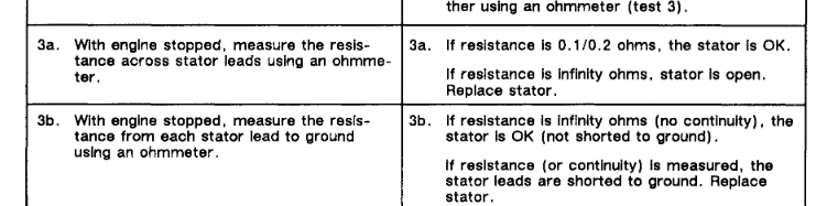

JBuys 1 #6 Posted August 26 Is there a non running test for the Stator? The tests that I see are with the engine running. Maybe an Ohm test? thanks Share this post Link to post Share on other sites
953 nut 70,564 #7 Posted August 26 Yes, you can do a resistance test, the engine service manual that @gwest_ca provided gives step by step instructions. Share this post Link to post Share on other sites
