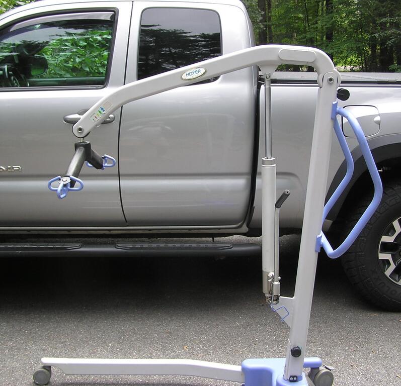

Wayne0 1,663 #1 Posted August 21 Snagged this off CL for an upcoming motor swap in my WorkHorse. $40. Couldn't pass it up for that price! 5 1 Share this post Link to post Share on other sites
ri702bill 13,352 #2 Posted August 21 Ah, yes - the "Chubby Boy" patient lift used in Medical Facilities. Aperfect unit for two Twenties! Share this post Link to post Share on other sites
Bill D 3,194 #3 Posted August 21 28 minutes ago, Wayne0 said: Snagged this off CL for an upcoming motor swap in my WorkHorse. $40. Couldn't pass it up for that price! I have one of those. Works great. What are you swapping into your Work Horse? Share this post Link to post Share on other sites

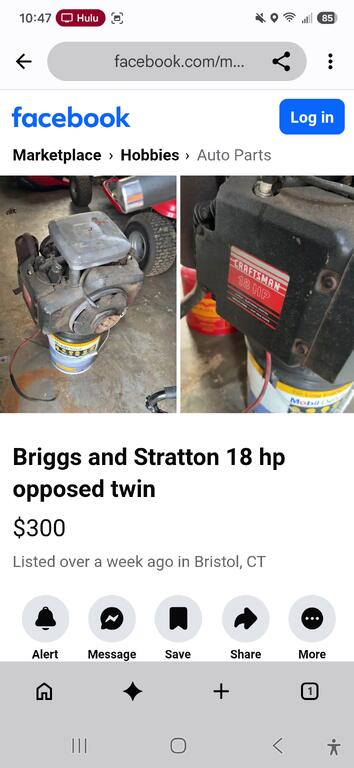

Bill D 3,194 #9 Posted August 22 15 hours ago, Wayne0 said: You put me on to a Briggs boxer in CT. I'm visiting my son in Monson, Ma at the end of the month and it's an hour and change from there. BTW, thanks for that! Your welcome! Is this the engine you're picking up? If so you'll need an vacuum impulse pump to make it work, or swap the carb from your old engine. For some reason the engines from Craftsman tractors don't have the carb with the built in fuel pump. The charging stator will also need to be changed as well. I personally like to upgrade to the higher amp charging system with the external regulator. 1 Share this post Link to post Share on other sites

Wayne0 1,663 #13 Posted August 22 27 minutes ago, Bill D said: Your welcome! Is this the engine you're picking up? If so you'll need an vacuum impulse pump to make it work, or swap the carb from your old engine. For some reason the engines from Craftsman tractors don't have the carb with the built in fuel pump. The charging stator will also need to be changed as well. I personally like to upgrade to the higher amp charging system with the external regulator. That's the one. I have an electric pump or could swap the carb. 1 Share this post Link to post Share on other sites
SylvanLakeWH 32,892 #14 Posted August 22 8 minutes ago, 953 nut said: Our school custodian also had a pig farm, each day he would load all of the refuse from the kitchen and lunch room in his small dump truck and take it home to the pigs. A state (NY) auditor took exception to that policy and said it had to go out for bids, an employee using their own vehicle in this manner was unacceptable. My mother convinced the custodian to obtain a business license and bid on the refuse removal contract. He was the low bidder so now he was getting free food for the pigs and being paid for it. Pathetic example of how stupid we are as a society... excellent resourcefulness on the part of the janitor is met with bureaucratic bs... and taxpayers end up paying more for the same services... Great for the farmer, but not for taxpayers... 3 Share this post Link to post Share on other sites
Bill D 3,194 #15 Posted August 22 2 minutes ago, Wayne0 said: That's the one. I have an electric pump or could swap the carb. You might be better off swapping the carb. The older carb is fully adjustable. If the carb on that engine is the same as the one I have, then it has a fixed main jet. 2 Share this post Link to post Share on other sites

Wayne0 1,663 #22 Posted August 22 8 hours ago, Bill D said: You might be better off swapping the carb. The older carb is fully adjustable. If the carb on that engine is the same as the one I have, then it has a fixed main jet. BTW is the Craftsman stator wimpy? Does the WH motor have more amps? Share this post Link to post Share on other sites
Bill D 3,194 #23 Posted August 22 The Briggs WH stator is a two circuit stator, like many Briggs. The red wire is a 3 amp DC charging circuit, the black wire is an AC output strictly for the headlights. The Craftsman stator should be a one wire AC output requiring a rectifier to charge the battery. I would personally upgrade to a stator with two wires and the corresponding rectifier. That would give you a 13 amp output for adding lights if you want. I did this on a GT1142. I removed the wire between the headlight switch and the AC output from the original stator. I then made a short jumper from the unused ACC terminal on the key switch to the headlight switch. Is the wiring on your GT1800 unmolested? Share this post Link to post Share on other sites

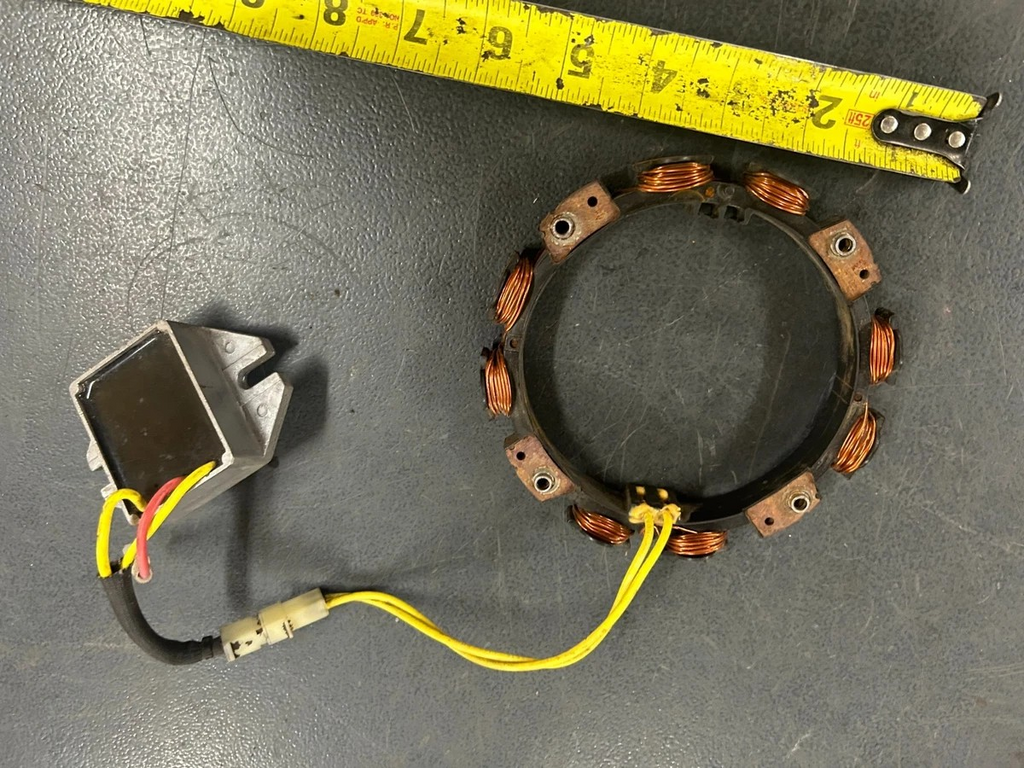

Bill D 3,194 #25 Posted August 22 This is the stator and rectifier I recommend upgrading to. If you have a local mower shop that has a dead Briggs around you may be able to get the parts cheap. Share this post Link to post Share on other sites
