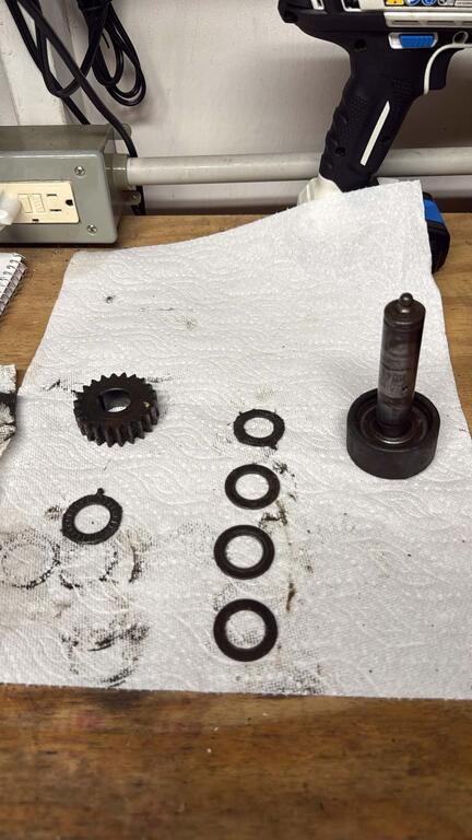

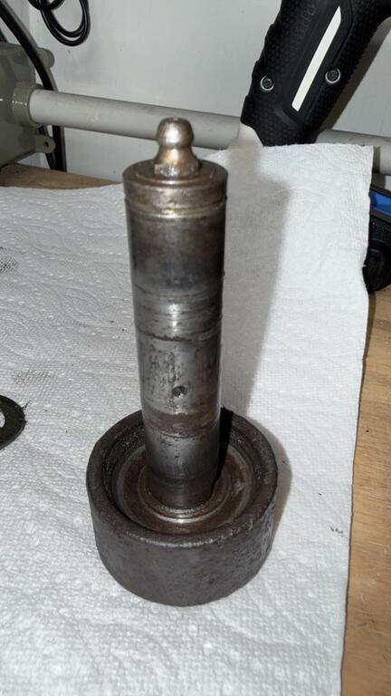

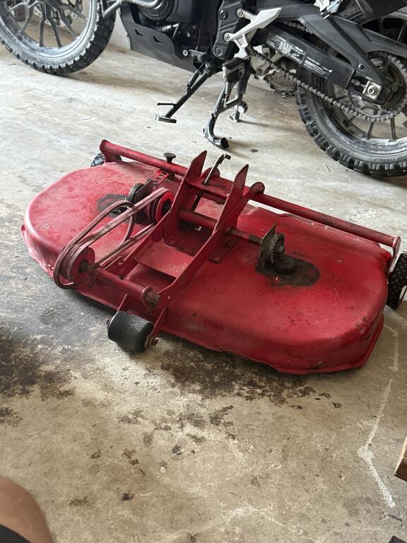

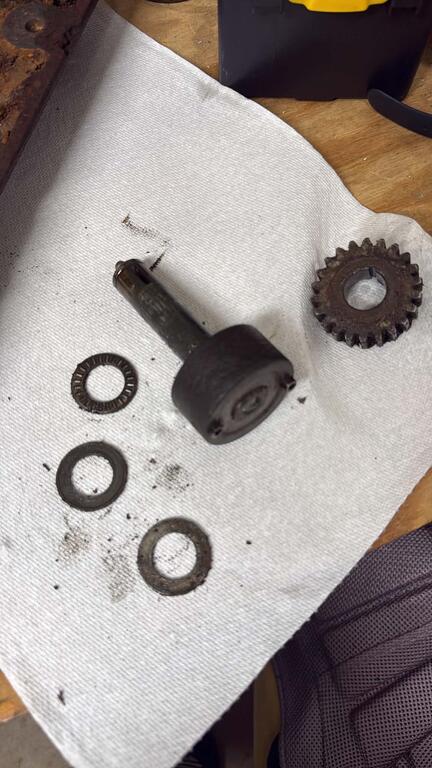

Syrmore 13 #1 Posted August 18 (edited) Been working on bringing an old Wheel Horse RM-367 mower deck back to life and figured I’d document the process. The deck had a lot of play in one of the spindle shafts, so I finally tore the spindle assemblies apart to see what was going on. Once I got everything opened up, I found the old needle bearings, thrust bearings/washers, gears, seals, and spindle shafts all showing their age. I also realized the spindle gears appear to be missing the Woodruff keys. Right now I’m planning on rebuilding both spindle assemblies while I have everything apart. My current parts list is: 4x 1508 / 252-6 needle bearings 2x 1303 / 100441 oil seals 2x 1534 thrust bearings 4x 1535 thrust washers 2x 937084 Woodruff keys (Local parts store click here link 2x 936125 / 32120-72 snap ring (Local parts store click here The deck itself is definitely rough and rusty underneath, but it seems solid enough to save. I’d rather rebuild the original setup than continue messing with a craftsman gt5000 that I have. Big thanks to our well known friend Bob, who has been helping me along the way with getting this Wheel Horse working again. It’s been a bit of a project, but I’m slowly learning how all of this old gear-driven mower deck hardware goes together. If anyone here has any tips on where to get these parts, let me know. I find myself getting lost in this forum due to how much authentic and knowledge there is compared to anywhere else. I will be uploading more pictures here shortly of the deck. Edited August 18 by Syrmore 2 Share this post Link to post Share on other sites

gwest_ca-(File Mod) 12,488 #4 Posted August 18 1194 key replaced by937084 Woodruff #5 (1/8"x5/8") at you local hardware store A 3/4" retaining ring is sized to fit a 3/4" shaft. The actual diameter is smaller and also available at you local hardware store. They have one rounded side and a sharp side because they are stamped. You want the sharp side installed in the correct direction to maximize the retaining effect. 1 1 Share this post Link to post Share on other sites

Syrmore 13 #7 Posted August 18 17 minutes ago, gwest_ca said: 1194 key replaced by937084 Woodruff #5 (1/8"x5/8") at you local hardware store A 3/4" retaining ring is sized to fit a 3/4" shaft. The actual diameter is smaller and also available at you local hardware store. They have one rounded side and a sharp side because they are stamped. You want the sharp side installed in the correct direction to maximize the retaining effect. I sure do enjoy finding out that not every wearable item is something needing to be specially ordered, just go down to your local parts store! In my case, tractor supply has those keys. Tractor Supply woodruff key I know I bought some snap ring pliers a few years back. So they must carry those too! Here is the link to retaining pins Hopefully this can further help somebody down the road too. Share this post Link to post Share on other sites

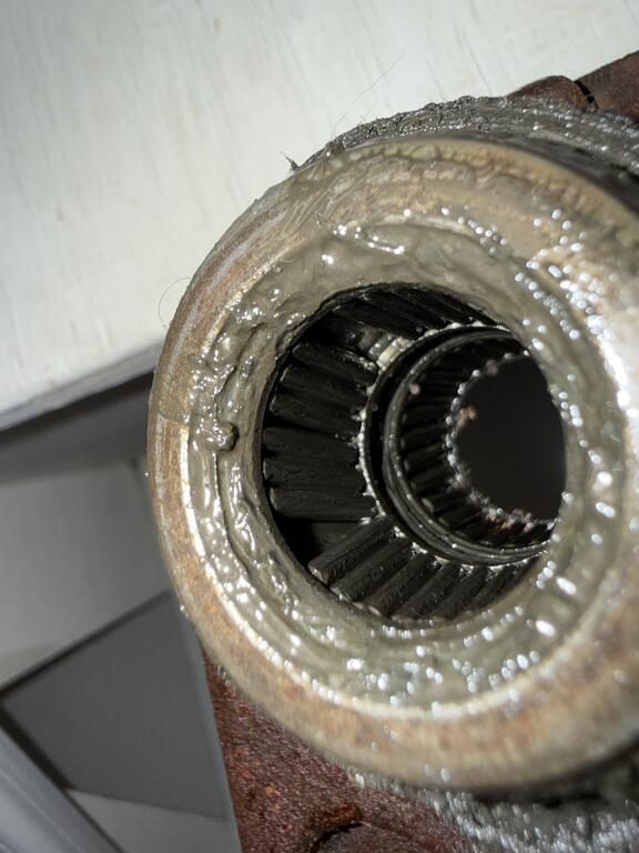

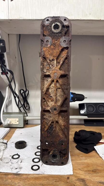

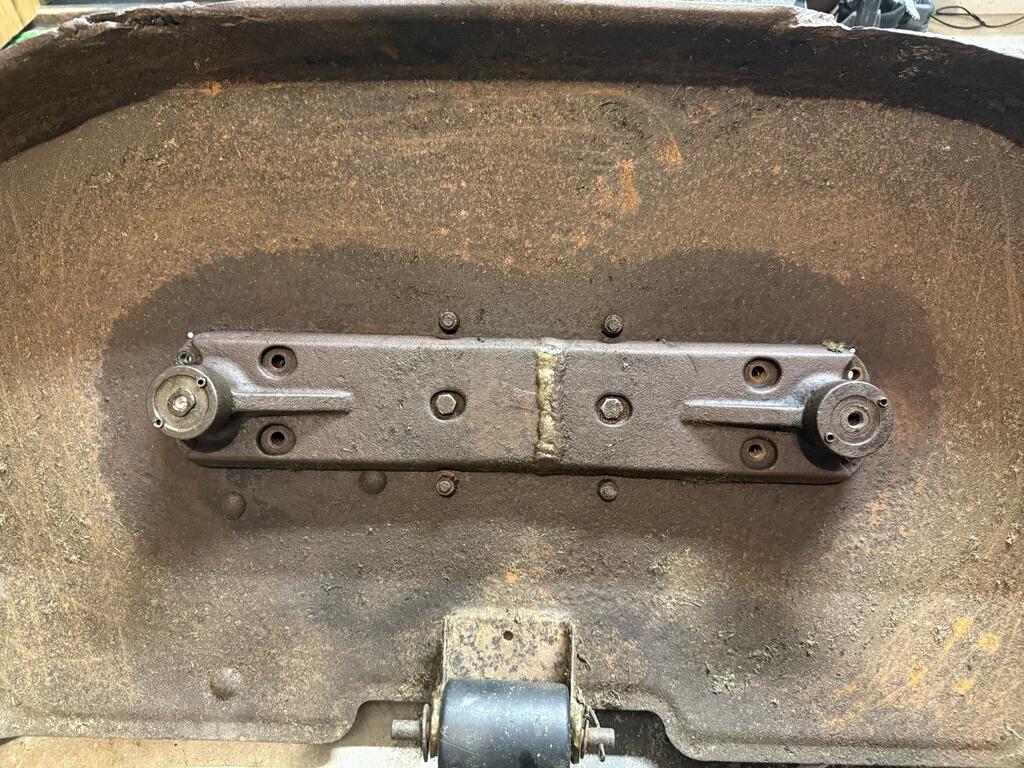

ri702bill 13,056 #8 Posted August 18 (edited) Welcome! The cracked & repaired cast iron bearing housing - the back mounting surface NEEDS to be flat... If not, the gear mesh will be off... The housing cracked, most likely, by someone mowing & hitting a stationary object. Bad things happen - you may also bend that spindle and that end of the cross shaft. Runout in either or both causes issues. Check those parts too... Installing the new caged needle bearings.... They NEED to be pressed in, not by impact whacking a socket that fits. Torrington recommends using a piloted stepped tool that has a negative 15 degree shoulder to contact the radius at the edge. Also note that the upper & lower are not installed flush - the lower is driven in about 3/16" beyond flush to make room for the seal. The gears - are reversable - the side gears can be swapped left to right, the shaft gears can be flipped over to give new surfaces - as long as someone prior did not already do it. Properly set up, the gear drive deck cuts well. Edited August 19 by ri702bill 1 1 Share this post Link to post Share on other sites
Handy Don 17,474 #9 Posted August 19 I concur with @ri702bill on all points and once dialed in, these decks do cut nicely. They are not “silent” like a perfectly tuned belt-driven deck but they are not loud either. I’ve not encountered anyone who welded the bearing holder (aka, the backbone) and got it perfectly aligned and dimensioned. At least two guys I’ve spoken with eventually got parts decks with unbroken ones to swap in. They can be had. With the right tool, the spindle bearings press in easily (as do the grease seals) but they will distort with even minor misalignment. That spindle looks good (it is hardened where it forms the inner race of the roller bearing). I ended up using shims on the cross-shaft (behind one face gear) to reduce gear lash while leaving about .02” of play for thermal expansion (yes, those gears and the cross shaft do get warm in operation). It took three assemble/disassemble/reassemble tries. Lavishly grease the gears (I now use 3x what I initially thought they should need)--yes, some will seep out around the gear covers--normal (didn't @squonk mention rags ) You are well ahead of the game in that you don’t have rust-through at the top front center of the shell. Typically, users: a) don’t clean the wet grass that accumulates underneath at that point, and b) adjust the lift too high so that the deck frame bangs against that part of the shell, denting it. You’ve been warned. From my notes: 1508 spindle bearing (4) ==> Koyo B-1212 needle bearings 1303 oil seal (2) ==> Timken 312518 seals Staked cross shaft 1515 bearing changes to the 101480 bearing which is a 1630 2RS Glad you are looking to put this back in action. 2 1 1 Share this post Link to post Share on other sites
ri702bill 13,056 #10 Posted August 19 Another point peculiar to these decks - the spindles must be properly timed, as the tips of the blades make an overlapping cut. Timing is done at assembly, set the hub shafts pins to be 90 degrees apart. Kind of like a WWI fighter plane's machine gun bullets shooting thru the area of the spinning propeller - they HAVE TO miss each other. 2 Share this post Link to post Share on other sites
