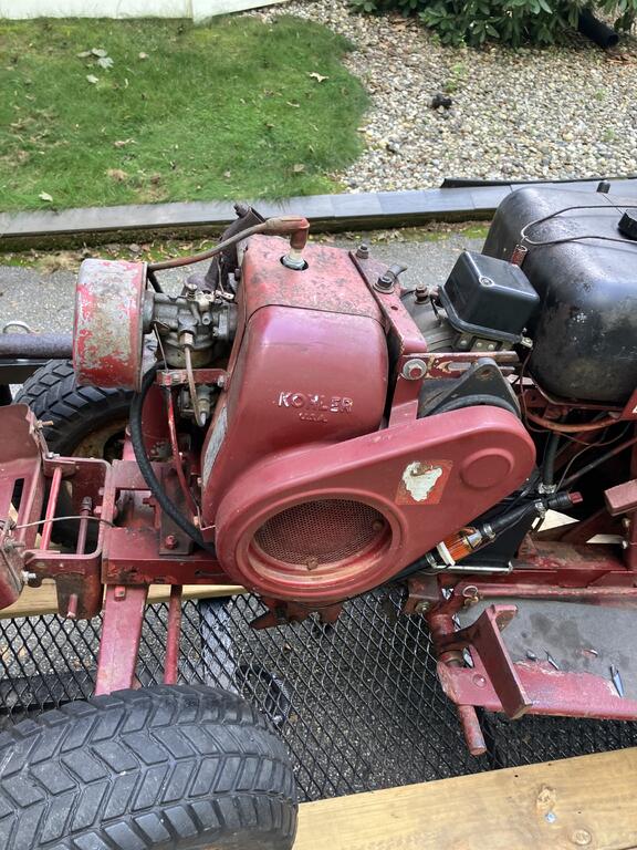

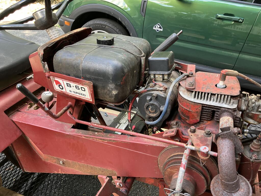

Retired Wrencher 7,042 #1 Posted August 15 (edited) I have this B 60 I picked up last weekend. I may have an original engine for it this week end? Will know buy the end of the weekend. It currently has a 8 hp start /gen motor in it now. It runs good. But it is in a tight space. But looking for options. I have seen people use Harbor freight engines in them. With good results I guess? Any other options? I have always like these little B-60’S. Cool and very functional. Reason I picked this up I am try to preserve the 856 I have.It is the best one I currently have. I am restoring an B-100 correctly. Any thoughts are welcome. Edited August 15 by Retired Wrencher 4 Share this post Link to post Share on other sites
ebinmaine 81,278 #2 Posted August 15 My own thoughts... keep it KOHLER powered. Adjust that one with a shorter belt maybe? Definitely insulate those S/G terminal ends from the gas tank spring. That's a serious problem. 3 Share this post Link to post Share on other sites
ebinmaine 81,278 #3 Posted August 15 You could also get the proper type 8 HP engine in there. Easy swap. Share this post Link to post Share on other sites

953 nut 70,648 #5 Posted August 15 I'm a firm believer in "If it ain't broke, don't fix it" The voltage regulator could be rotated a bit forward and like @ebinmaine suggested the terminals should be insulated. 1 Share this post Link to post Share on other sites

ebinmaine 81,278 #7 Posted August 15 1 minute ago, TonyToro Jr. said: B-60s came factory with a 7hp pull start Kohler not sure if the model. I should clarify "proper type". I mean get the S/G out and use a later model smaller starter. That said, I'd really rather see it left as is and insulated. 1 Share this post Link to post Share on other sites

sqrlgtr 4,224 #11 Posted August 15 Looks like a nicely done transplant besides the voltage regulator proximity to fuel tank spring. I would leave it the way it is if it where me unless I was needing the little 8 fer some other project and had the proper Kohler to slide back in its place. No way would I replace a Kohler with a horror freight motor, tecky maybe but not a Kohler. 2 Share this post Link to post Share on other sites
ebinmaine 81,278 #12 Posted August 15 12 minutes ago, sqrlgtr said: No way would I replace a Kohler with a horror freight motor, Agreed. 12 minutes ago, sqrlgtr said: tecky maybe but not a Kohler. I wouldn't even do that. If I needed to transplant a non Kohler engine, I would find another Kohler instead of using ANY of the "inexpensive imports." 1 Share this post Link to post Share on other sites
