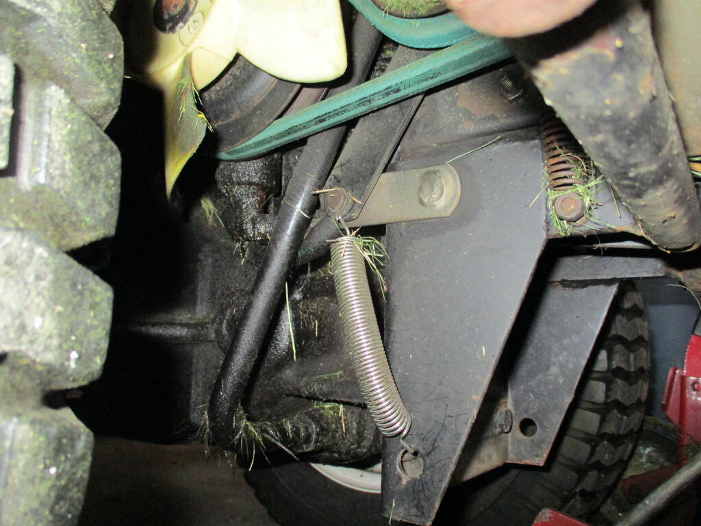

Picked up a GT-1848 last year for cheap at auction as she didn't run...Turns out those B&S engines actually require fuel mixture to run.  After going over the flue system she worked great.  The hydro engagement lever shook around and rattled a lot.  Part of problem was drive belt was missing a couple chunks...but even with a new belt lots more rattle and noise than my 418A. My older Sustrands also rattle and I have replaced the wave washers with not much improvement. (Use a small bungee cord on one to quiet it down)  So why is the 418 quiet but not the GT same system right???
Wrong...WH made a change in the later hydros and added an anti rattle spring instead of using wave washers.

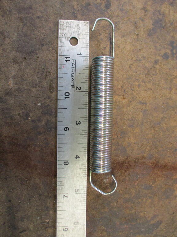

 Looked at the spring on my 418 and went to my box of springs found one that was actually for some WH snow blower that looked close.  Shortened and bent the end loops put it on the GT and voila quieter.  As the other Sunstrands come in for maintenance going to fix them up as well.

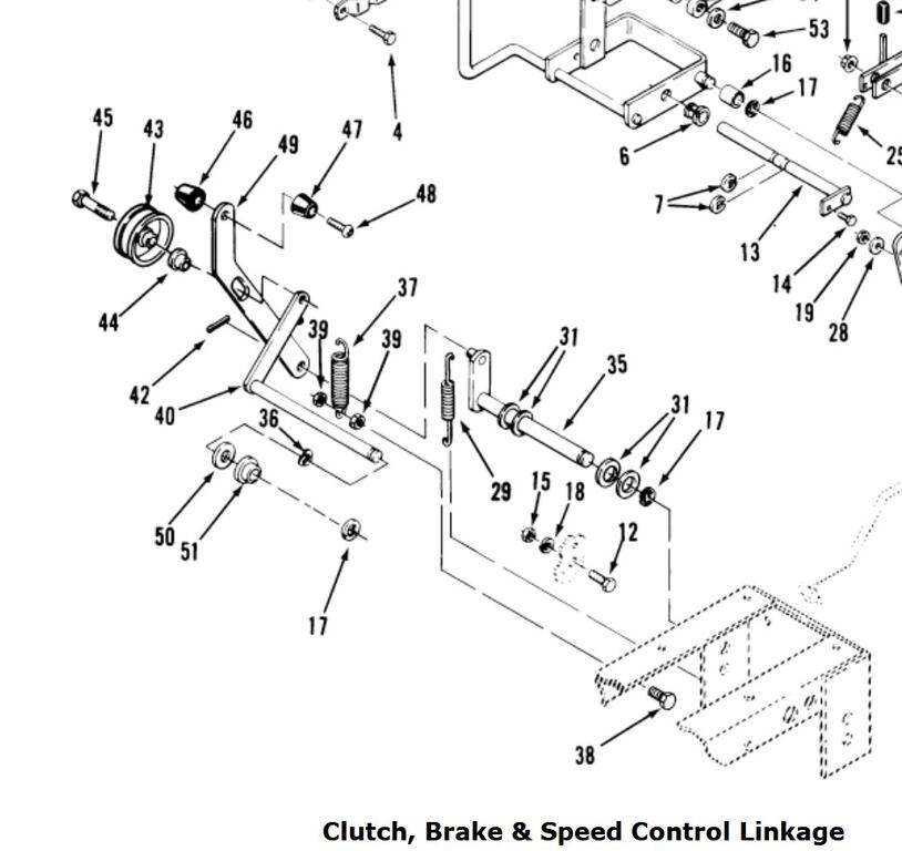

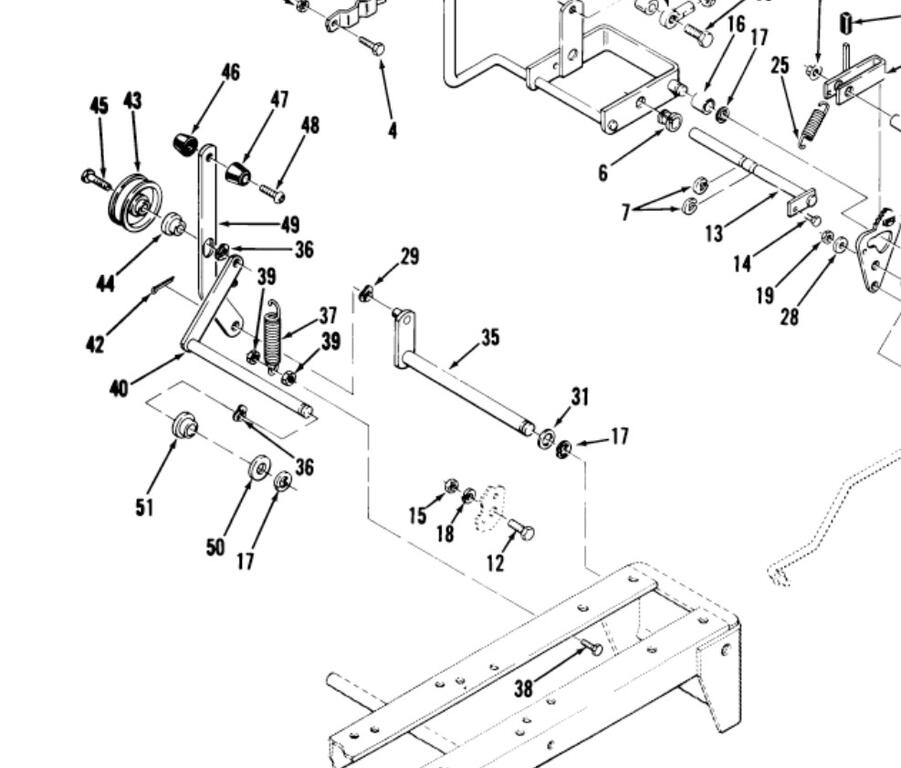

First diagram GT 2nd 418 note #29 WH part 107938

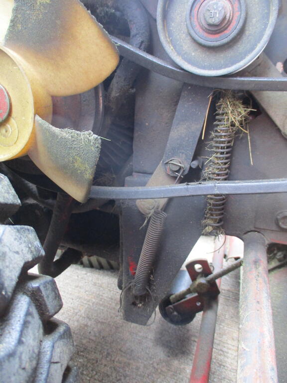

First pic 418   2nd GT
