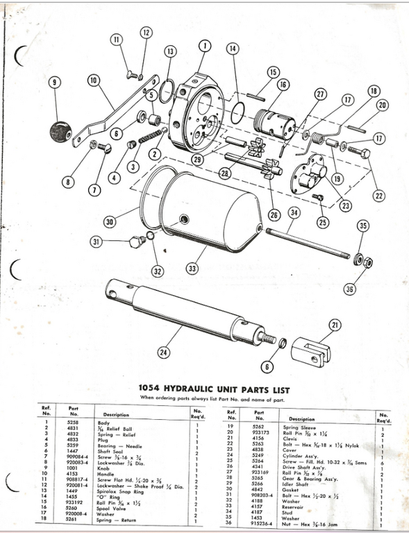

adsm08 5,247 #20 Posted August 13 (edited) If the spool valve is in the neutral position there should be no fluid flow from either hose. Now, since the fluid has already escaped, and the hoses are disconnected, you can GENTLY use compressed air into the ports to check the function of the lift ram. The other potential possibility here is that the pump is worn. It is very possible that the pump is able to produce flow, but not enough pressure to operate the lift. Remove plug #4 and inspect spring #3 and check ball #2. Those should be the components that provide the restriction that allows the pump to build pressure. I have taken apart a few of these and seen at least one of them with those items stuck. Edited August 13 by adsm08 1 Share this post Link to post Share on other sites

1054 Project 97 #23 Posted August 13 10 hours ago, adsm08 said: If the spool valve is in the neutral position there should be no fluid flow from either hose. Now, since the fluid has already escaped, and the hoses are disconnected, you can GENTLY use compressed air into the ports to check the function of the lift ram. The other potential possibility here is that the pump is worn. It is very possible that the pump is able to produce flow, but not enough pressure to operate the lift. Remove plug #4 and inspect spring #3 and check ball #2. Those should be the components that provide the restriction that allows the pump to build pressure. I have taken apart a few of these and seen at least one of them with those items stuck. I'll be out of town next week but will troubleshoot the relief valve when I return. Share this post Link to post Share on other sites

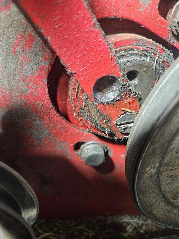

1054 Project 97 #24 Posted September 1 I found the issue! There are 2 screws that attach the lift handle to the pump (spool valve). One of the screws was gone so moving the handle was not moving the spool. Thanks to all that responded to this post! I now have another pump related question but will start a new thread for that. 1 Share this post Link to post Share on other sites
