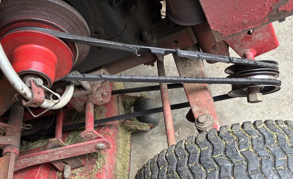

Whee Horse 102742 belts wearing poorly. Advice on better made ones.
rustyedge1
Belt in photo is K Force brand A 102742 which is what my local parts place is pushing at 30 bucks plus.
This one was bought two seasons ago counting this mowing season and it’s not going to make it looks like..
Any info on better made belts appreciated..IMG_0328.jpeg.3c073cc52ba0f4bcb033ae50844e9002.jpeg
gwest_ca
You could try a Gates or Napa 6378 made to replace the original 102742

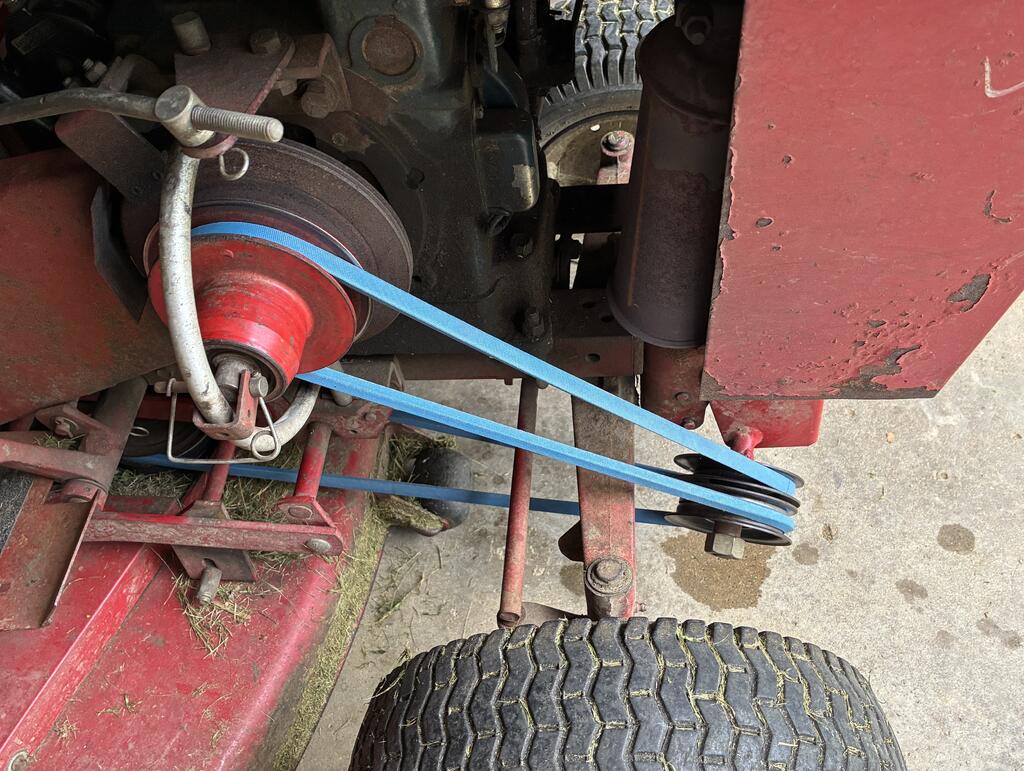

Ed Kennell
TSC Aramid blue belts are my go to.
Image showing Huskee Huskee 0.5 in. x 105 in. Blue Aramid V-Belt

peter lena
@rustyedge1 bet ya dollars to donuts , its  lubrication  failure related , from that pto cone inner needle bearing , to every  related belt / pulley set up , pulleys are probably  rough , noisy , COMBINED  INCREMENTAL  LUBRICATION FAILURE  , CREATES  BELT BOUNCE / WHINE, STOPAGE ,  would also not  be surprised if the pto lever start  area is also hanging up , increasing initial function  drag . what does it sound like ?   buzzing , vibratition  , you need  more than belts , pete
