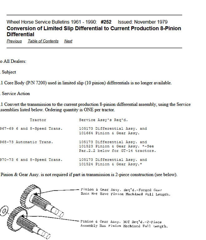

kb65 14 #43 Posted September 1 here is where i am at. I took the 73 12 hp 8 speed apart it had a lot of good parts that i could use. when i took apart the 8 speed transaxle it did have a 10 pinion differantial. I ordered a left gear case on ebay and it has arrived. the 8 speed also had a couple of good ball bearings that i can use. As soon as i can get caught up on other projects i can work on getting this transaxle back together and hopefully get it back on the 1276 this fall between grass and snow. 1 Share this post Link to post Share on other sites
Handy Don 17,370 #44 Posted September 1 12 hours ago, kb65 said: it did have a 10 pinion differential That is the Limited Slip Differential. Good possibility this is a “6-speed”. 1 Share this post Link to post Share on other sites
kb65 14 #45 Posted September 1 the 1973 12 hp 8 speed model 10350 8 serial 904251 I had in the shed had a 10 pinion. 1 Share this post Link to post Share on other sites
953 nut 68,747 #46 Posted September 1 8 hours ago, Handy Don said: That is the Limited Slip Differential. Good possibility this is a “6-speed”. Probably, or someone got in there and swapped out the old one for a 10 pinion, they are very interchangeable. Share this post Link to post Share on other sites
