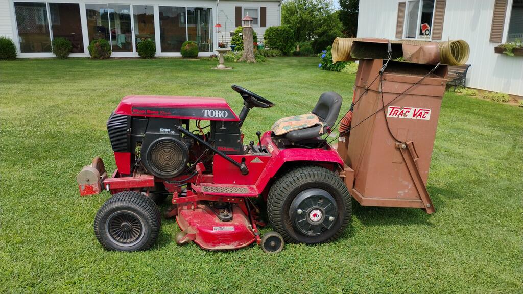

Ed Kennell 47,942 #1 Posted July 24 (edited) I have a Trac Vac that I bought from @c-series don a few shows back. I only use it when the grass needs collected. I usually use my foot controlled hydros for mowing, actually for everything. This 310-8 is my only gear drive. . With the warm spring and summer it got very little use this year. I decided to give it some exercise today. Put my ear muffs on and started the 5 horse Briggs on the Trac Vac and the 10 horse Kohler. Two engines, a deck, and blower make a lot of noise. When I backed out of the barn I noticed the right front was low so I pulled over to the compressor, set the brake and pumped up the tire. Back in the seat, engaged and lowered the deck put in 2nd gear full throttle and started to mow. She went about 10 feet, slowed down and the engine stopped. It did this about 4 times. The fifth time it went about 20 feet when I saw smoke rolling out from under the tractor. I disengaged the PTO and shut the engine off. also noticed the blades were still spinning down as normal. Any guesses what the problem was? Edited July 24 by Ed Kennell Share this post Link to post Share on other sites

Sparky-(Admin) 26,890 #3 Posted July 24 Parking brake still locked on? 2 Share this post Link to post Share on other sites
Ed Kennell 47,942 #4 Posted July 24 1 hour ago, Sparky said: Parking brake still locked on? 1 5 Share this post Link to post Share on other sites

Ed Kennell 47,942 #10 Posted July 24 The problem was the noise from the Trac Vac is so loud i could not hear the engine bog down. When it kept slowing down and stopping I thought it was running out of fuel. Guess I cleaned all the grease off the brake lining. 32 minutes ago, Handy Don said: We drivers of hydros and brake/clutch combo pedals would never figure this out! Yeah, I should probably move this gear drive down the road before I total it. I've had some near misses when I push the left pedal to stop and it just goes faster. 4 Share this post Link to post Share on other sites
