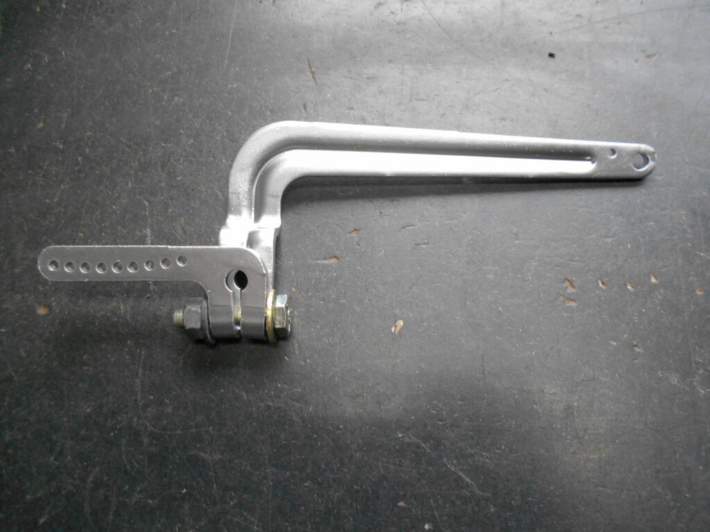

cleat
Governor lever bead blasted and painted.
I used chrome paint as that is what I had on hand.
Hopefully it will look OK.
New bolt and flat washer with the OEM nut.

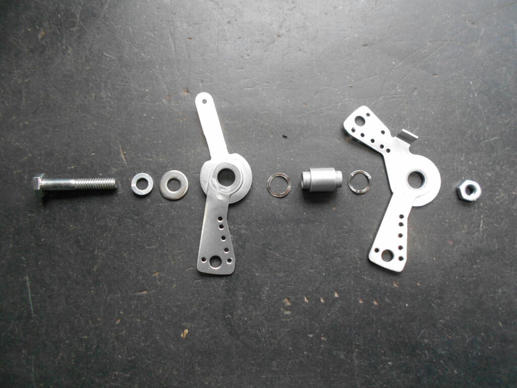

Choke and throttle lever assembly ready to go together.
These were painted with the same chrome paint after bead blasting.
791543182_Chokeandthrottleleverassemblyreadytogotogether.JPG.13d7f0705f4c611264b74d43e8050bc3.JPG

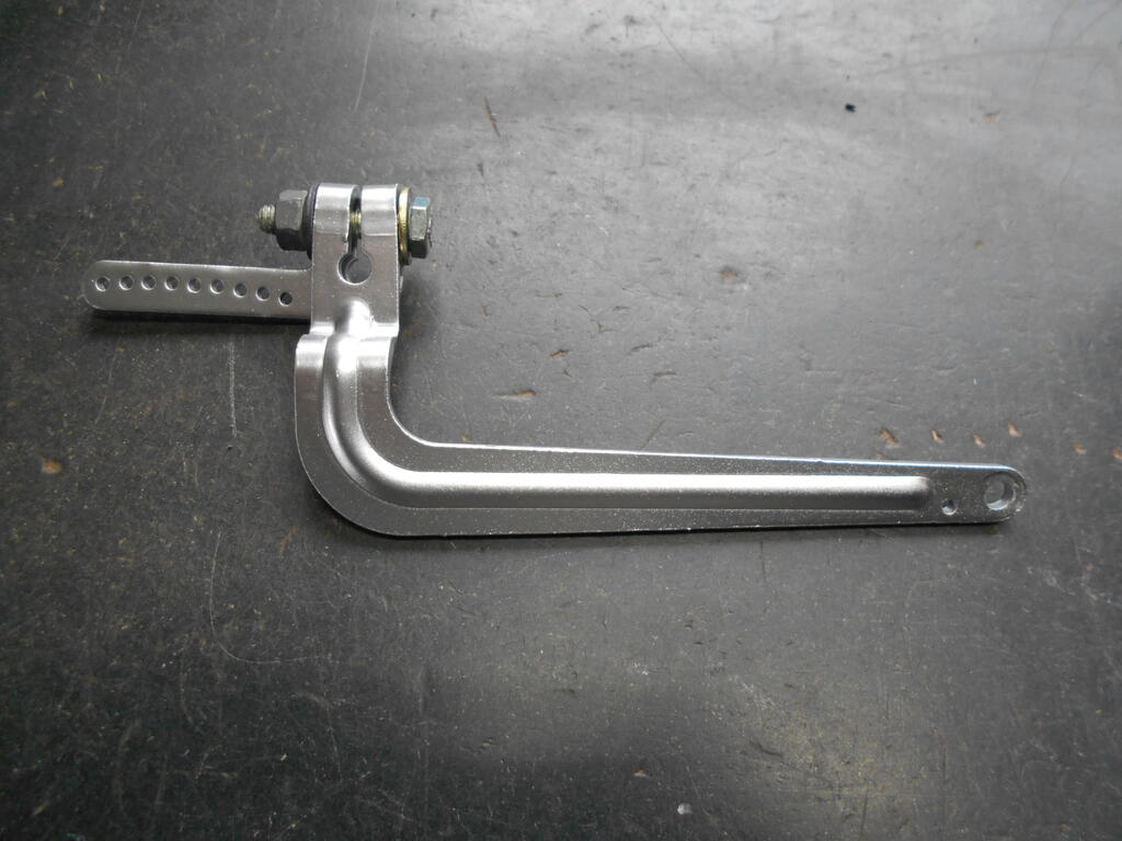

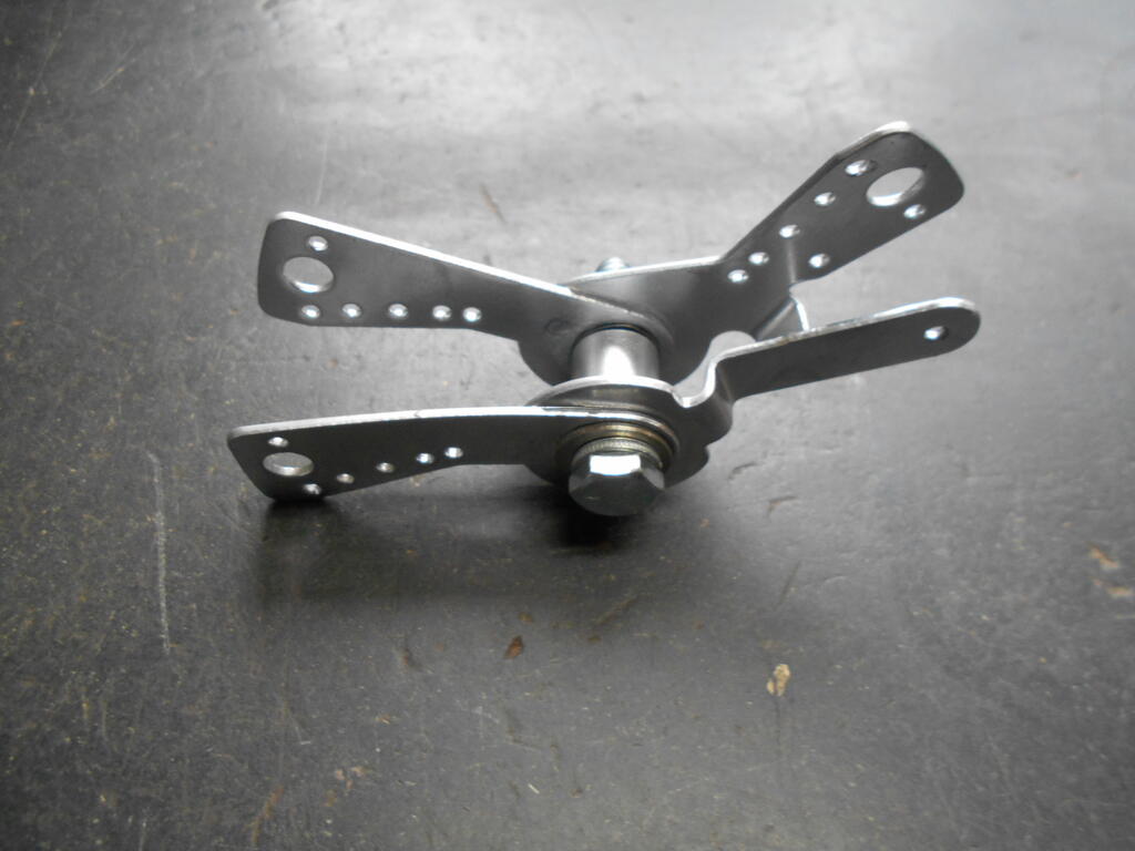

Choke and throttle lever assembled.
New bolt, lockwasher, and flat washer.
All other parts OEM
I did use a new flat washer under the nut as well even though there was not one there and the parts manual does not show it.

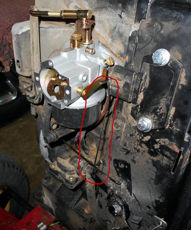

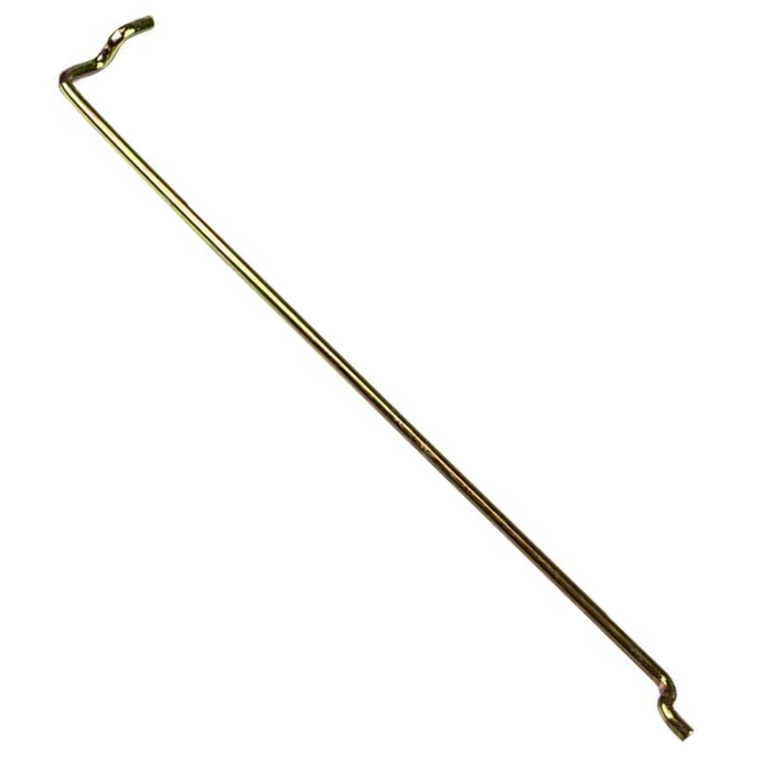

Maybe someone can help me out.
I am missing this linkage rod that goes from the choke lever on the carb to the choke lever.
I made one that works but an original would be nice.
I can order one but the shipping the vendors are charging is crazy.

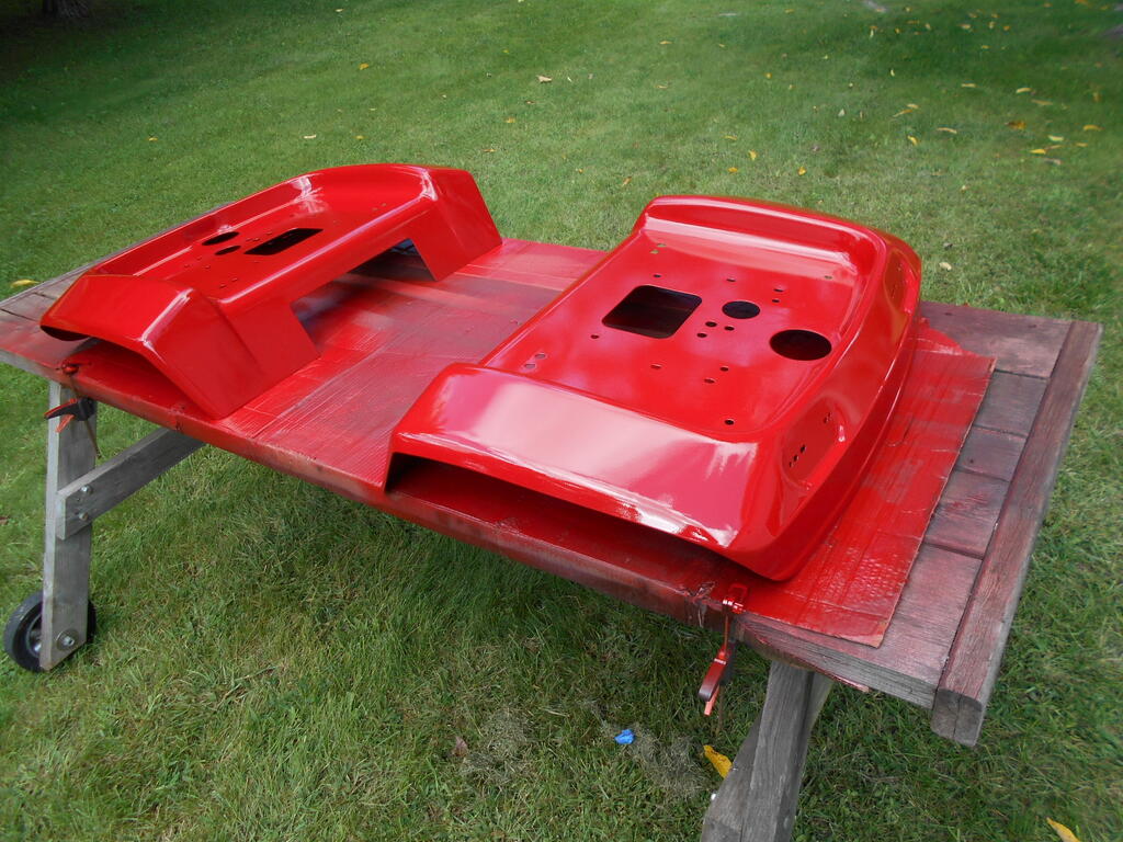

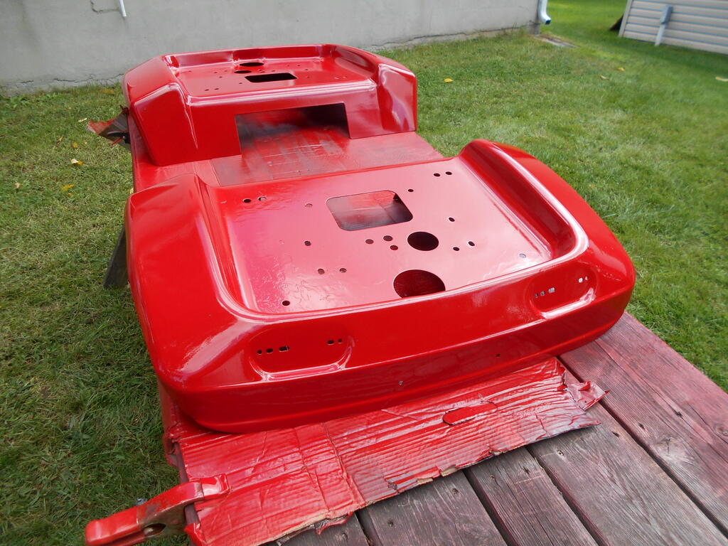

cleat

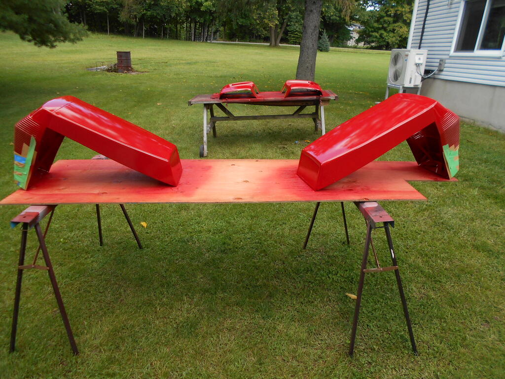

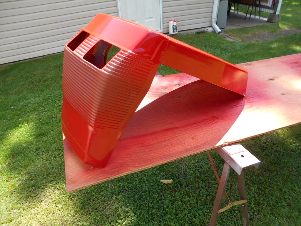

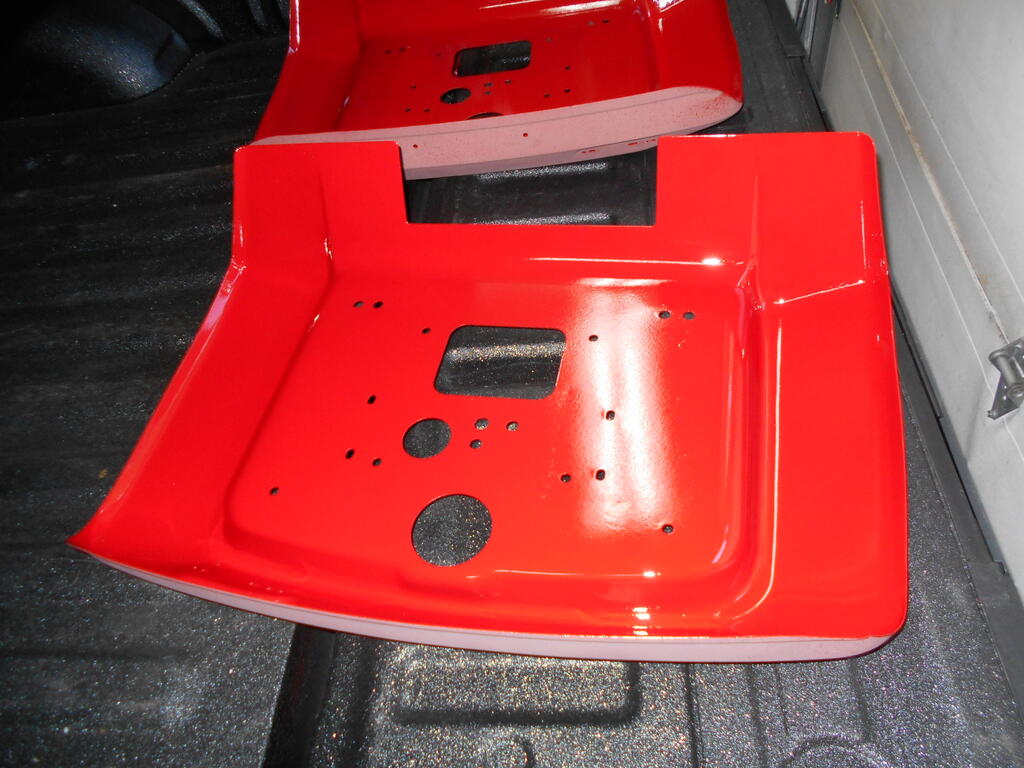

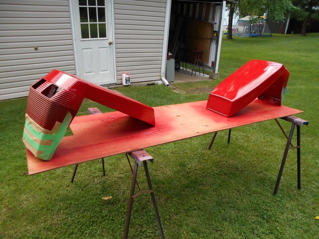

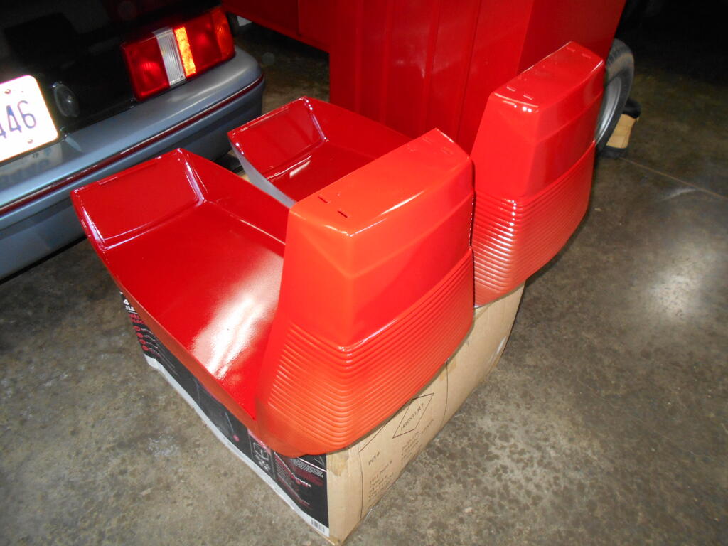

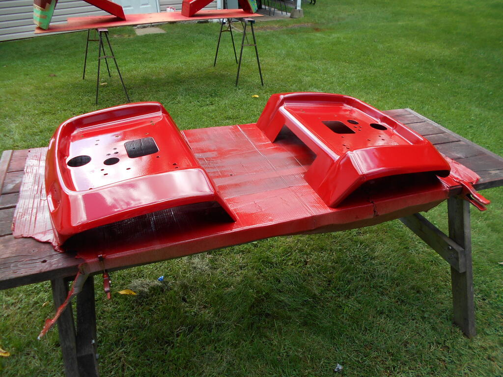

Well, it is sunny today.
Supposed to rain tonight but I took that as a good day to apply some paint.
Top side of two hoods and two fenders got some red paint.
  • Like 7
  • Excellent 1

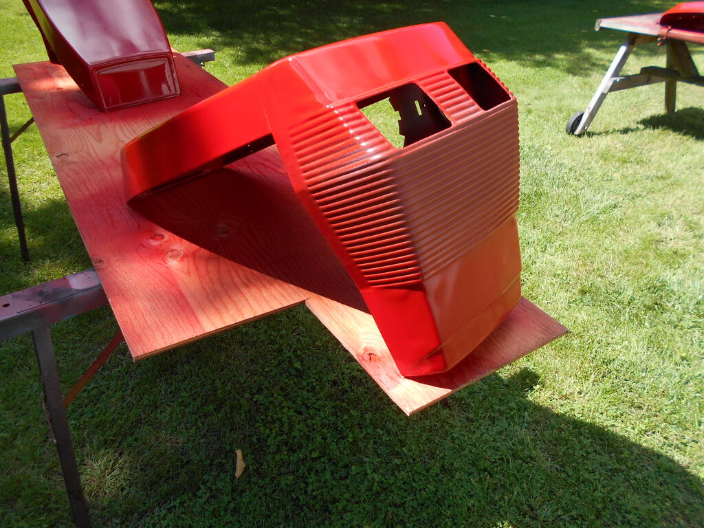

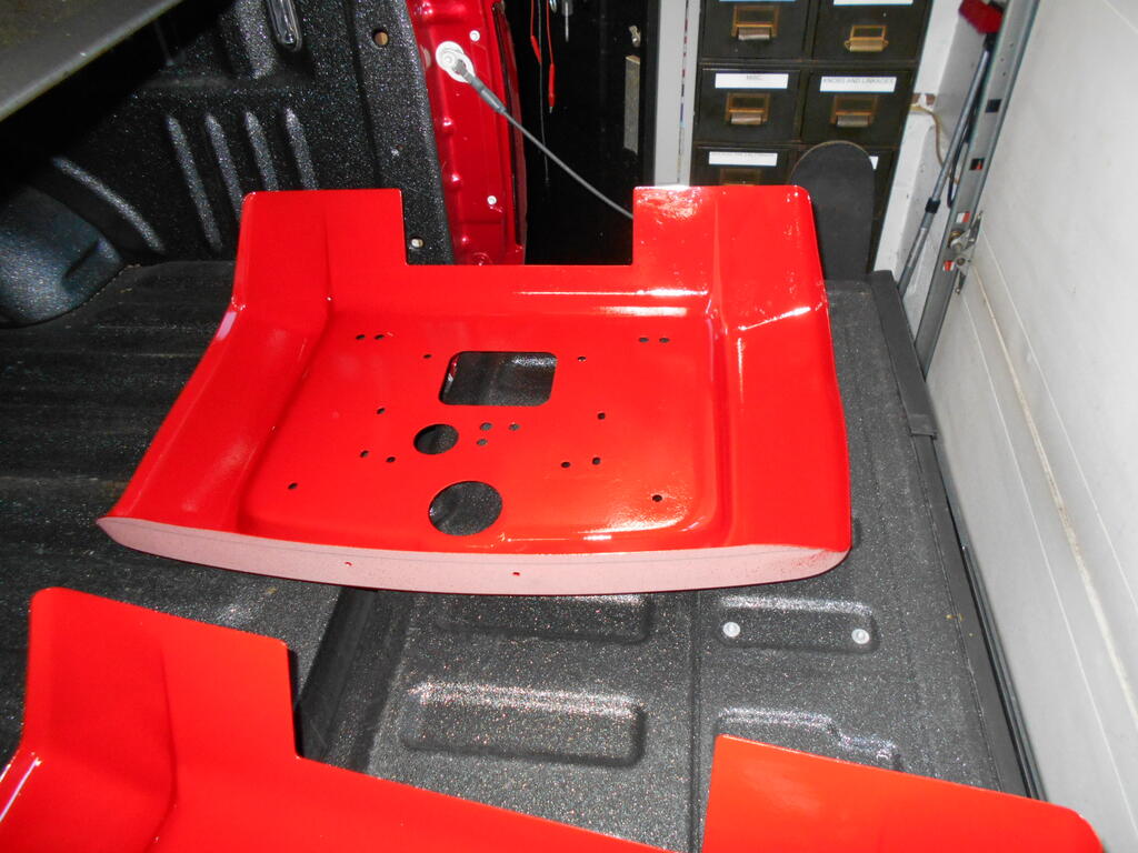

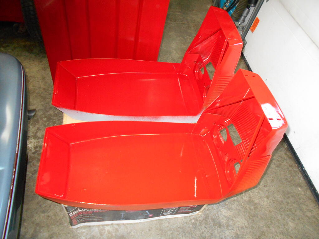

cleat
Masking removed from bottom of hood.
Red is now complete.
There are some dust and bugs in the paint but I will clean that up later.
  • Like 2
  • Excellent 3

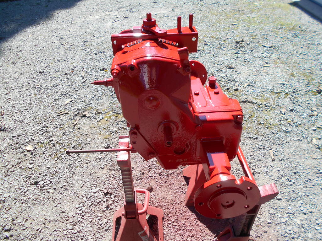

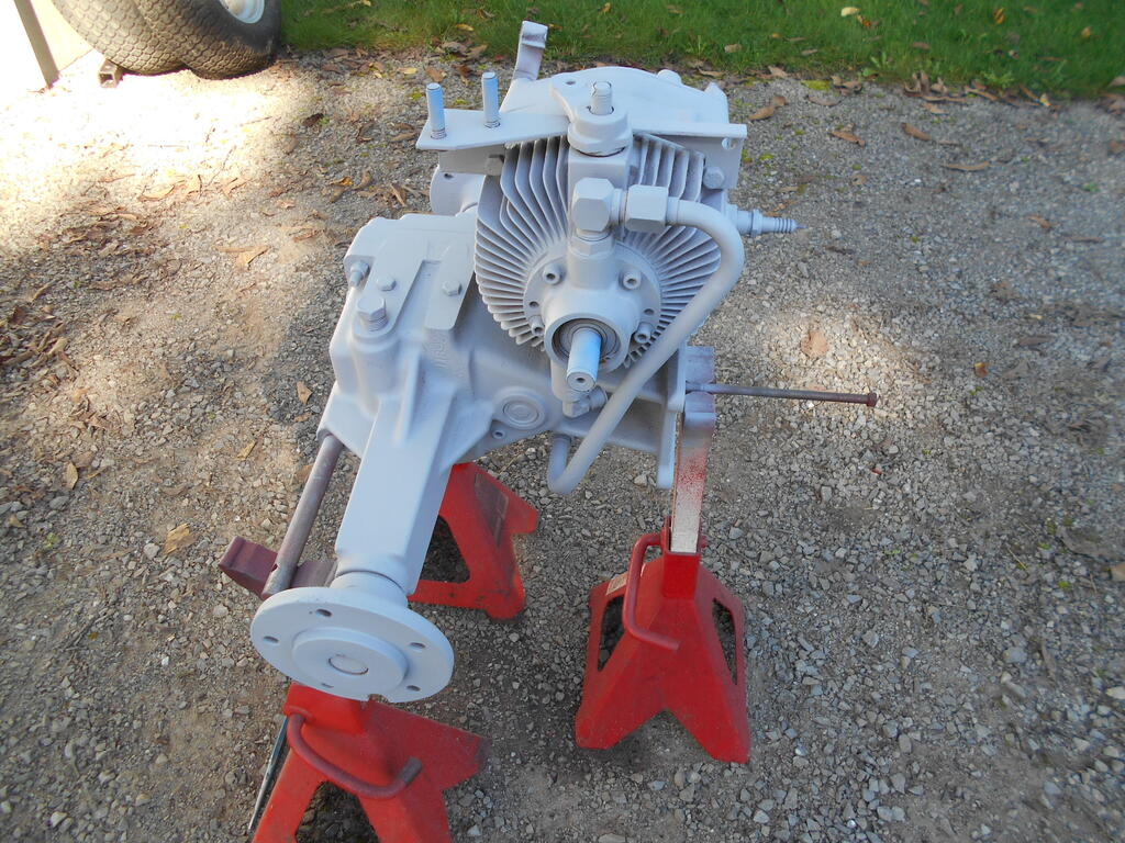

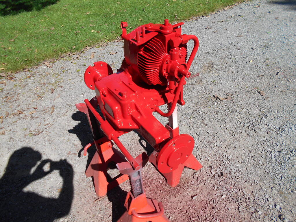

cleat

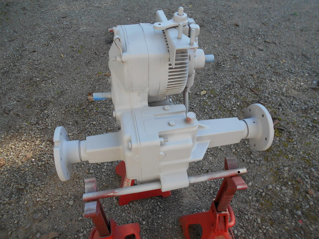

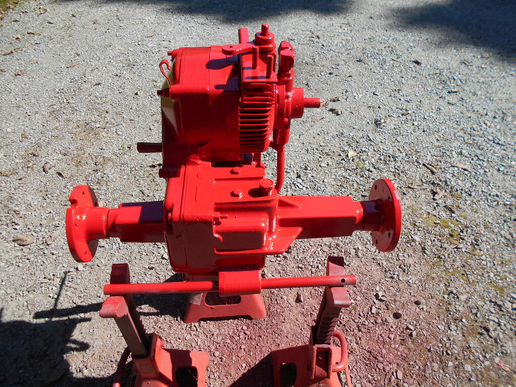

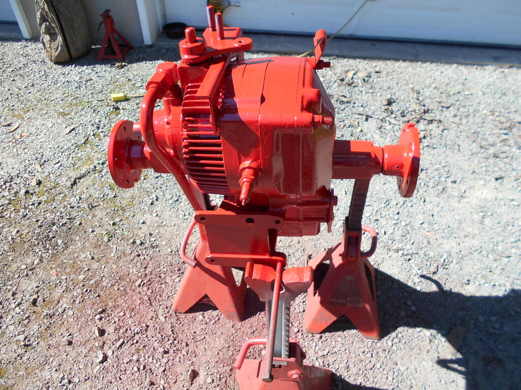

Got the rear end out and propped up on stands.
It then got the final cleanup, wire wheeling, and sanding complete.
A coat of primer was applied.
I would have preferred red primer but I ran out of that so the grey will have to do.
A couple of coats of IH red was applied.
1043186761_Rearendpainted1.JPG.095dba5761597405bfc44a5942797454.JPG1606597721_Rearendpainted2.JPG.9ffd44064ed0a2a15a992b2cb71ab246.JPG1231498919_Rearendpainted3.JPG.07b3f1bf59db5e7461a5f16fafcddc38.JPG2139472341_Rearendpainted4.JPG.c6b2451811f408c1d3e831fc97b3fbb7.JPG
  • Like 6
  • Excellent 1
Handy Don
Ya run what ya brung, right? Gray works.
I’m loving the spark plug! 🤣
  • Like 1
  • Haha 1
cleat
Yea, it looks stupid but it keeps the paint out of the hydraulic return.
:ph34r:
  • Like 1
  • Excellent 1

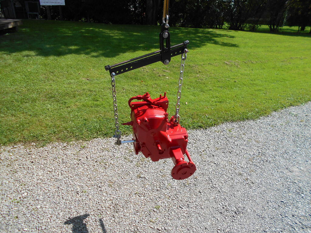

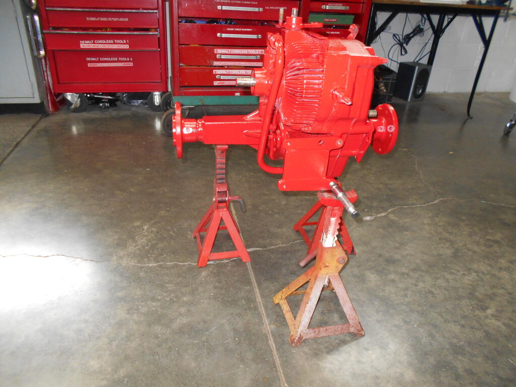

cleat

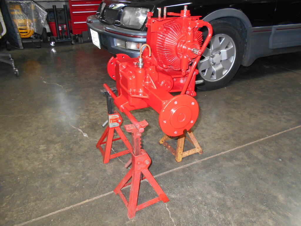

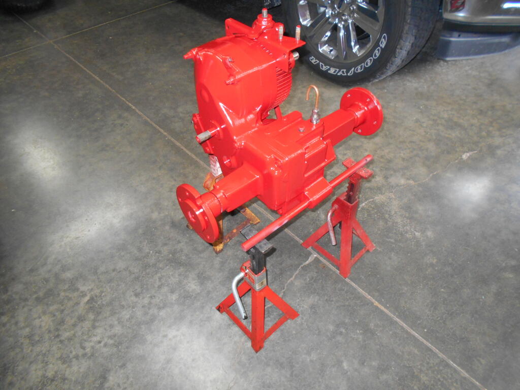

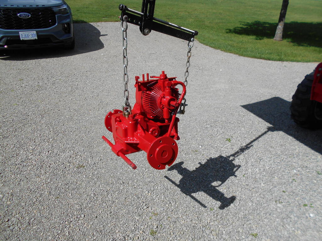

Rear end rigged to lift without damaging the fresh paint.
I use an engine leveler to tweak the rigging so it sits level.
Rear end is now sitting on stands in shop awaiting the assembly that will happen this coming winter.
It is level in all ways to help with the assembly.
666105591_Rearendsupportedandlevelledinshop1.JPG.e707609a2b7255a6cbcbf203caccae46.JPG
1526113828_Rearendsupportedandlevelledinshop2.JPG.32e9c7d28b9cea8ac92ff79c1fe23fed.JPG
1534083640_Rearendsupportedandlevelledinshop3.JPG.9e25a7e1e4ff239201b093b9ef91cda5.JPG
  • Like 2
  • Excellent 3

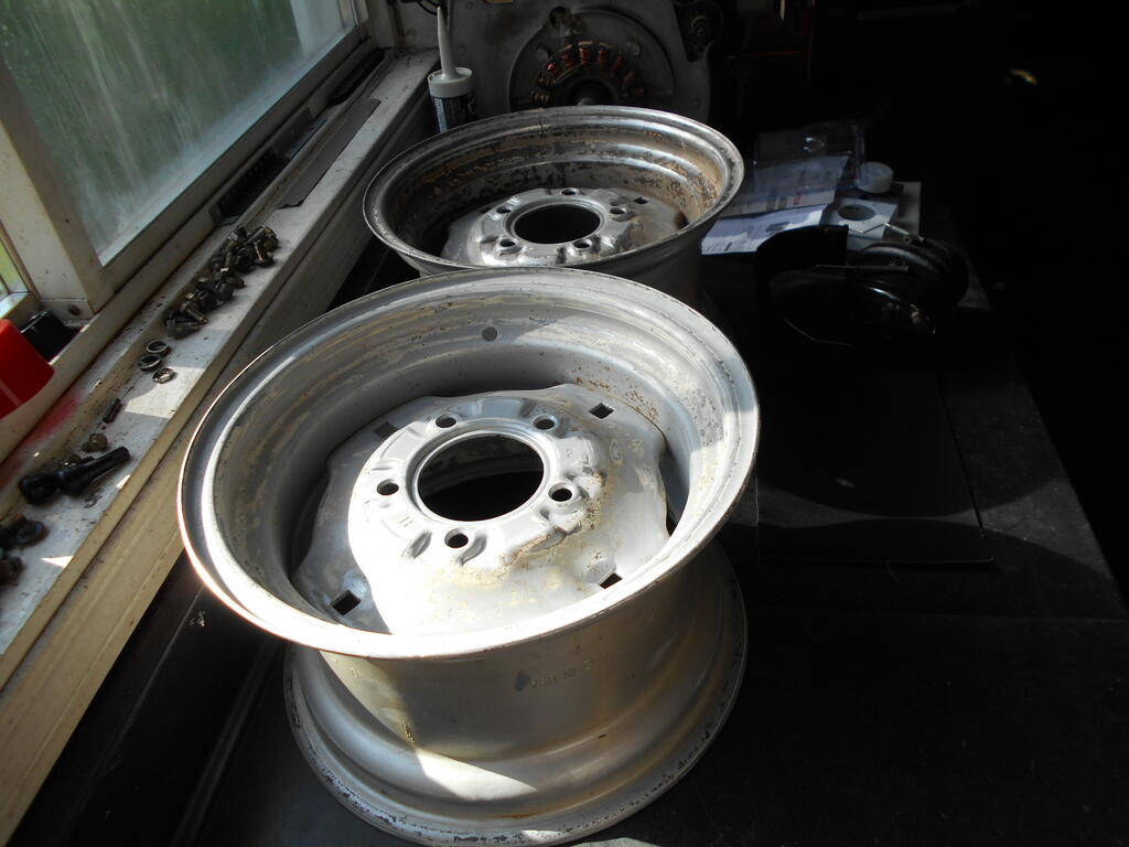

cleat

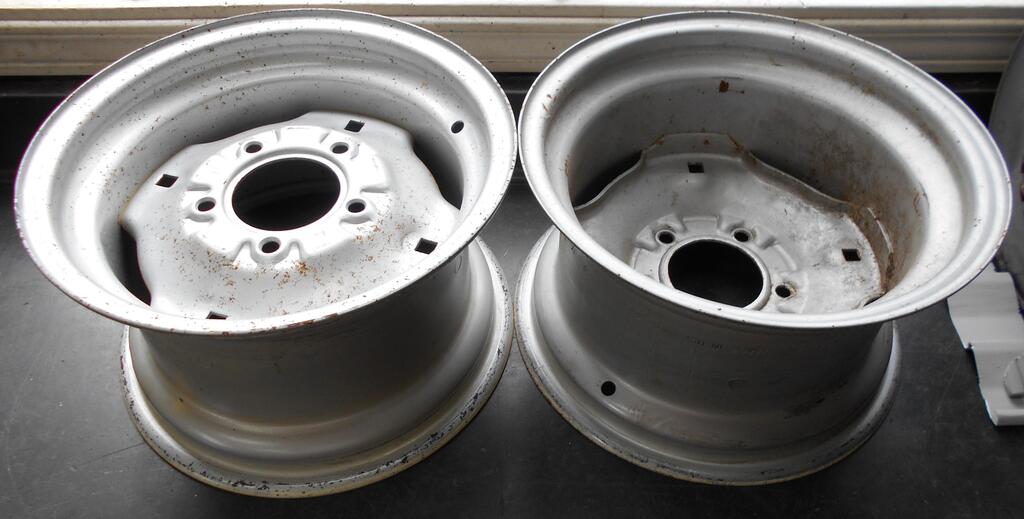

Old rotten tires removed from rear wheels.
Inside part of wheel where the tires mount are in absolutely perfect condition.
Don't even need to clean up or paint this area on them.
These will seal up nicely with no need for tubes (good thing as 12" tubes are costly).
  • Like 3

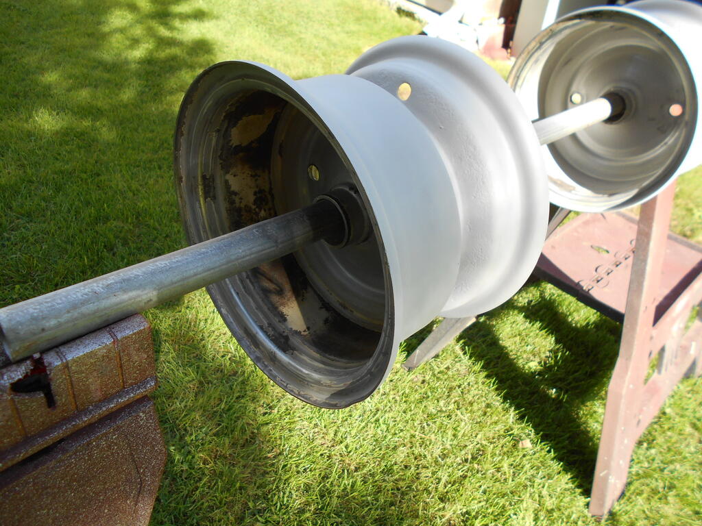

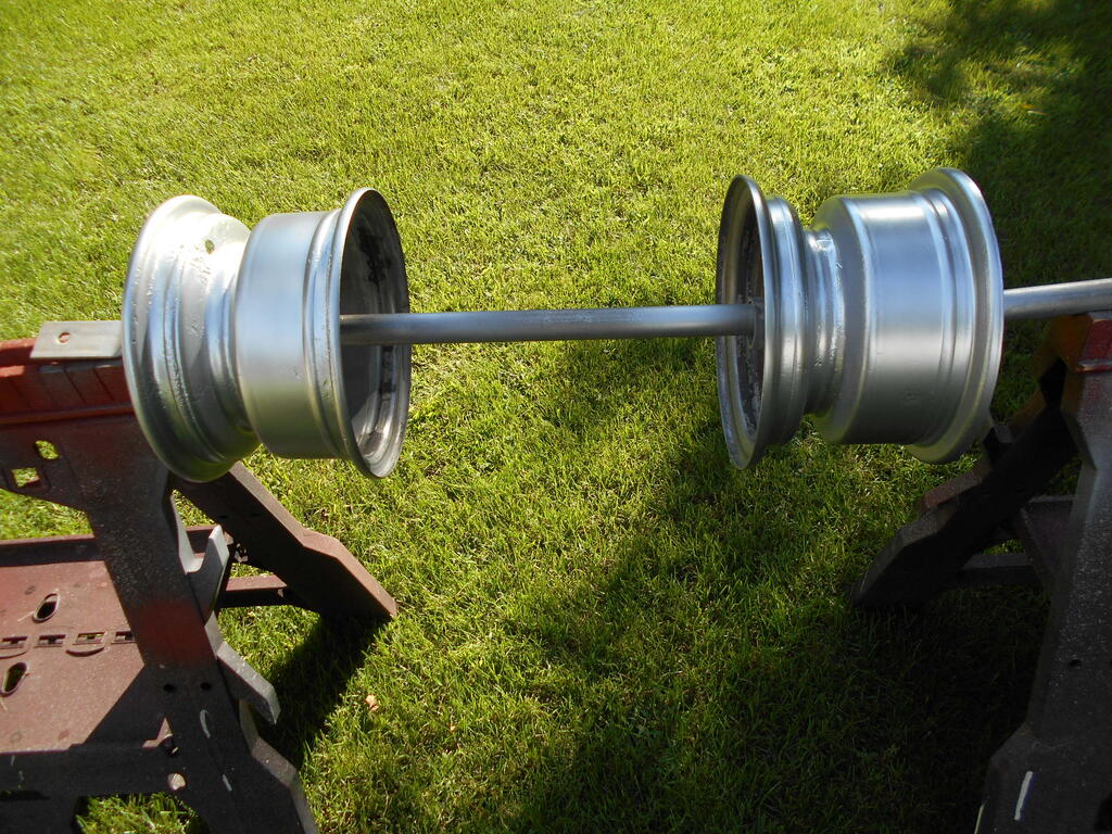

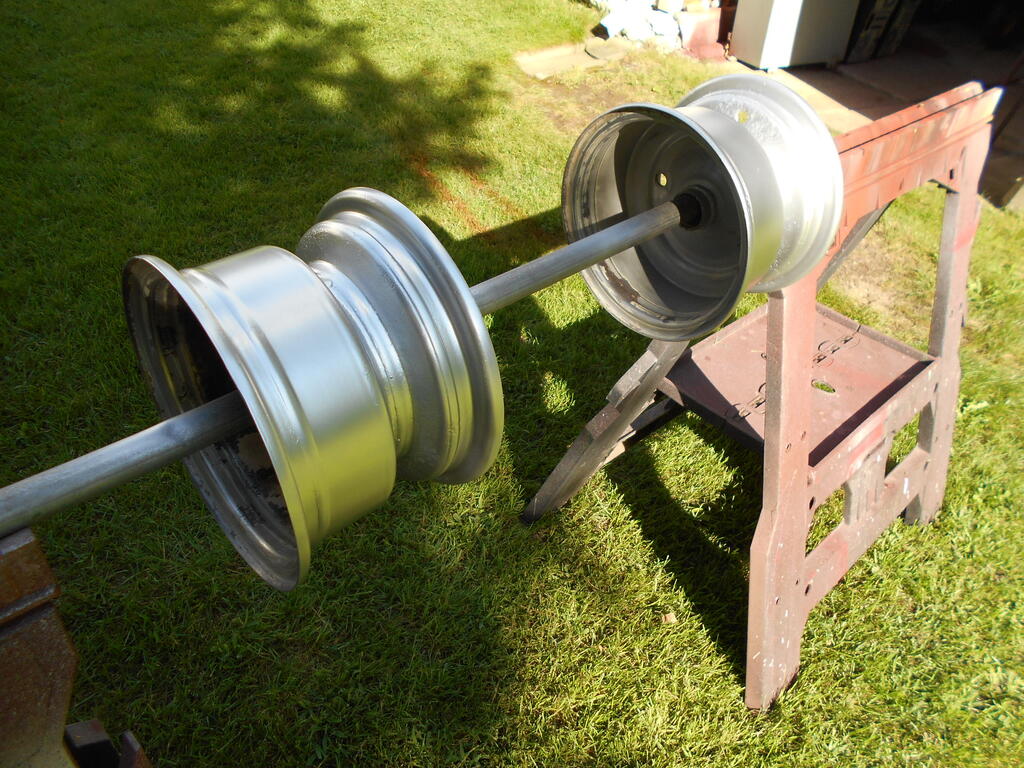

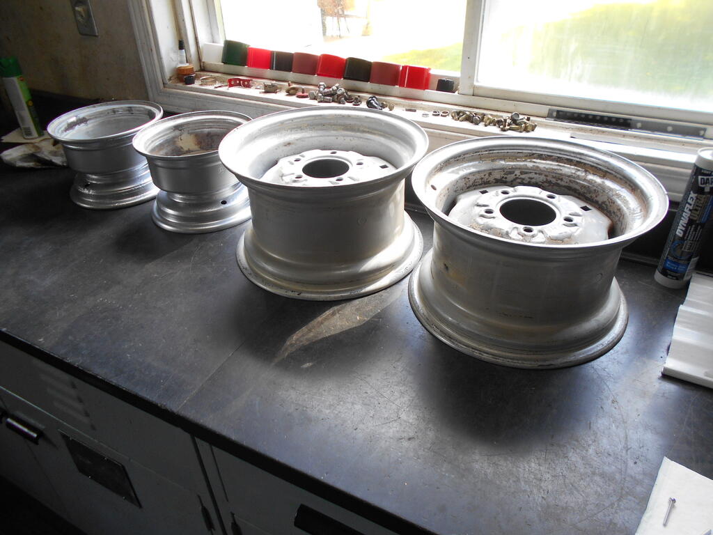

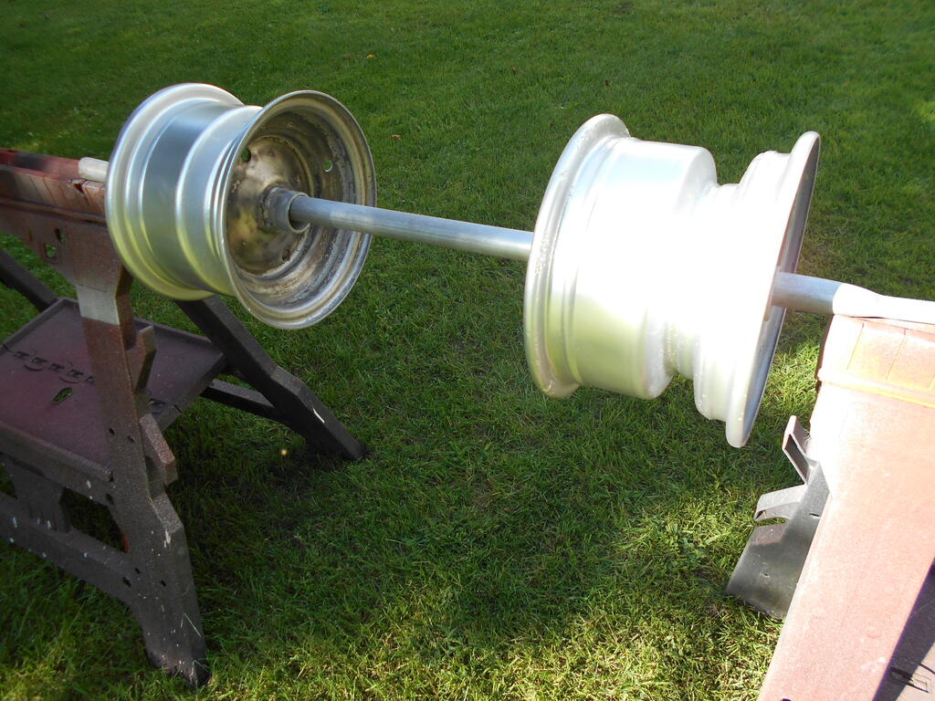

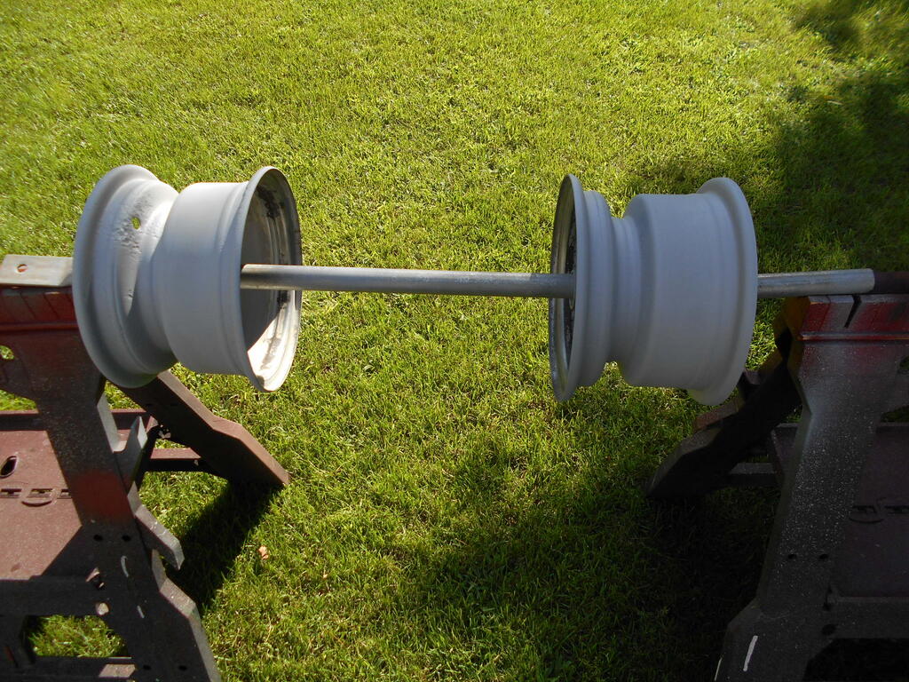

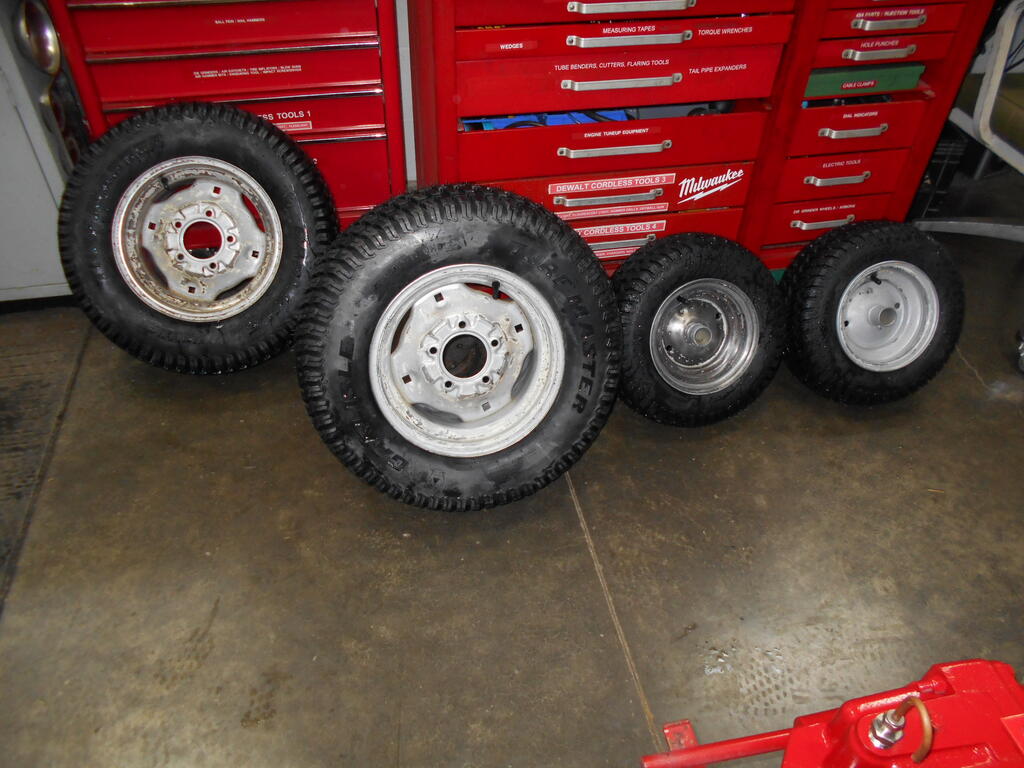

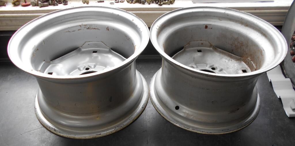

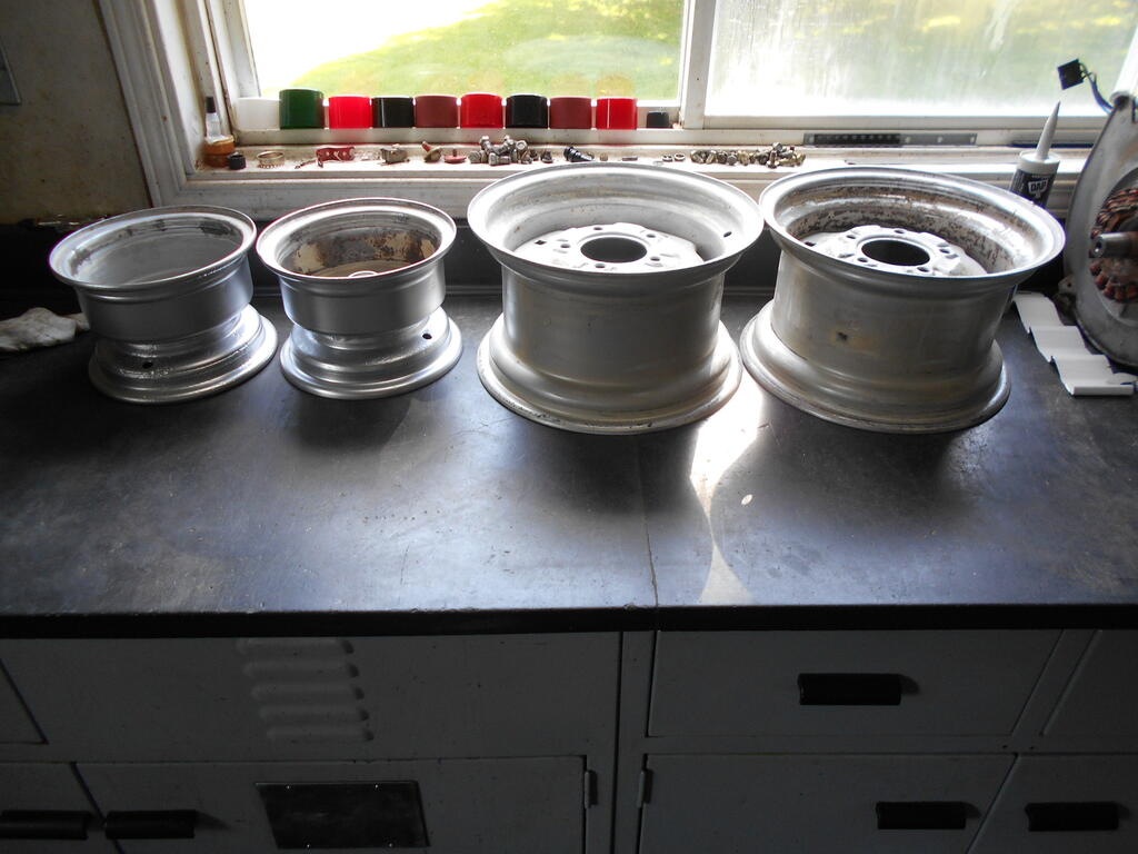

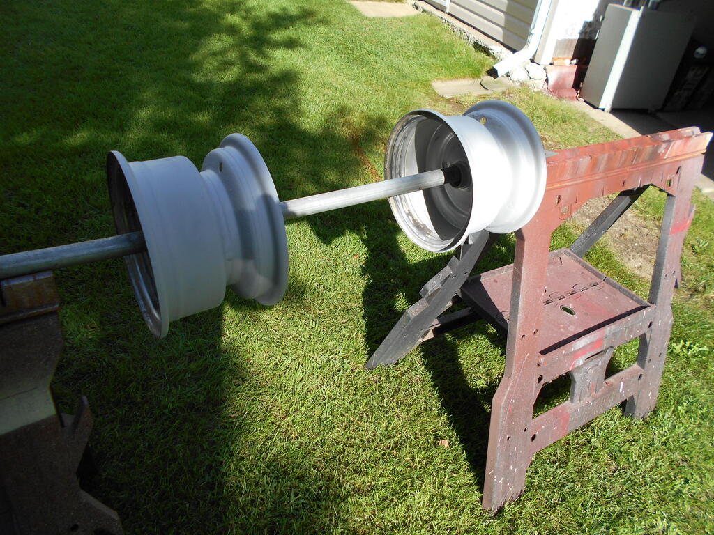

Rear wheels have been wire brushed and sanded.
Prime and paint will happen after the tires are mounted.
Front wheels have been wire wheeled, sanded, and primed on the tire side as they are very rusty in spots.
These will get tubes for sure.
827263305_Frontwheelswirewheeledsandedandprimed1.JPG.89472faddc6a0a9f166b9fe2741cd6ef.JPG
1329862508_Frontwheelswirewheeledsandedandprimed2.JPG.2ca28a43bfeccf3dbc109c5416acfb3e.JPG
804954714_Frontwheelswirewheeledsandedandprimed3.JPG.4386afb8550040f6d95c7678a0afe396.JPG

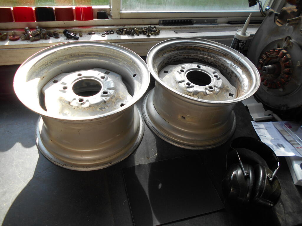

Front wheels have been painted on the tire side.
All four wheels now ready for the tires to be installed.
2009822128_Allfourwheelsreadyfortirestobeinstalled1.JPG.5cb57f062f9db84a02fee395051c6c13.JPG
320018048_Allfourwheelsreadyfortirestobeinstalled2.JPG.59f63769570dd72985bbc9832a9d741a.JPG
  • Like 3
  • Excellent 3

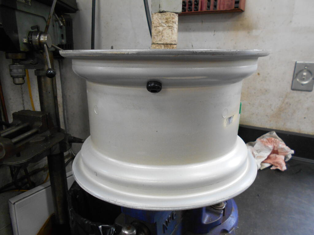

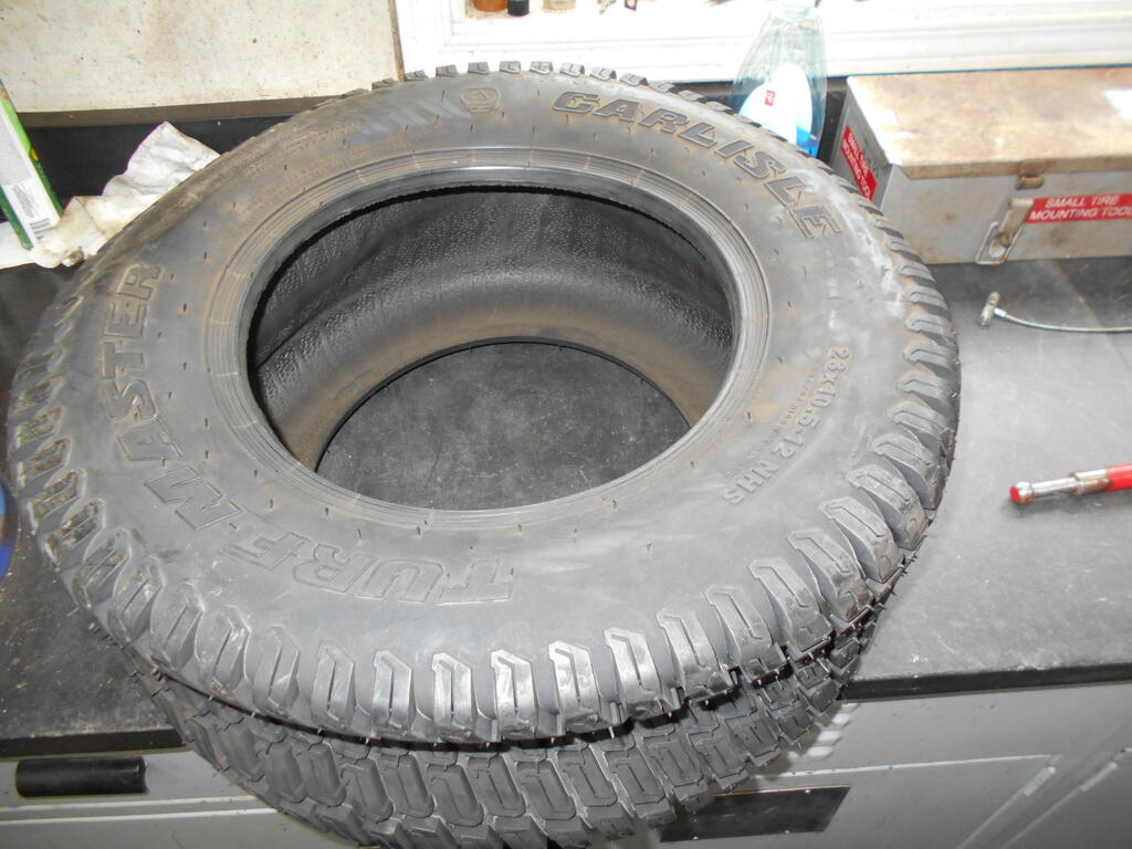

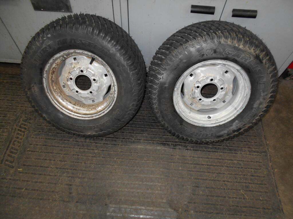

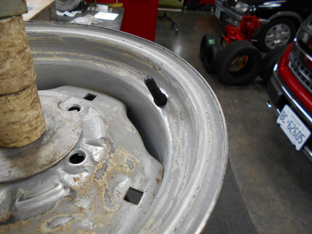

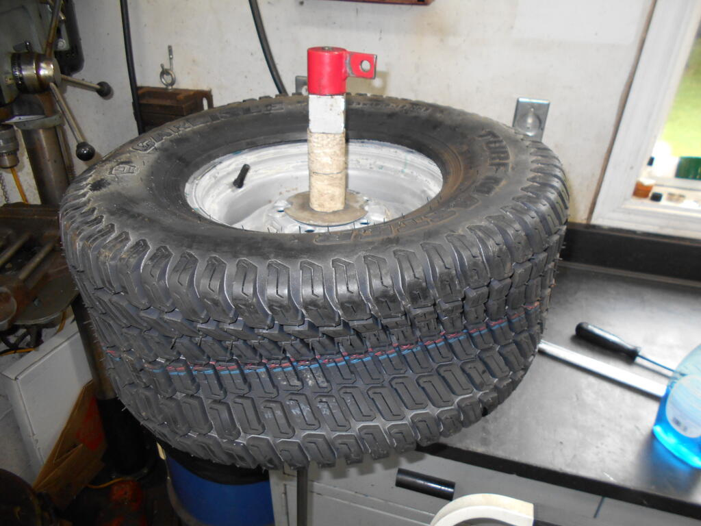

cleat

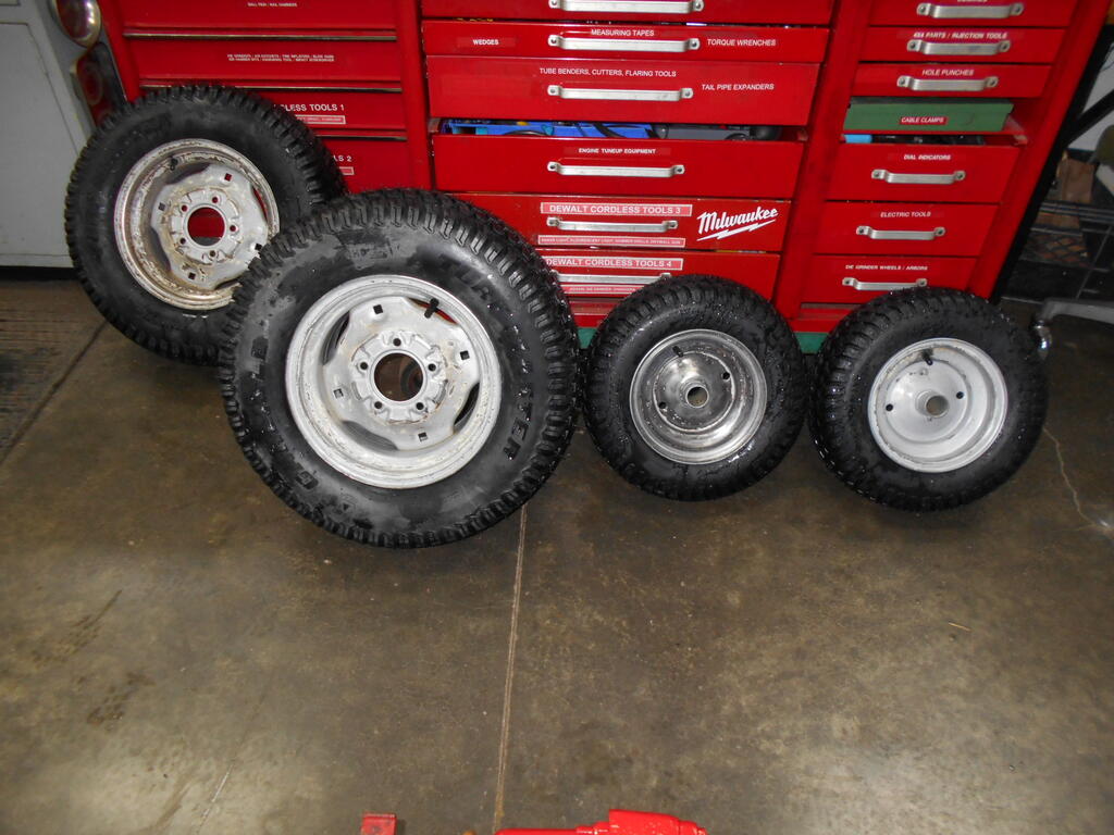

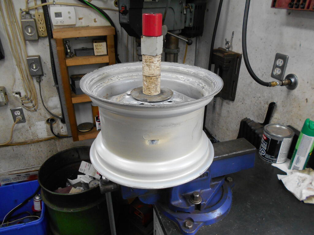

Getting ready to mount tires.
I did this yesterday but the internet went down due to heavy rain so I could not post pics.
Rears are Carlisle turfmasters that I got a great deal on last winter (I don't remember who from).

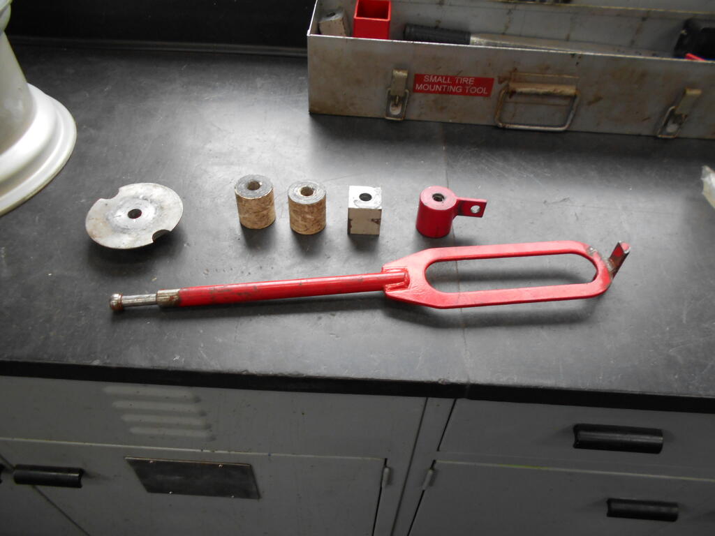

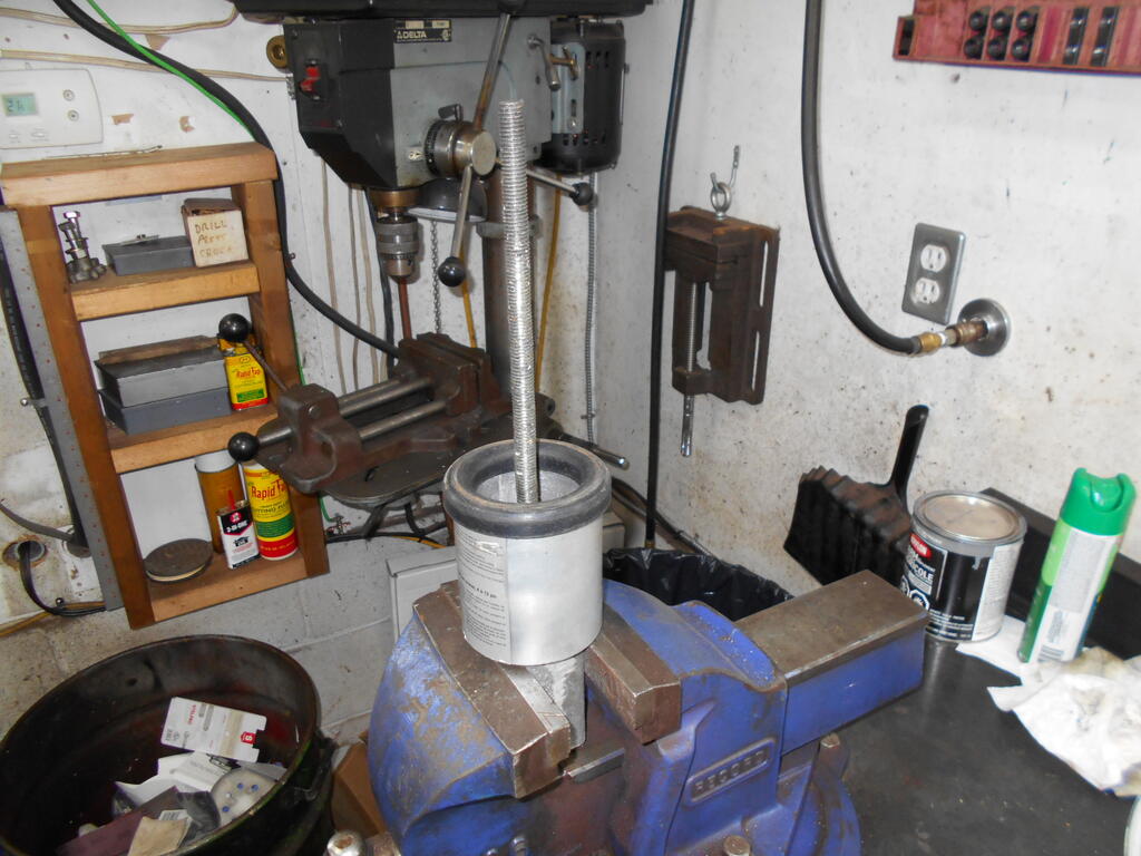

This is the tool I use for all of my Lawn and garden tractor tire mounting and demounting.

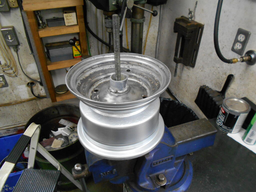

Rear wheel mounted on tool.

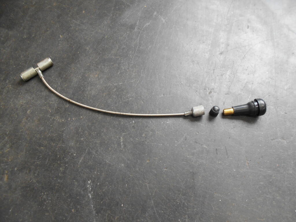

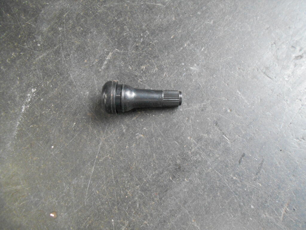

New TR413 valve stem ready to be installed.
Tool used to pull valve stem into position after giving it a light lube with dish soap.
Valve stem installed.

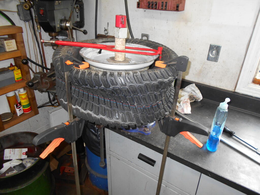

Tire bead and outer edge of wheel was lubed with dish soap then the tire was pushed on.
These tires seem just slightly small so it is quite a push to get it on.
Next step is to put a couple of clamps on the tire to reduce it's width so it is held down into the smaller diameter portion of the wheel for the tire installation to go easier.
The tire bead, top edge of the wheel, and the tire installation tool are lubed with dish soap and the tire is popped into place.
157091736_Reartireinstalledontowheelshowingclampsusedtopushtirenarrower.JPG.f7caf2731e71f3f5d9749622298c4383.JPG

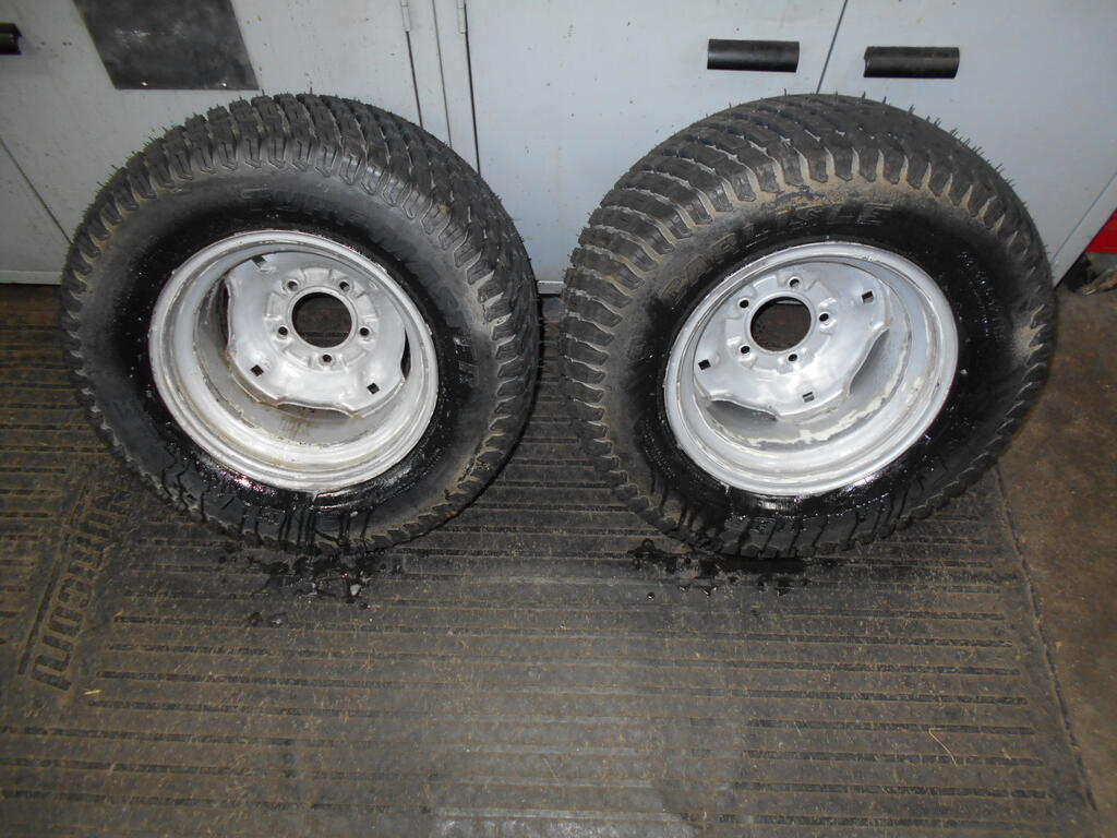

Tires aired up to 20 PSI to fully seat onto the beads
Tires sprayed with Snoop to check for leaks.
None found.
1576756436_Leakdetectionsprayappliedtocheckforanyleaksnonefound.JPG.62191c2c51d02dd146a5d8731e2eec90.JPG

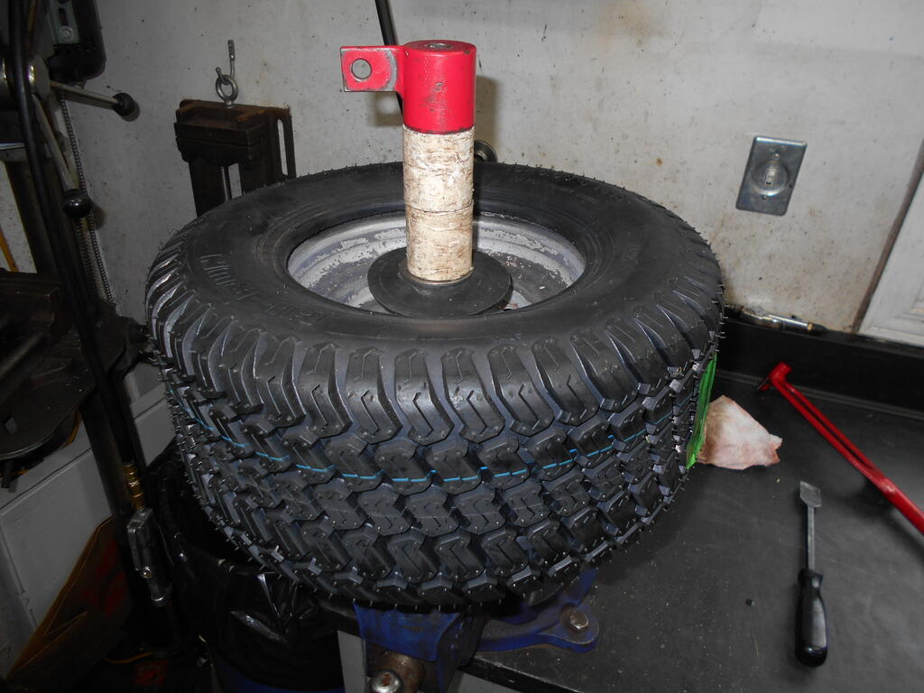

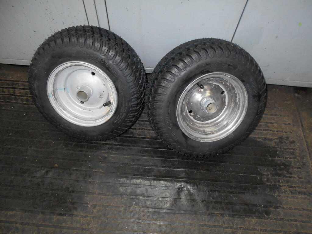

Front wheel sat on tool.
Front wheel clamped into place then the tire was lubed and popped into place.
Again, harder than it sounds but it went on.
12882504_Frontwheelclampedontotoolthentirepushedon.JPG.0f2789116f2af6acba1448950c9bfe48.JPG
Tube installed and the valve stem tool is screwed on so I don't accidentally knock it down installing the tire.
Front tire installed using the same technique as for the rear with the clamps and lube (I know that sounds bad).
All four assemblies taken outside and washed to clean up the tires and get rid of any dish  soap.
  • Like 7
  • Excellent 1
