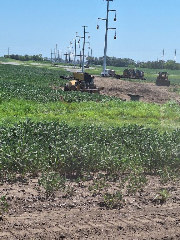

Beap52 2,439 #1 Posted July 21 (edited) ...but, Took a little road trip today. Left south Missouri to go to the farm in north Missouri to transport a piece of equipment back home. 73 year old me in a 34 year old GMC K2500 with 237,000 miles on it pulling a tandem axle trailer. 368 miles and some six hours of driving. While at the farm I got to ride around and see the goings on. If you all remember, there's a power line crossing the farm from a gas turbine generator being built a couple of farms behind ours. 350 ci (5.7) TBI engine oil pressure held a 35 psi, the engine coolant ran ~195 degrees and the 4l80 automatic transmission was between 180 to 195 degrees. Pretty good considering it was sunny and 95 degrees with heat index of 105. Air conditioner blowing cold and Boots Randolph and Flatt and Scruggs bluegrass playing on the original factory cassette payer. Life can't get much better! The picture below is some of the power line poles being installed. Cement foundations are about 6 feet in diameter and 33 feet deep. My brother said that on the bolts poured into the cement had to be withing 2 degrees of being in alignment. The pullies that they feed the 2" transmission wire through are a good 3 feet in diameter. Observations: 1)smallish SUV's pulling camping trailers 2)Stopped for gas ($3.56 per gallon) and watched a family in two vehicles park at the pumps (in the shade of course). They got out of their cars and head into the convenience store before getting fuel. It's a good thing I was leaving because it was going to be the only available pump. Edited July 21 by Beap52 additional information 13 3 Share this post Link to post Share on other sites

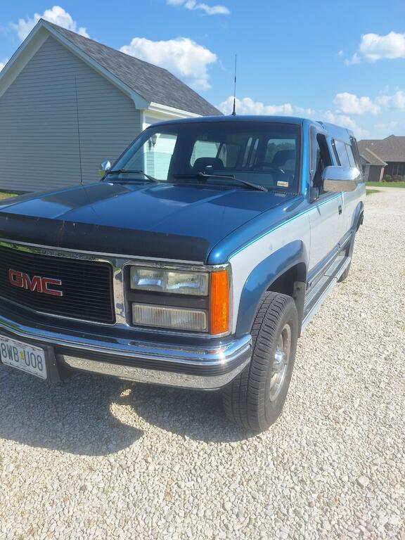

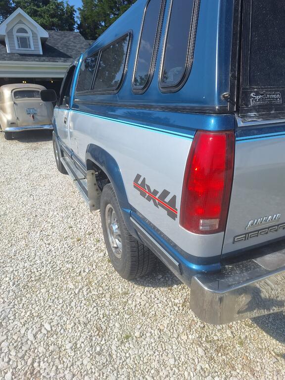

Beap52 2,439 #3 Posted July 21 2 minutes ago, Sparky said: Actually it’s a cool story. Pics of the truck? I'm the 2nd owner. Original fellow bought it in his 60's and sold it when he could no longer drive. I went to local dealer and they printed out their repair and maintenance history of it. I've had to replace several of the small sensors and the like. Engine and transmission are original and other than the seals we replaced last winter haven't been messed with. It's a rust free truck and I do my best to keep it that way. I've owned it ten or twelve years. 11 3 Share this post Link to post Share on other sites

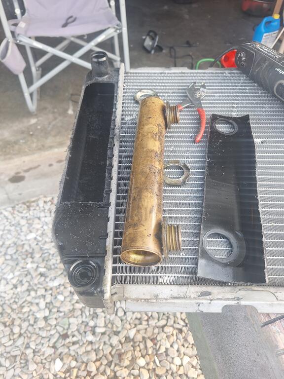

Beap52 2,439 #11 Posted July 23 I should know better than to brag on how well the truck ran. Well, i discovered oil in the antifreeze-not a lot probably no more than a cup-but enough to let me know I had an issue. No bubbles in the radiator, so I assume it wasn't a cracked head or blown head gasket. The engine has never overheated. The oil in the engine was low mileage and still clean and it showed no water. In conferring with a mechanic buddy he and I wondered if it was a leak in the motor oil cooler inside the radiator? I was pretty sure it was motor oil and not automatic transmission fluid. I bought a new radiator after pressure testing and finding seeping antifreeze in the old one between the plastic and aluminum when I applied 20 psi. The radiator cap is 16#. I disconnected the lines from the radiator and was hoping to see if pressurizing the radiator would produce a leak from the in-tank engine oil cooler connection point but couldn't hold pressure long enough, Once I had the old radiator out, out of curiosity, I removed the oil cooler, placed it in water and pressurized it. A steady stream of small bubbles came from inside the hollow tube. I had no idea of what the cooler was going to look like. I'm amazed that much cooling takes place. 1 Share this post Link to post Share on other sites
