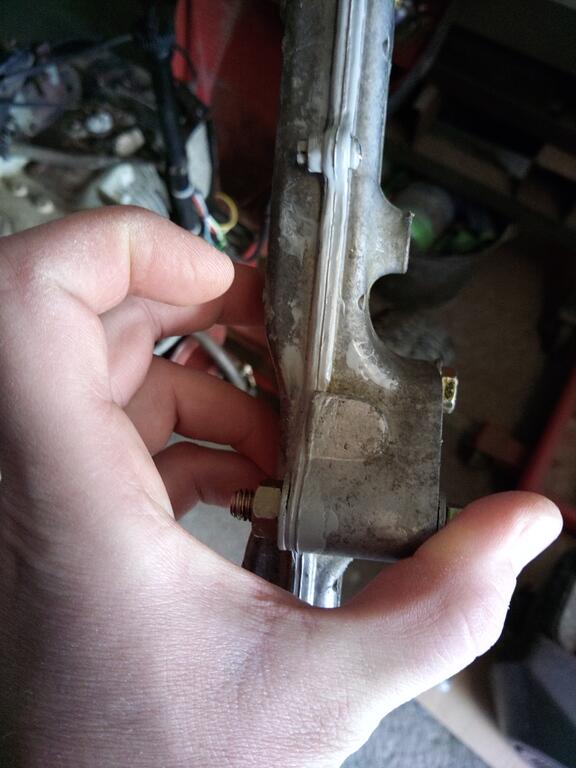

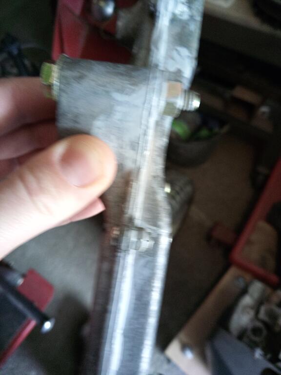

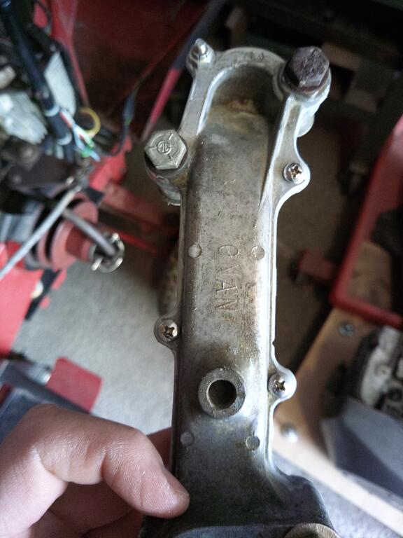

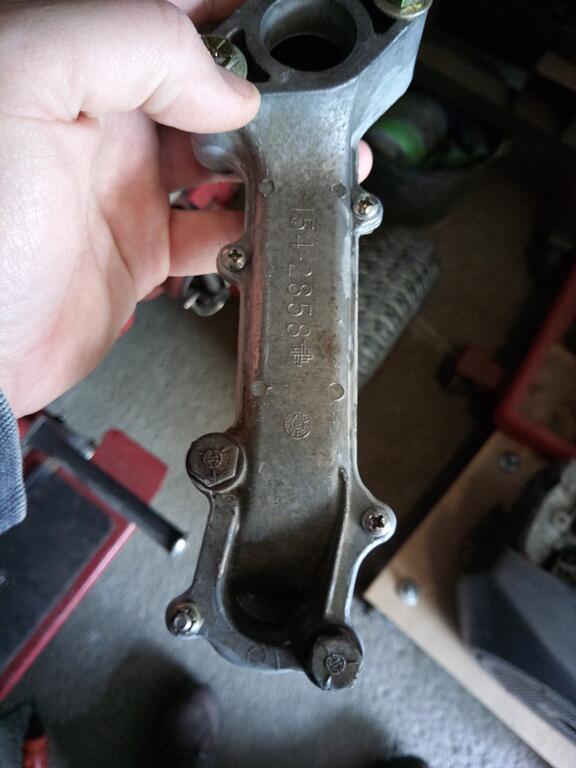

sqrlgtr 4,077 #6 Posted July 12 Pic of the new and old manifold thought I had a pic of old manifold after it fell apart but couldnt find it. As soon as I tried to take carb off manifold it came aprt in my hands . Share this post Link to post Share on other sites

sqrlgtr 4,077 #11 Posted July 13 5 hours ago, Bill D said: Getting it apart without breaking anything is half the battle. I'm curious why it fell apart so easily. Yes, I was very surprised when it just came apart in my hands, all I done was barely peck the manifold getting carb to break free from it. Share this post Link to post Share on other sites
