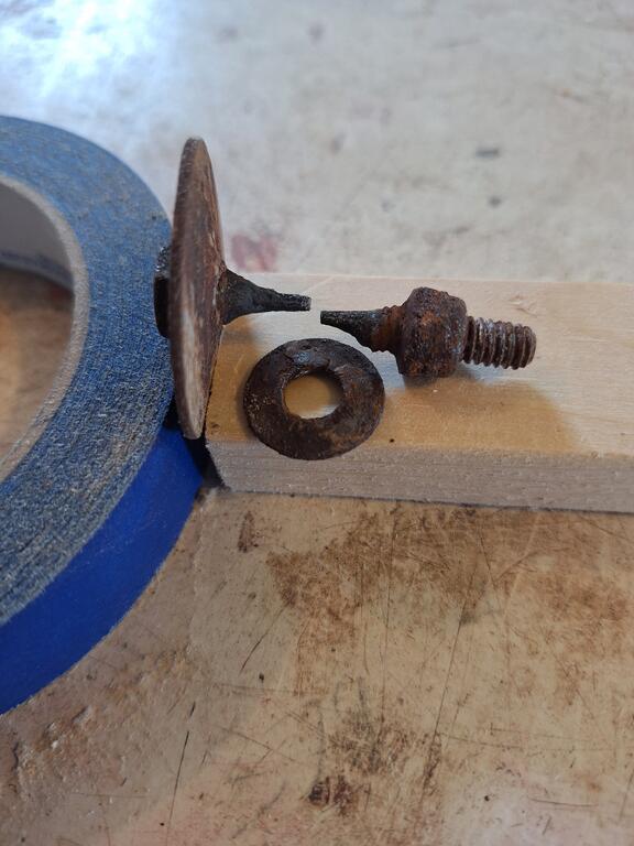

The back of the my camper shell was ever so lightly loose so I decided to tighten the bolts a bit.
I decided to check the other five bolts and below is what one of them looked like.   One failing isn't much of an issue but if the majority of the others had rusted, this could have lead  to a disaster
Easy to miss some important maintenance.

Looks familar - we have Bridge supports that look like that here in RI !! :hide:

I have had many caps on many trucks since 1978. On the aluminum one's I used 4 clamps on the short beds and 6 on the long beds. On my commercial caps always bolted down.Always good to check them. Good find    :thumbs:

We had a Dodge Dakota at work for pickups & deliveries that had a cap... one day it came back minus the cap - it flew off on Rt 95!

Aluminum is very susceptible to galvanic corrosion when in contact with a dissimilar metal. Stainless steel fasteners should have been used.

On the few I've seen the clamps are also aluminum.

Yes they are.

Every cap clamp I have ever used, going back to 1988, was an aluminum body with a stainless bolt.
