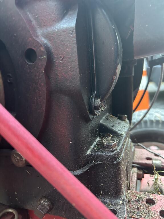

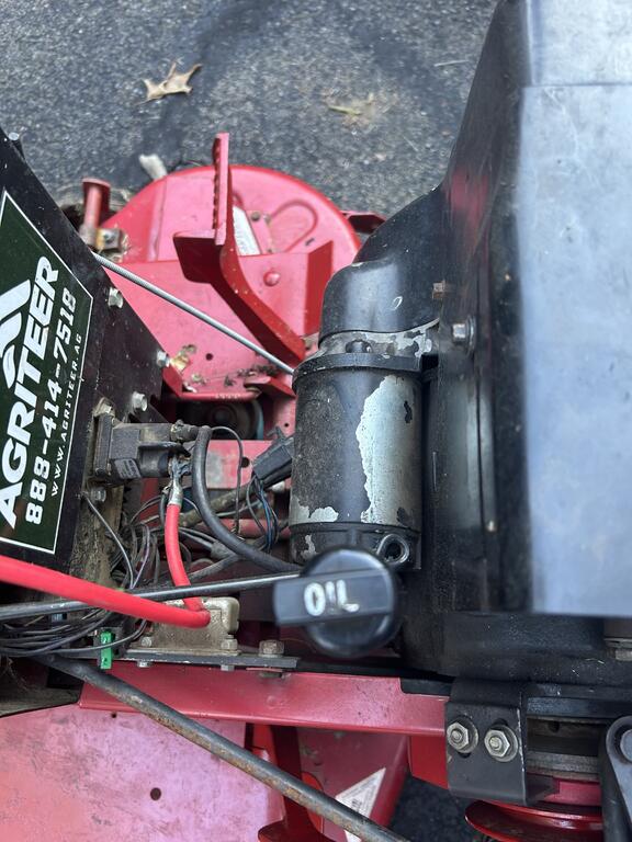

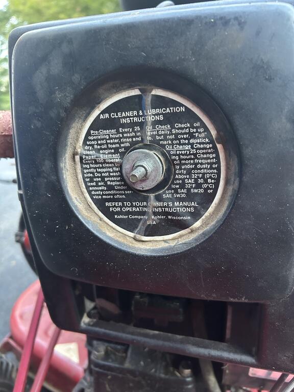

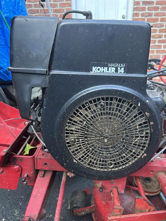

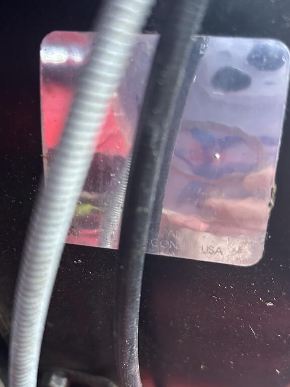

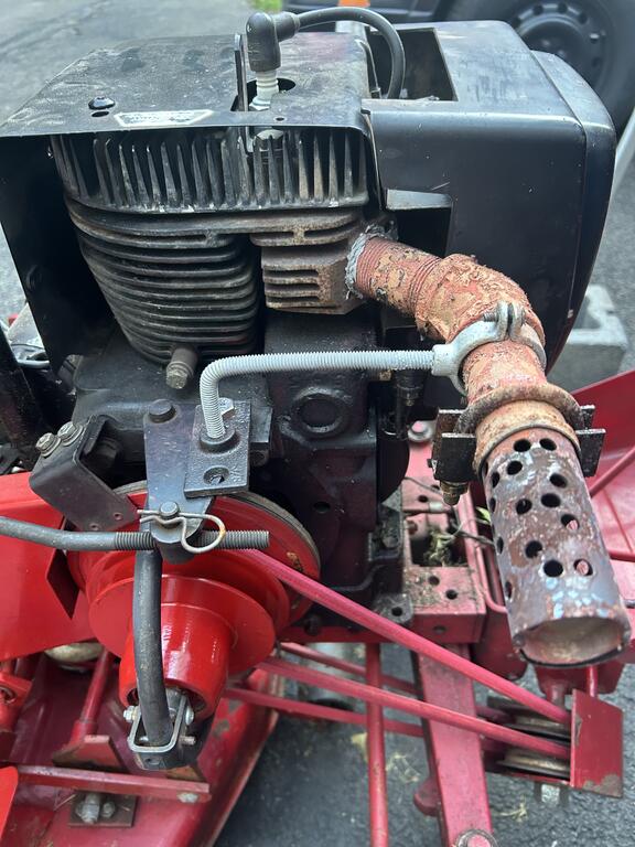

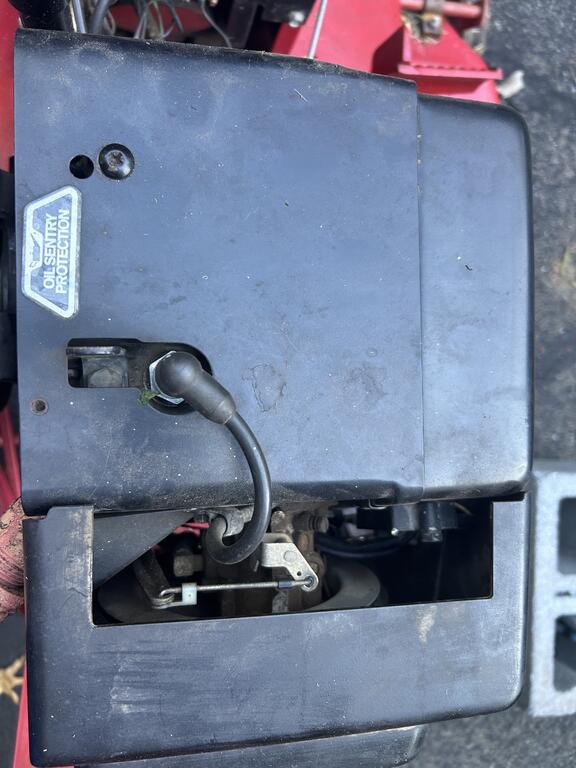

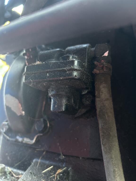

bradleydavidgood 46 #39 Posted August 25 Thanks for the info. The plate on the motor has no readable info on it anymore. Just a silver plate. Here are some pictures: Share this post Link to post Share on other sites

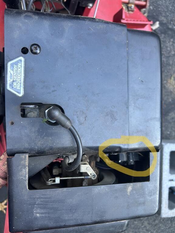

bradleydavidgood 46 #40 Posted August 26 Previously my tractor was identified as 87-89. Apparently there was a different engine in 1987 than 88-89.... 1987 Wheel Horse model: 31-14K802 Engine: Kohler M14S-601524 Factory charging system: 3-amp dual-output, unregulated No conventional 15-amp voltage regulator. Factory headlights are powered directly from the engine's AC stator circuit and normally work only while the engine is running. 1988 Wheel Horse model: 31-14K803 Engine: Kohler M14S-601540 15-amp regulated charging system 1989 Wheel Horse model: 31-14K804 Engine: Kohler M14S-601540 15-amp regulated charging system If you guys can't identify the engine exactly from the pictures, then maybe we can do it by looking for the regulated charging system. Thanks 1 Share this post Link to post Share on other sites
953 nut 70,584 #41 Posted August 26 With your air filter cover removed you will see the voltage regulator if yours is a 15 amp charging system. Share this post Link to post Share on other sites
OoPEZoO 632 #42 Posted August 26 I’ll bet the neighbors love that exhaust pipe….LOL. Share this post Link to post Share on other sites
pfrederi 21,340 #43 Posted August 26 You have the 15 Amp system Spec 601540 Can see the regulator circled in yellow Share this post Link to post Share on other sites

bradleydavidgood 46 #45 Posted August 27 6 hours ago, OoPEZoO said: I’ll bet the neighbors love that exhaust pipe….LOL. Yea I was away for 3 weeks and the grass was high and the old muffler blew right off the side and dropped on the lawn. I had the gun range ear muffs on so it didn't bother me and was determined to finish the yard. I got the one side done then went down to the other side near the intolerant type neighbor who by the way runs loud equipment very often especially one of those very loud backpack blowers and has to get every leaf several times a week, powerwash everything, mow constantly, etc. Well when I turned around the wife was on the deck just looking at me and the man was almost jumping up and down like "no stop that!". I pointed to the little patch I had left as to say "Just this little bit more", and he jumped up and down even more. It was really funny but I restrained myself from laughing and drove the tractor away, parked it in it's spot and turned it off. So yea they loved it. If I saw/heard my neighbor mowing with no muffler, I'd take my mower over and finish it for him. 1 Share this post Link to post Share on other sites

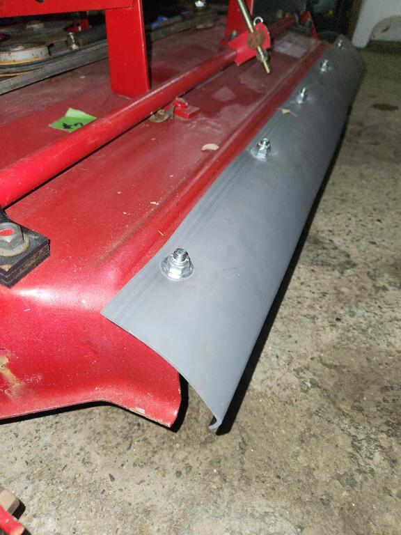

Brockport Bill 2,538 #49 Posted August 27 if you have a 42 rear discharge deck ( not a recycler ) I suggest you consider adding a deflector on the rear - - i use vinyl base cove molding and carriage bolts - - it deflects the grass down rather than straight back - keeps the rear underneath of tractor much cleaner 1 Share this post Link to post Share on other sites
OoPEZoO 632 #50 Posted August 27 I imagine the difference between 88 and 89 is little to nothing. Have you checked the tractor itself for an ID tag? I believe it should be on the fender area under the seat. Either way, a search here for either 31-14K803 or 31-14K804 should get you all of your related manuals. Same goes for your mower decks, just search the model number, and it’s all freely accessible Share this post Link to post Share on other sites
