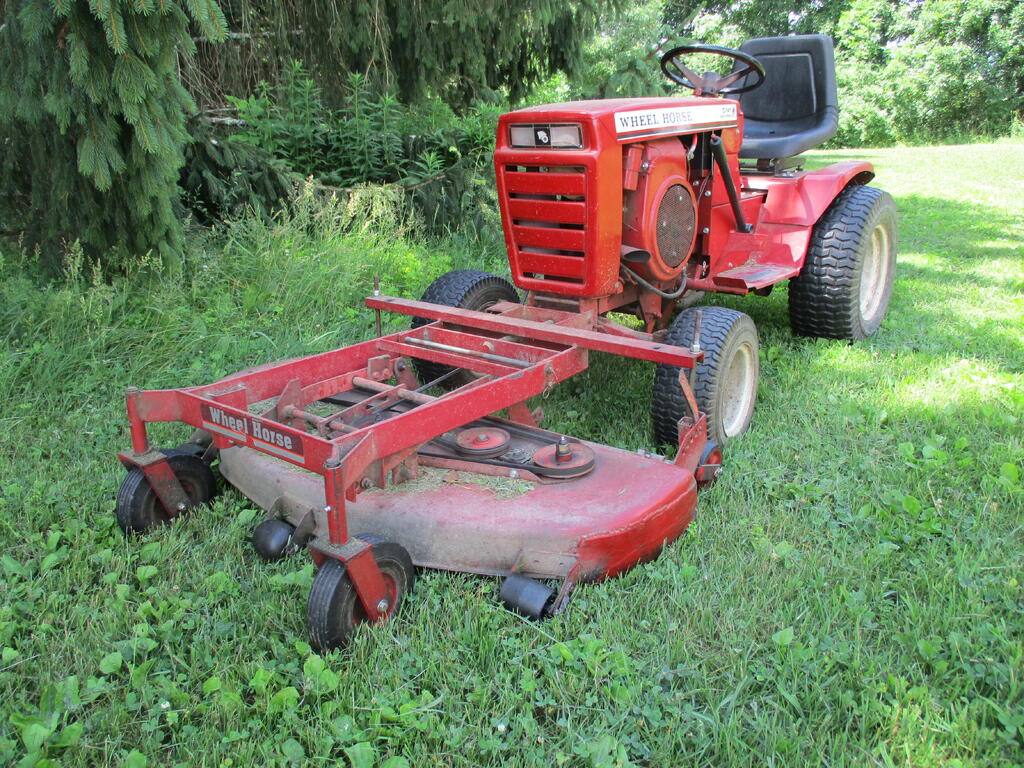

bradleydavidgood 42 #4 Posted July 9 This one is only 45 miles away from me. I think I like the idea of having it out front. What do you think? I could be mowing this weekend. If the rain stops! https://www.ebay.com/itm/267600003990?_skw=wheel+horse+mower+deck&itmmeta=01KX4FZKTEX4GRYAAZBHZD131T&hash=item3e4e340396:g:sX8AAeSwF~Fprvr5&itmprp=enc%3AAQALAAAA8GfYFPkwiKCW4ZNSs2u11xBPuXYa9R6sq0o%2Bul9jcxEsHHzVLnMy4r4mvV7sunlWk8XM%2BGQCkJ8YGM3SqHb9sBlySnEHH94nqeigtaxUYNdGUMb9sL9d4W5QGYW7cIZMXUmAVHEXtMMz023Lxg%2BQAnOW7yhVZabPezpaYN1vePwUyxqTW1pznTDJOqL%2FcK0tEd363Sq172loIW9%2BOz4%2BZD8tPT0AuPNTu3ySjtD0dkyNJ0dPZ3PLMpzaS5hcttDrcxc7U22%2B13MXG%2FVCwIPvC%2Bgo9Rij2vsROu20YiMnFJ5SGyCCWZBHDQBvgO1q3np5aw%3D%3D|tkp%3ABk9SR6y9_o_pZw Share this post Link to post Share on other sites

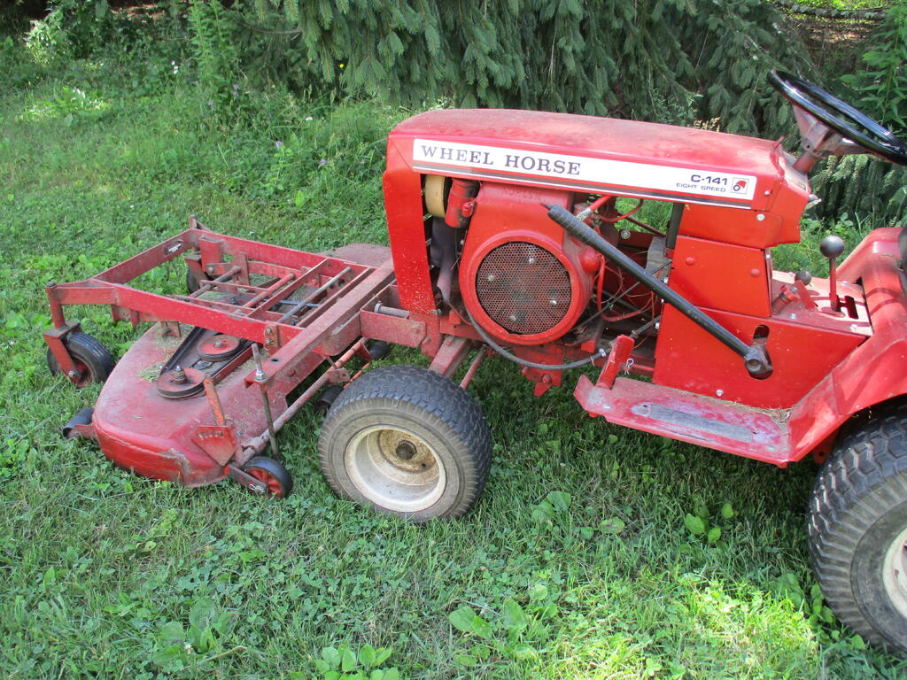

Handy Don 17,474 #5 Posted July 9 Note that unlike a mid-mount deck, where gage wheels close to blades control the cutting height, this one is suspended from the frame and supported by the casters and the tractor’s font wheels. Those “rollers” are there for anti-scalp and are not intended to be in regular ground contact. This style is helpful, though, for poking the deck under things like fences and shrubbery. It is a 48 (and you mentioned 42’s). So it’s weight for handling and room to store it need consideration. 1 Share this post Link to post Share on other sites

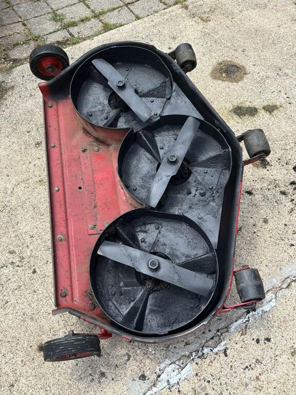

Lane Ranger 12,105 #9 Posted July 10 3 hours ago, bradleydavidgood said: And recommended size. 42" sounds right to me because easier on the 14 hp tractor, easier to find, easier to handle, still cuts plenty wide. Agree? i use a 42 inch recycling deck with my 314-8. The baffle on a resr discharge holds ghe grass clips in a little longer for recuts! But it also holds wet grass which i mowed over this week (dewy) that clings to the decks. I had it off today to clean! 3 Share this post Link to post Share on other sites
pfrederi 21,150 #10 Posted July 10 The ebay price 875 for a 48 SD deck only with rust perforations letting light though (no front mount carrier no gauge wheels) is ludicrous. 4 Share this post Link to post Share on other sites
oldlineman 1,809 #11 Posted July 10 I am running a 48 deck on my 414-8 and the 14 hp Kohler has no problem with it. 2 Share this post Link to post Share on other sites
Handy Don 17,474 #12 Posted July 10 1 hour ago, pfrederi said: The ebay price 875 for a 48 SD deck only with rust perforations letting light though (no front mount carrier no gauge wheels) is ludicrous. 13 hours ago, gwest_ca said: The one on Ebay is deck only. I don't think the front carrier is included. With the seller being out of touch on price, I’m betting that s/he also is not astute enough to consider the deck and carrier as separate items and they noted “(deck only)” to clarify that the TRACTOR is not included. 2 Share this post Link to post Share on other sites

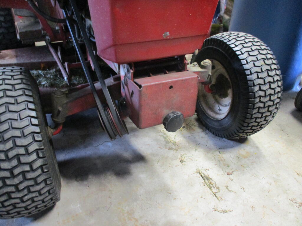

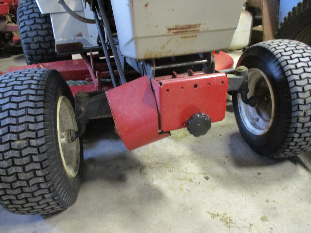

pfrederi 21,150 #16 Posted July 11 15 minutes ago, bradleydavidgood said: Thanks for all the replies, I'll go thru them soon. In the meantime, I bought this deck The next thing I'm wondering is what I need to hook it up. After lunch I'll be taking a short video of my tractor and I'll post it. Thanks! You are going to need a Mule Drive. It fits into the front Tachmatic mount on your tractor. They are supposed to have a shield like the one picture. 2 Share this post Link to post Share on other sites
pfrederi 21,150 #17 Posted July 11 I just did some mowing with my 48" front mount. I use it to mow walking paths and some semi brush hogging... I would not recommend it for regular yard work...The Queen Mary probably has a tighter turning radius. Lincoln at AtoZ is good people 1 1 Share this post Link to post Share on other sites
bradleydavidgood 42 #18 Posted July 11 1 hour ago, pfrederi said: You are going to need a Mule Drive. It fits into the front Tachmatic mount on your tractor. They are supposed to have a shield like the one picture. OK, got it thanks, mule drive on my list. Probably a couple/few more belts too? Share this post Link to post Share on other sites
bradleydavidgood 42 #19 Posted July 11 1 hour ago, pfrederi said: I just did some mowing with my 48" front mount. I use it to mow walking paths and some semi brush hogging... I would not recommend it for regular yard work...The Queen Mary probably has a tighter turning radius. Lincoln at AtoZ is good people OK good to know, makes a lot of sense. I'll take it off my list. Thanks! So I'm basically back to 42" mid mount...which is the most available anyway. That will be good. I'll probably buy another one if I see a good one at A to Z tractor when I drive up there. Share this post Link to post Share on other sites
oliver2-44 11,750 #20 Posted July 11 @bradleydavidgood The 48” deck is a good deck. It’s just when you add using it in front mount that it turns like the Wieen Mary. It you can find a liter one with round rod reinforced from lip that’s a plus. Of course the 42” is also a good deck. Share this post Link to post Share on other sites
