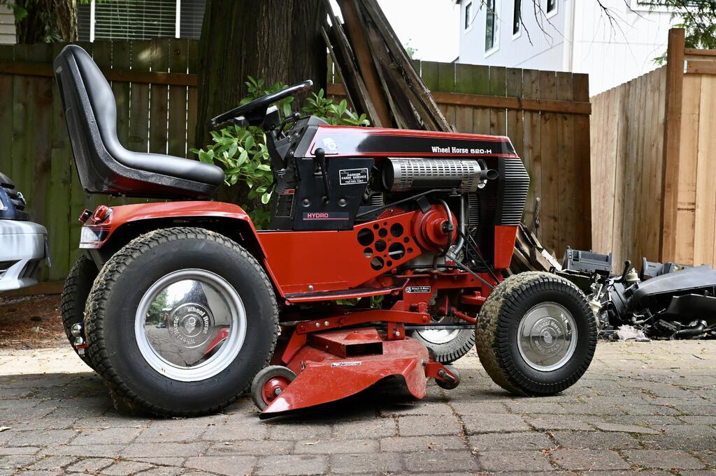

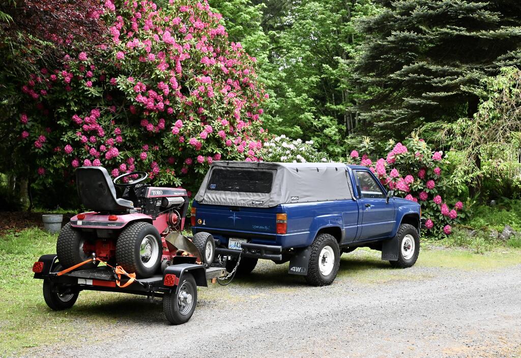

photorich1965 16 #1 Posted July 2 Thought the collective might enjoy my perforation project... I bought this tractor a couple months ago and turning it into a nice "user"... Won't be a perfect restoration, just a nice addition to my old Toyota 4x4. Rich 7 9 Share this post Link to post Share on other sites

Terry M-(Moderator) 2,331 #4 Posted July 2 Looks good to me too! That trailer is the perfect size to haul the tractor around!!👍😎 1 Share this post Link to post Share on other sites

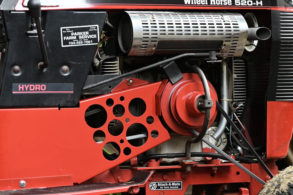

Bill D 3,213 #5 Posted July 2 Looks good. One minor detail, the belt cover goes over top of the lip on the foot board. 2 1 Share this post Link to post Share on other sites
lynnmor 9,081 #6 Posted July 3 1 hour ago, Bill D said: Looks good. One minor detail, the belt cover goes over top of the lip on the foot board. You missed the PTO trunnion being upside down. 1 Share this post Link to post Share on other sites
photorich1965 16 #7 Posted July 3 1 hour ago, Bill D said: Looks good. One minor detail, the belt cover goes over top of the lip on the foot board. I wondered about that - the bolt hole didn't line up great so thought it must be as I assembled it. I'll fix it when I repaint the belt cover. Got all sorts of runs in the finish... sheesh. Share this post Link to post Share on other sites
photorich1965 16 #8 Posted July 3 2 hours ago, Terry M said: Looks good to me too! That trailer is the perfect size to haul the tractor around!!👍😎 It's a trailer used for a pressure washer. Really too small, but I'd driven too far to opt out when I purchased it. I've had to re-weld the fenders twice aa my tractors have gotten wider ;-). Share this post Link to post Share on other sites
photorich1965 16 #9 Posted July 3 4 minutes ago, lynnmor said: You missed the PTO trunnion being upside down. Hi Lynmor - is the PTO trunnion the "U" shaped thing ? I thought it was harder to remove than it should've been when I painted - so maybe the last owner had it wrong. Share this post Link to post Share on other sites
lynnmor 9,081 #10 Posted July 3 1 minute ago, photorich1965 said: Hi Lynmor - is the PTO trunnion the "U" shaped thing ? I thought it was harder to remove than it should've been when I painted - so maybe the last owner had it wrong. It's the thing right under the muffler, the hairpin clip goes on top. Yes, most are installed wrong. Share this post Link to post Share on other sites
Handy Don 17,735 #11 Posted July 3 Be sure to keep your right shoe’s laces out of those large holes! 1 Share this post Link to post Share on other sites
Handy Don 17,735 #12 Posted July 3 1 minute ago, lynnmor said: It's the thing right under the muffler, the hairpin clip goes on top. Yes, most are installed wrong. I keep a thin washer under the clip, as well. Share this post Link to post Share on other sites
photorich1965 16 #13 Posted July 3 2 minutes ago, lynnmor said: It's the thing right under the muffler, the hairpin clip goes on top. Yes, most are installed wrong. Ah, thanks - appreciate the catch. Rich Share this post Link to post Share on other sites

Lee1977 7,813 #15 Posted July 3 (edited) 14 minutes ago, Handy Don said: Be sure to keep your right shoe’s laces out of those large holes! That big Onan is blowing out, not sucking in. Edited July 3 by Lee1977 Share this post Link to post Share on other sites
Handy Don 17,735 #16 Posted July 3 6 minutes ago, Lee1977 said: That big Onan is blowing out, not sucking in. Yep, I have one. But the belt is flying past and the airflow can be affected by your foot being there flopping the laces around. Just sayin' 1 Share this post Link to post Share on other sites

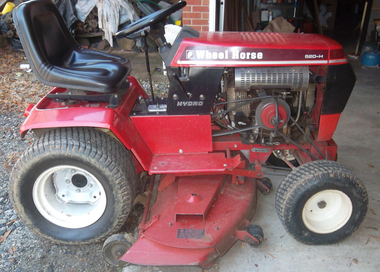

sqrlgtr 4,224 #17 Posted July 3 I took a long hard look on mine at removing that top brace that holds belt guard on top or at least trimming it up a bunch. That brace looks like it really holds the heat in... Share this post Link to post Share on other sites
mrc 1,122 #18 Posted July 3 hi sqrlgtr, i had a 520H some time ago. i thought the same as you. so i cut a big slot in that bracket. 1 Share this post Link to post Share on other sites
sqrlgtr 4,224 #20 Posted July 9 @Lee1977 2 birds one stone takes care of the brace and belt gaurd.. 1 Share this post Link to post Share on other sites
