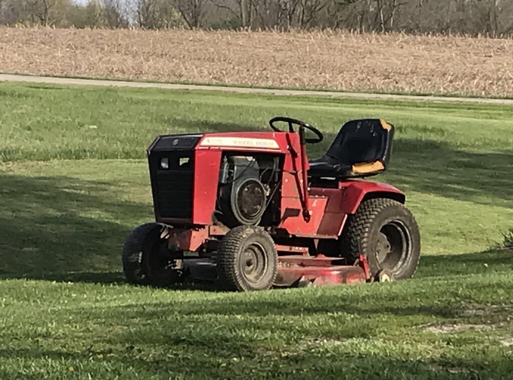

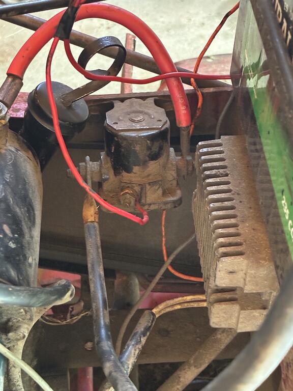

Solenoid starting to give me issues as it’s original to tractor an you can’t find one like it. Don’t know part number. Has K341 16hp engine.
There are so many on line and locally and I really don’t know which to buy. Any advise welcome.
I changed the switch as I had a NOS new one that was same part number as old one.
Old solenoid gets fire but plunger inside is sticking at times now. If I work the switch I can get it to start.
I don’t like the looks of the new ones, but don’t have much choice.

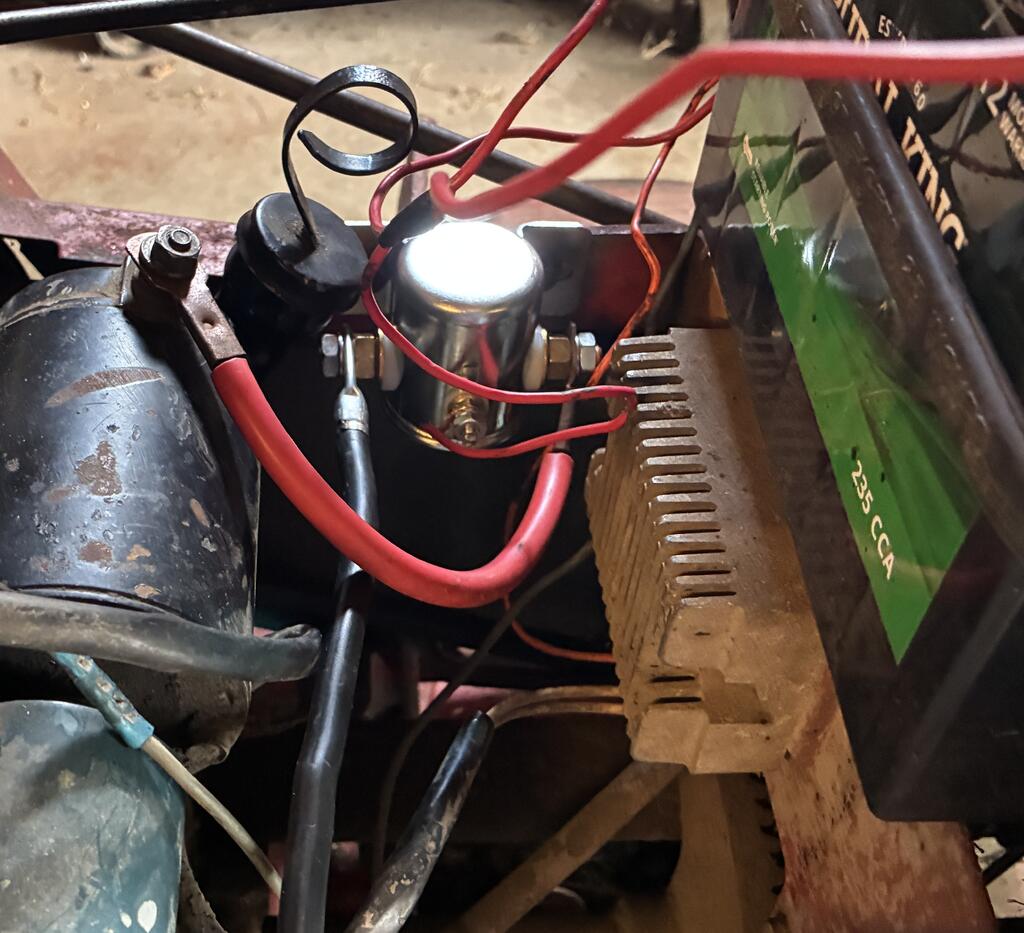

Went with the Cole Hersee through Advance Auto home shipping free and was what I thought reasonably priced. Always Rust-Oleum
Thanks again all for the input..
rustyedge1
Posted (edited)
Problem solved. Thanks for all your help..
39 and change shipped to my address..The ST58 was 33 and change but would have to pick up at store. May get it as extra..
