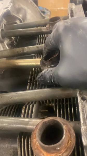

cafoose 3,839 #7 Posted July 1 2 hours ago, adsm08 said: Are those the ones that would asphyxiate you at stop lights? I had a 1963 four door in the mid 1970's. They had push rod tubes in the heater box with O ring seals at the ends. When the seals deteriorated oil leaked into the heater box and the fumes came out the heater vents. Being air cooled, they relied on hot air from the exhaust manifolds for heat. Push rod tubes were inside the heater box. The Chevrolet Corvair heating system relies on a direct-air setup rather than a traditional liquid-cooled system. It captures heat generated around the exhaust manifolds, routes it through a blower, and distributes it to the cabin. Because of its unique design, any oil leaks from the engine or pushrod tubes can introduce exhaust odors directly into the car. 1 Share this post Link to post Share on other sites
squonk 48,110 #8 Posted July 1 I had a 67 110 HP and Powerglide. Car would fly. I had the leaky pushrod tubes. Replaced them with Viton O-rings and no more problems with fumes. I had to carry a hammer under the seat. Every so often the L side carb would flood and I'd have to get out and give it a whack! Great fun! Share this post Link to post Share on other sites
