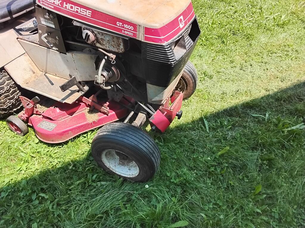

maine home 2 #1 Posted June 28 (edited) Hi, I'm burning up PTO belts on a GT1600 mower. Could the pulleys by the tighter be worn out? The outside belt keeps jumping to the inside pulley? Would also like to know what the adjustment on back of deck is for? Thank you 20260629_142130.mp4 Edited June 29 by maine home Added pics Share this post Link to post Share on other sites

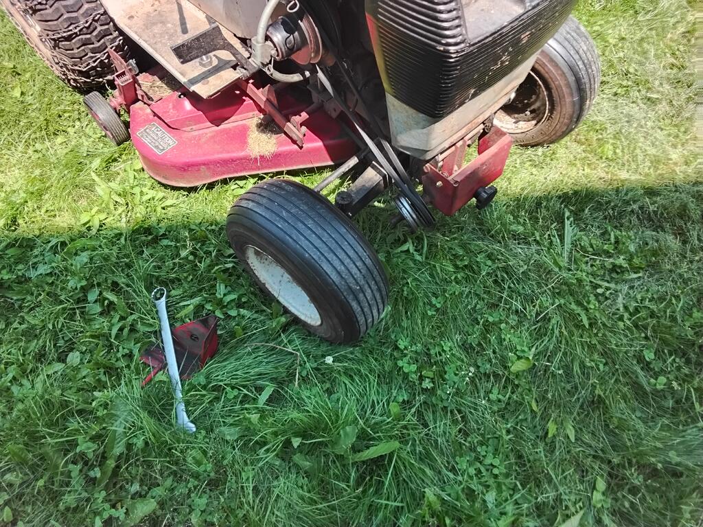

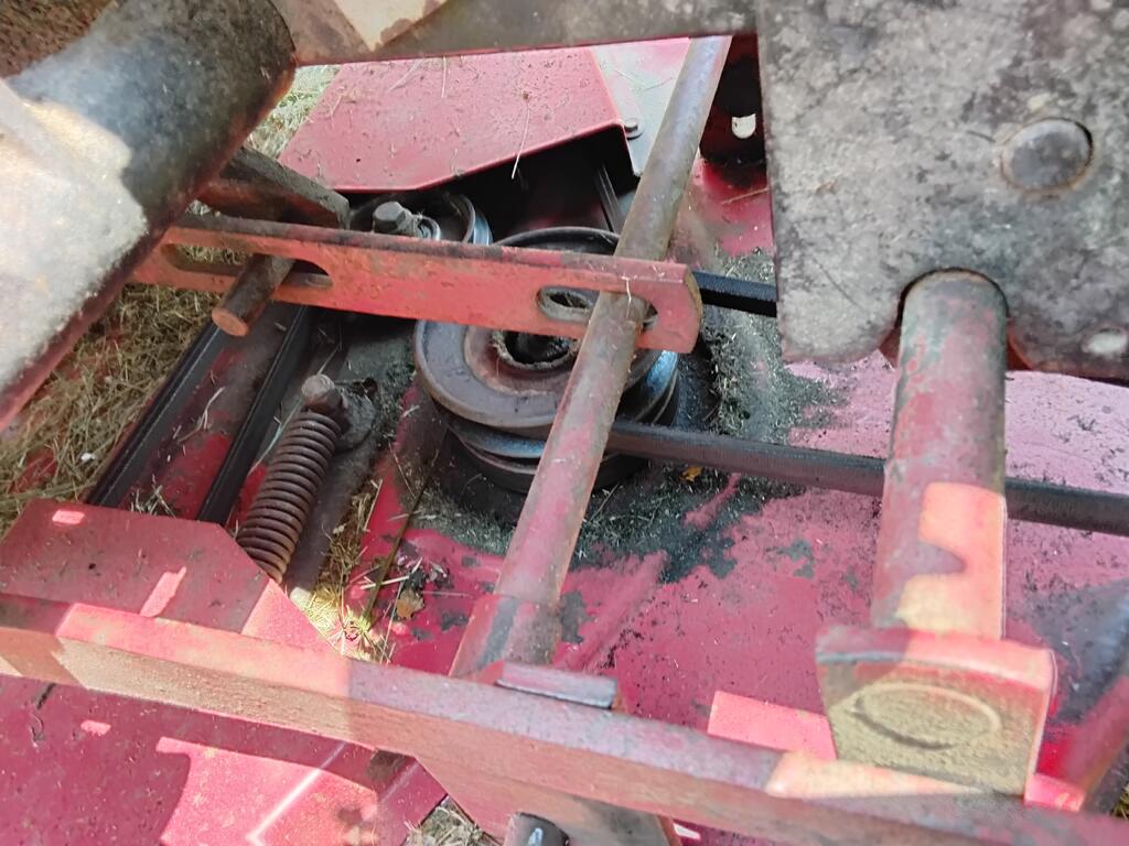

maine home 2 #11 Posted June 29 I just edited my post. Added pics. The sparer is spit see pic. I need part number. Share this post Link to post Share on other sites

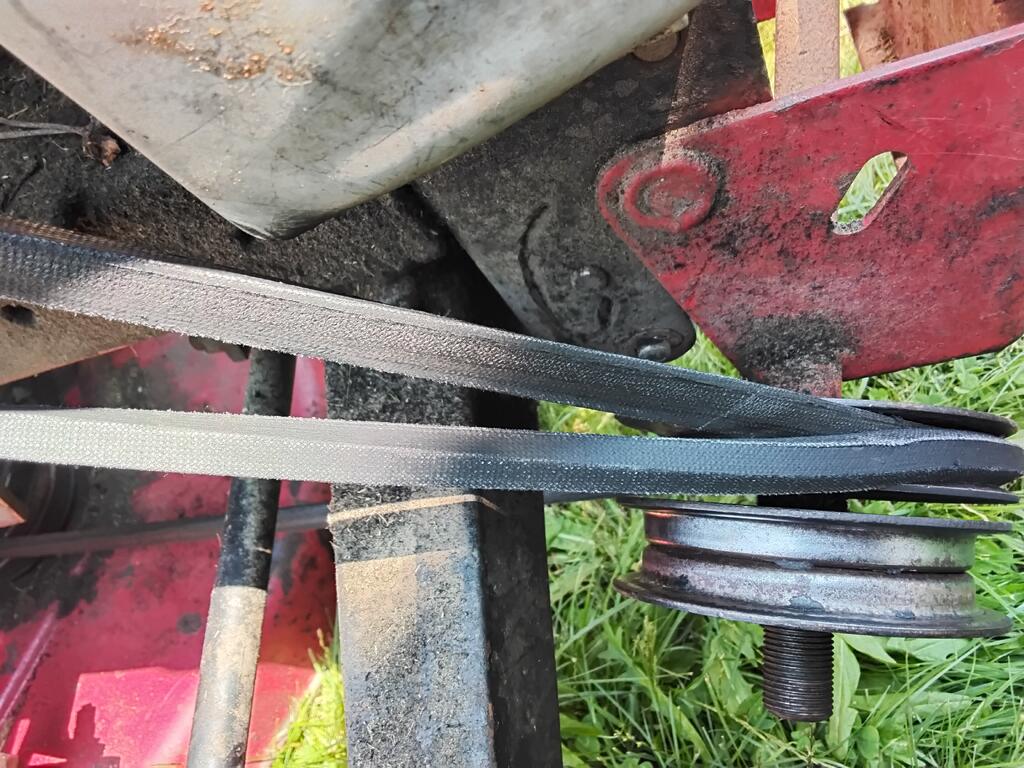

Handy Don 17,731 #12 Posted June 29 At first glance, it looks like the engine-to-deck belt might be the right length but looks to me to be not the right width (or else it is extremely worn). A properly fitted belt should, when new, ride with the outer surface of the belt being very slightly above the edges of the V pulley. 2 Share this post Link to post Share on other sites
maine home 2 #13 Posted June 30 On 6/28/2026 at 8:38 PM, MainelyWheelhorse said: @maine home Hi fellow Mainer! What size is the mowing deck? Pictures of your setup should definitely help us figure out what’s wrong. There could be many things that could cause the belt to jump. The smaller 37’ inch deck use one belt from the PTO to the deck. The bigger ones like the 42” inch ones use two. One from the PTO to the front most middle pulley on the deck, and one just on the deck to run the mowing blades. The belt from the PTO to the deck is on the mule drive. If it’s jumping, something could be wrong with the pulleys. If it’s the mule drive it might not be tight enough, or something is off there. There’s a few possibilities. It's a new belt but it twisted when it jumped the pulley. Now it has a bad twist in it and will not work. Share this post Link to post Share on other sites
maine home 2 #14 Posted June 30 16 hours ago, 8ntruck said: to the forum. Make sure that your pulley bearings and center mower shaft bearings are not sloppy and spin freely. Working from memory here, I think that the pulley spacers on the mule drive shaft are different lengths. If you get them in the wrong place, belt alignment will be a bit off. Sorry, but I don't remember right now which one goes where. Belt tension should be in the neighborhood of having about 1/2" belt flex on each side of the belt halfway between the PTO and mule drive. A remote possibility is that the mule drive shaft might be bent. This would certainly mess with pulley alignment. Good luck. Please, when you find the solution, post it - share the knowledge. Check my pictures. The third spacer broke the weld spitted (see pic). That looks like the problem is? Share this post Link to post Share on other sites
maine home 2 #15 Posted June 30 On 6/28/2026 at 8:38 PM, MainelyWheelhorse said: @maine home Hi fellow Mainer! What size is the mowing deck? Pictures of your setup should definitely help us figure out what’s wrong. There could be many things that could cause the belt to jump. The smaller 37’ inch deck use one belt from the PTO to the deck. The bigger ones like the 42” inch ones use two. One from the PTO to the front most middle pulley on the deck, and one just on the deck to run the mowing blades. The belt from the PTO to the deck is on the mule drive. If it’s jumping, something could be wrong with the pulleys. If it’s the mule drive it might not be tight enough, or something is off there. There’s a few possibilities. 36? Share this post Link to post Share on other sites
