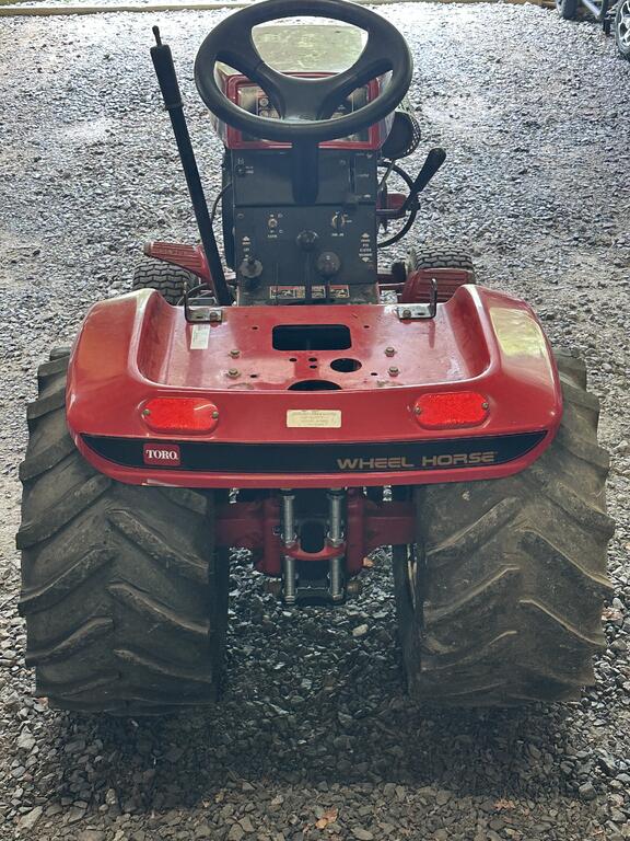

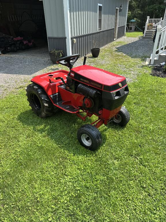

This is what we have done so far. I’m currently trying to build a weight system for the entire tractor.
  • Excellent 6
TonyToro
Looks like a great start. We build a bunch of our own hitches like that using cub cadet hitch and then welded plate steel to it and attached to the transmission. I was talking with D&D for a while until he came out with his hitch. I’ve bought a few now. Best hitch I’ve found. It also allows the use of any aftermarket wheelie bar. I’m hoping next he will come out with an under transmission weight box and a mid weight bar. I have been doing all my own fabrication and welding but with costs of materials going up and my time getting limited these guys that make parts to me is a better option.
but since you already have the hitch for wheelie bars I’ve used angle steel, mounted that to the underside of the transmission and a flat steel plate on top, then through bolted it. Do this on both sides. Add whatever you want for wheels or skidders.
