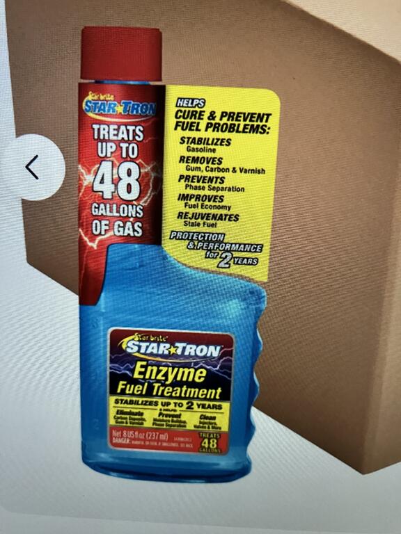

Retired Wrencher 6,986 #18 Posted July 4 On 6/23/2026 at 5:57 AM, ebinmaine said: Sta-bil has been well proven to slow down the degradation of the gasoline whether it is ethanol free or not. However, it has also been well proven that it does absolutely nothing to negate the negative effects of ethanol. Around our acreage we have no ethanol, no additives, and no problems. Eric I have been using Star-Tron Enzyme treatment for years now. One cap full treats 1.5 gallons. Had good luck with this. This for the Non Eth fuel because of storage. I do not go through 5 gallons that fast so that is why I use it. I guess cheap insurance. I buy 20 gallons at a time. 1 Share this post Link to post Share on other sites
