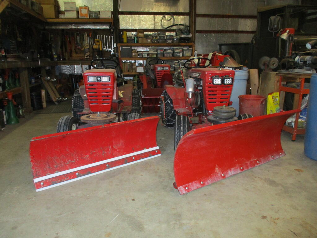

pfrederi 21,150 #3 Posted June 22 You can probably pick up a plow with a worn edge cheaper than making something that may or not fit/operate correctly. Put a piece of plastic on it like the one in the picture ..no scratches on your driveway 6 Share this post Link to post Share on other sites
OoPEZoO 609 #4 Posted June 22 (edited) I agree with Ed. I love fabricating stuff and seeing other people’s creations and homemade solutions. I also use my tractors for plowing. There is no way I would ever consider trying to make a plow. They are “cheap” and typically readily available. I mean, maybe adapting a different plow blade to fit a wheelhorse plow frame would make sense in certain situations, but the main plow frame? Forget about it, just buy one @pfrederi, how often do you have to change out that plastic edge? I just got my driveway repaved last week and it’s time to replace my plow edge. Curious what you use and how well they hold up? Edited June 22 by OoPEZoO 2 Share this post Link to post Share on other sites
pfrederi 21,150 #5 Posted June 22 I had one a 42" blade for several years in float mode.The one pictured is on a 48" blade that has been used for 4 years but now I use down pressure it is wearing some. Now I use it mostly to plow the section of driveway that is pavers the rest is gravel so only about 75'. Price has gone way up since I bought the 48' piece and that was more than the original 42" Share this post Link to post Share on other sites

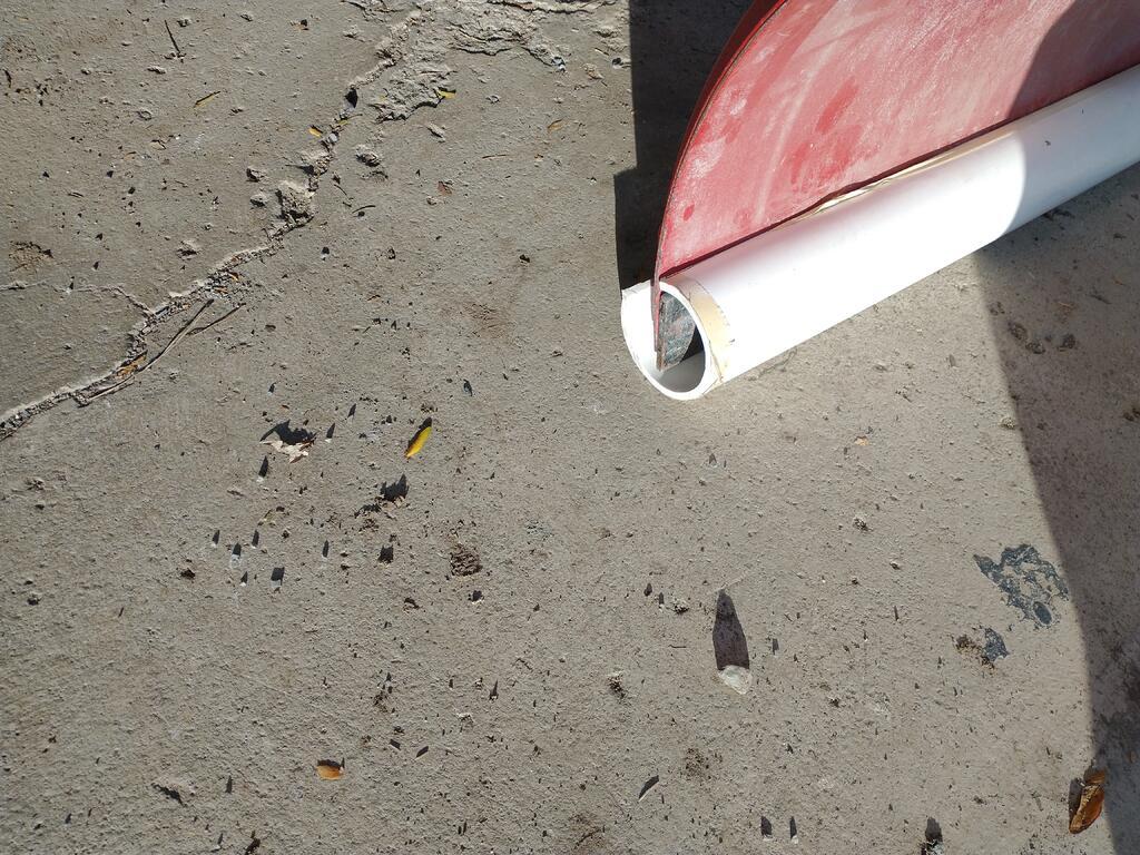

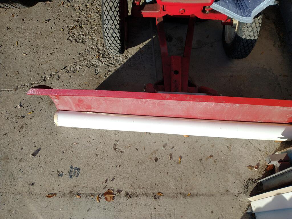

squonk 48,119 #6 Posted June 22 I use a split section of 3" PCV pipe. 5 2 Share this post Link to post Share on other sites
ri702bill 13,050 #7 Posted June 22 (edited) Too bad you can't invert it for a second go when it wears thru... Good inexpensive, readily available choice of off the shelf material, if I must say so.. Edited June 22 by ri702bill 3 Share this post Link to post Share on other sites

Bar Nuthin 3,221 #9 Posted June 24 (edited) I second the notion of the plastic wear strip for use on sealed blacktop. This one is HDPE and shows minimal wear after two years. Got it from ShapesPlastics.com. Ordered it "Cut to Size" - all I had to do was drill holes. Ordered it wide enough that I can flip it, if it ever wears out. Edited June 24 by Bar Nuthin added URL source 1 Share this post Link to post Share on other sites
OoPEZoO 609 #10 Posted June 24 That's nice.....decent price too. I just looked at McMaster-carr and they sell 4"x48"x1/2" HDPE bar stock that would be perfect as well. Dropped a pretty penny to get my driveway looking nice, I'd like to keep it that way for at least a season or two. Thanks 1 Share this post Link to post Share on other sites
