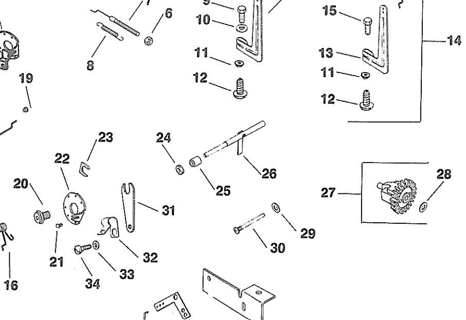

WHX?? 58,290 #2 Posted June 19 I guess I never saw a bushing there or don't remember. Another guess is it was binding on the flag and the brass retainer nut? Too long perhaps? As long as the flag sits directly in back of the governor leave it out. Does the parts manual show it? Share this post Link to post Share on other sites

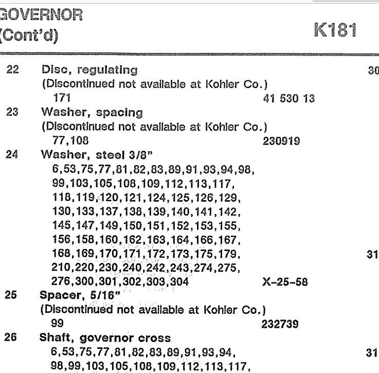

pfrederi 21,215 #3 Posted June 19 (edited) #24 It is used by virtually all variations. Note the #25 is only used on 1 variation The description is misleading the OD of the washer is 3/8 Edited June 19 by pfrederi Share this post Link to post Share on other sites

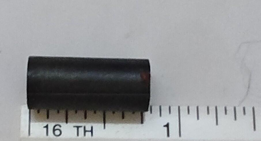

rmaynard 17,612 #5 Posted June 19 This is what I removed Share this post Link to post Share on other sites
squonk 48,207 #6 Posted June 19 8 minutes ago, rmaynard said: This is what I removed I've had about a half dozen K181's torn completely down the last couple of years and never saw anything like that in there. Share this post Link to post Share on other sites

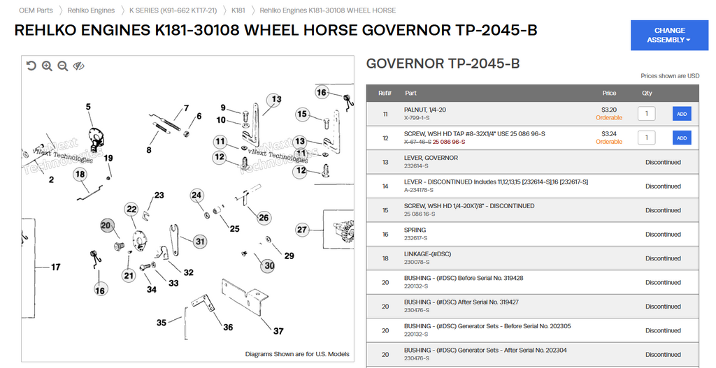

pfrederi 21,215 #7 Posted June 19 A quick look shows only 3 spec number engines used the #25 spacer. Chamberlain and two built for Allis Chalmers.. What is the spec # of your engine.... Share this post Link to post Share on other sites
pfrederi 21,215 #8 Posted June 19 Looked up 3 WH spec# K181 all had the #24 3/8" washer Share this post Link to post Share on other sites
rmaynard 17,612 #9 Posted June 19 41 minutes ago, pfrederi said: What is the spec # of your engine.... Label is missing. It had one and I took it off for @Vinylguy to make me a new overlay, but I never got around to putting it on. I know that the engine is original because I bought the tractor from the original owner. It is a 1-4831, 1968 Commando 8, K181S-30108D (according to the Wheel Horse All Years list) Share this post Link to post Share on other sites
pfrederi 21,215 #10 Posted June 19 (edited) If it is original it should not have the big spacer just the 3/8 washer. I had a WH that came with an AC engine... Edited June 19 by pfrederi Share this post Link to post Share on other sites
