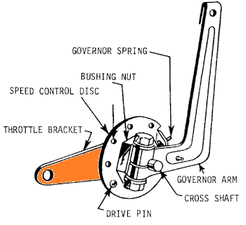

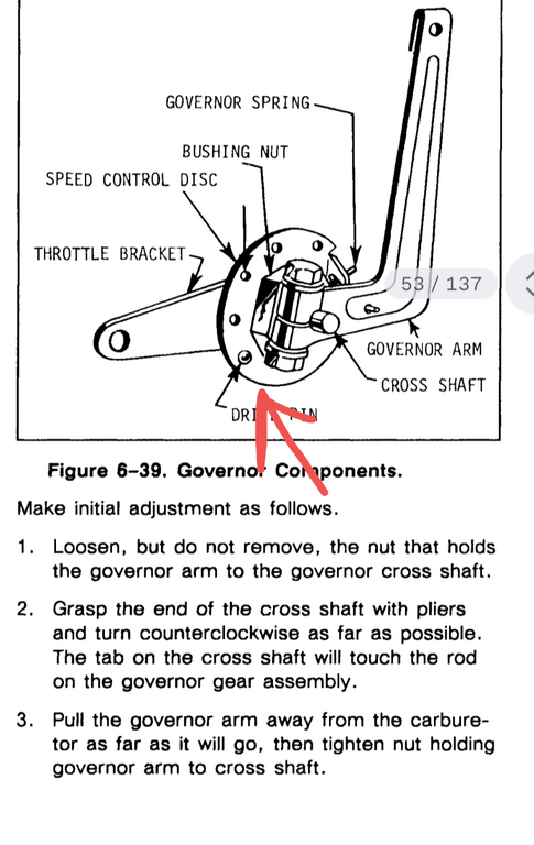

rmaynard 17,582 #1 Posted June 19 So while reading about the proper set-up of the governor, I noticed this for the first time. Described as a drive pin. What is it's function? 1 Share this post Link to post Share on other sites
ebinmaine 80,695 #2 Posted June 19 Does it prevent the disc from passing the lever? Share this post Link to post Share on other sites

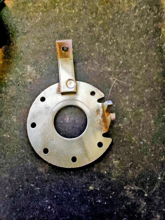

squonk 48,119 #3 Posted June 19 1 hour ago, ebinmaine said: Does it prevent the disc from passing the lever? I have a gov set up loose in a bag. I can look 1 Share this post Link to post Share on other sites
ri702bill 13,056 #4 Posted June 19 As the throttle lever end moves downward from the pull of the cable, it rotates the speed control disc in a CCW direction. The drive pin is supposed to be there to assure the disc moves that way too. 2 Share this post Link to post Share on other sites

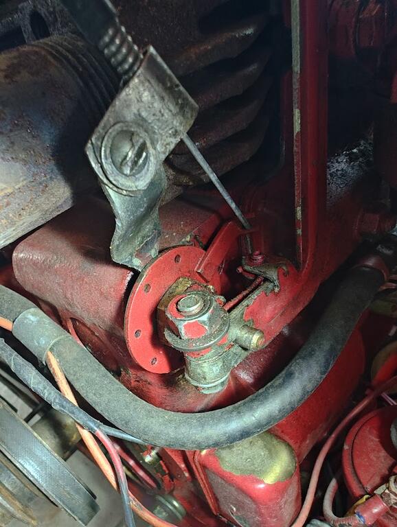

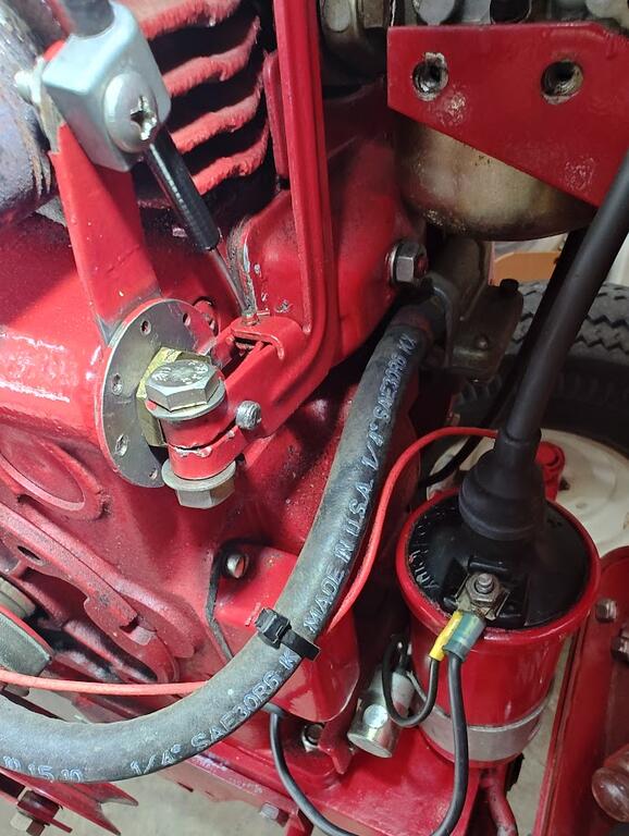

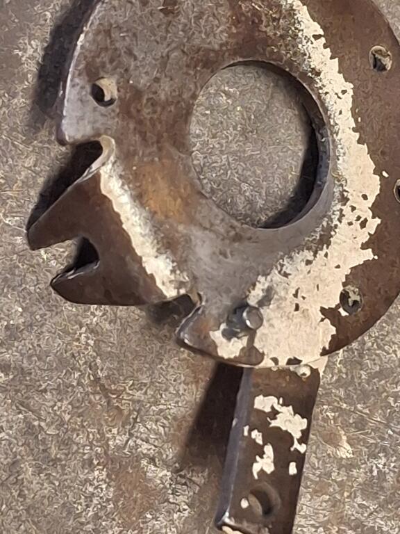

rmaynard 17,582 #5 Posted June 19 The issue is that it only appears on the drawing in the manual, but I have never seen one on the actual disk. I thought it might be a disposable pin that was only used for initial set-up. Here's three disks, 2 on working engines, 1 spare. No pins. And other than the one mention in the manual, nothing more is said about it. 1 Share this post Link to post Share on other sites
rmaynard 17,582 #6 Posted June 19 3 hours ago, ri702bill said: As the throttle lever end moves downward from the pull of the cable, it rotates the speed control disc in a CCW direction. The drive pin is supposed to be there to assure the disc moves that way too. I'm not sure I follow you Bill. Are you referring to the throttle bracket? If so, it does not move as the throttle cable is pulled. It is there to secure the cable. Only the speed control disk moves. Share this post Link to post Share on other sites
squonk 48,119 #7 Posted June 19 The disc I have has the pin. I will try to figure out what it does when I get back from errands. 1 Share this post Link to post Share on other sites
ri702bill 13,056 #8 Posted June 19 My bad! Correct the lever is stationary in use, but can be rotated into a workable position prior to tightening the nut. A hard stop for the disc to stabilize low speed setting?? 1 Share this post Link to post Share on other sites
rmaynard 17,582 #9 Posted June 19 We may never know, as all of mine that have that type of disk do not have a pin. I know that @wallfish knows a bit more about these things than I. Maybe he will add his These questions concerning the governor from me have been generated by my problem that I am having with my Commando 8. I think that I will start another thread specifically on that subject so that it doesn't get lost in this one. 1 Share this post Link to post Share on other sites
squonk 48,119 #10 Posted June 19 @rmaynard My 875 has that pin. It does nothing. All I can see it possibly do is limit how far down you can lower the throttle bracket 2 1 Share this post Link to post Share on other sites
wallfish 20,611 #11 Posted June 20 I don't know the exact purpose of those pins but I do know they can be popped out easy enough if they get in the way. My guess was they can be used for a fixed rpm application by adjusting the arm into it. 1 1 Share this post Link to post Share on other sites
