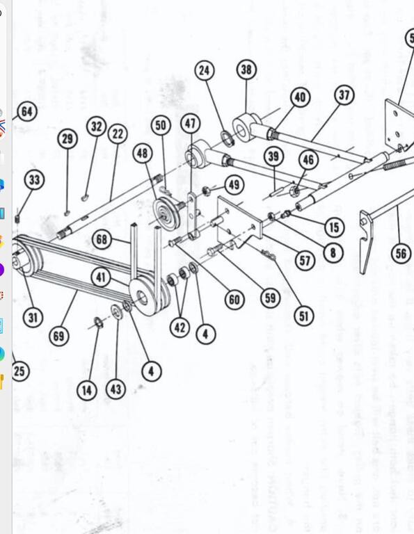

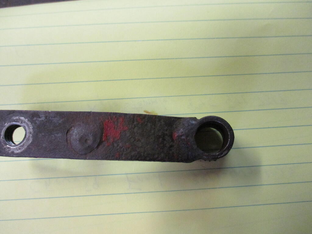

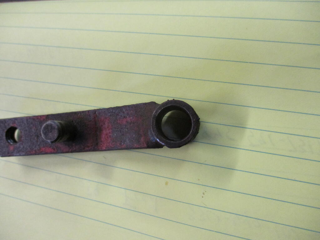

My friends badly worn RM 366 deck on his 856  is eating drive belts for the deck.    One issue is the idler pulley sits at an angle because the hole in the end of the idler arm is wallowed out.  (part# 6636 item 47) I had an extra but it is worn also.  Any ideas on how to fix it.  There is so little metal around the hole I don't think drilling it bigger and putting in a sleeve will help.

TSC has sleeve adapters for 3 point systems ranging from CAT 0-3, in thin and thick wall sizes.
Also, you can search Amazon for 3/4 ID steel bushings, but both options require cut and re- welding to repair.
Just a thought. I use those steel bushings all the time and have had good luck with both sources.

I don't see # 70. Are you talking about # 47?
Edited by squonk
pfrederi
Sorry I was looking a couple of parts diagrams you are correct it is 47

Is the stub shaft on part # 57 worn too??
If so, perhaps a Speedy-Sleeve shaft repair can be done!!
