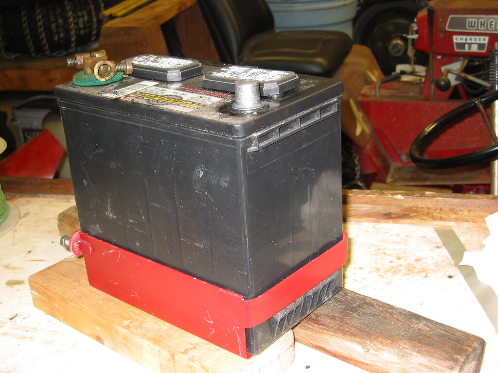

ebinmaine 80,695 #2 Posted June 14 Some used a Group 24NF. The "NF" is important. I've been using a much easier to get Group 35 in a couple of my tractors. The 35 is a little narrower than the 24NF so I put a small wooden spacer in the tray to take up the slack. The more important question is, why do you want one when the modern U1 works fine? It is absolutely paramount to make sure ALL your cables and grounds are large enough and in good condition. Share this post Link to post Share on other sites

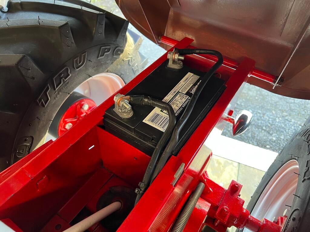

Thegearhead0324 1,843 #3 Posted June 14 In my 1257, I was using a 51 series battery, height was good and the width was shorter so could be moved a bit for clearance of wires and stuff. But then changed it up and now I have a lawn/garden battery hidden under my seat pan. 1 Share this post Link to post Share on other sites
ebinmaine 80,695 #4 Posted June 14 4 minutes ago, Thegearhead0324 said: In my 1257, I was using a 51 series battery, height was good and the width was shorter so could be moved a bit for clearance of wires and stuff. But then changed it up and now I have a lawn/garden battery hidden under my seat pan. Do you have pics or info about that? Any sheet metal modifications needed? Share this post Link to post Share on other sites
Thegearhead0324 1,843 #5 Posted June 14 @ebinmaine , yes I do, these were from few years back, I removed the tray, then clearanced out the sides a bit under the pan. I still need to made a brace going across the top but fits snug so I haven’t bothered. 1 1 Share this post Link to post Share on other sites
