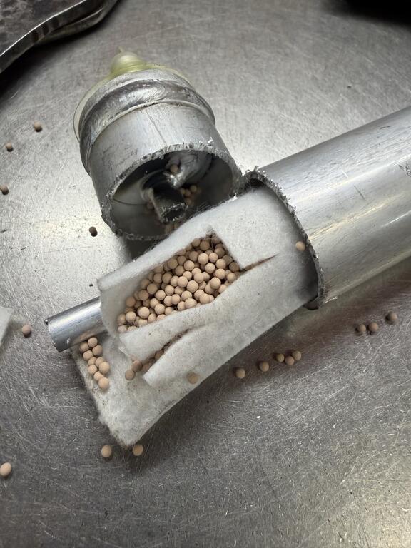

adsm08 4,770 #28 Posted 3 hours ago (edited) 1 hour ago, Blaine said: I’m still struggling to understand how anything would get inside the evaporator to clog it. I just threw about 813 silica beads at this expansion valve and not one of them made it through. Those are much larger than what is found in AC desiccant bags. The particle size is closer to sand. I have also flushed a fair amount of sand out of cooling systems in the last few years too. Edited 3 hours ago by adsm08 Share this post Link to post Share on other sites

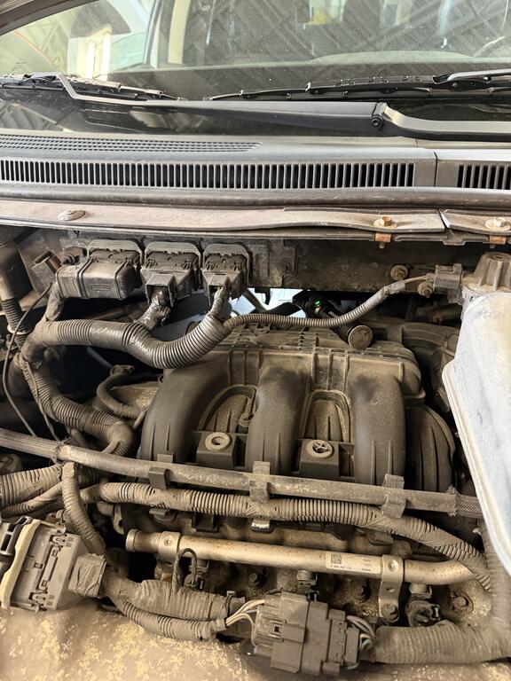

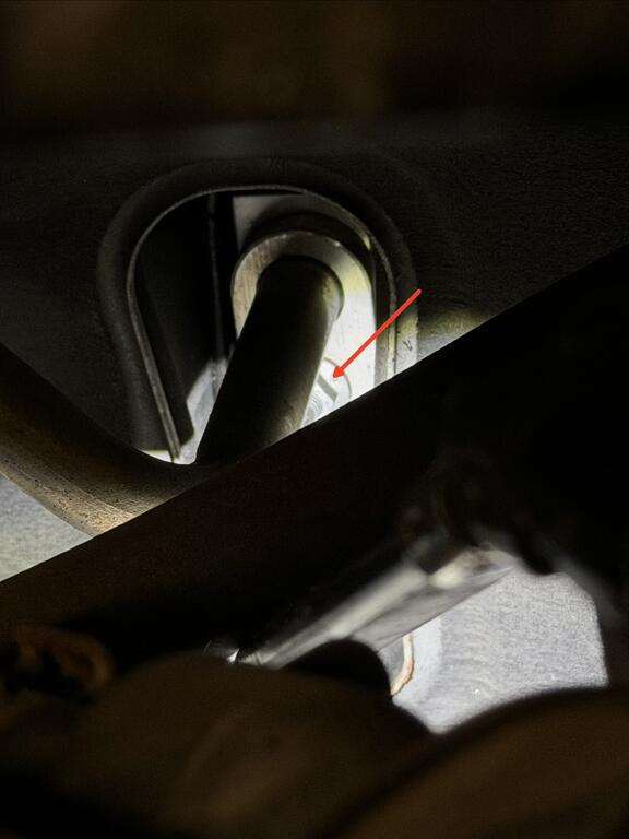

Blaine 194 #31 Posted 2 hours ago They are from an A/C desiccant bag. i have a 2008 Edge with the 3.5L v6 in my bay right now for a power steering pump. I took these pictures of the expansion valve location. If you look at that area you should be able to see witness marks around the vicinity to know if they actually swapped it out. That nut should have fresh socket marks on it. I don’t recall replacing one specifically on an Edge, but it’s deep in there, but it looks doable from the firewall side. Removing the plenum would make a lot more access room. Share this post Link to post Share on other sites
adsm08 4,770 #32 Posted 2 hours ago (edited) 13 minutes ago, Blaine said: I don’t recall replacing one specifically on an Edge, but it’s deep in there, but it looks doable from the firewall side. It is. Pull the intake and you have more room than you know what to do with. All the known drier failures I have ever seen put a sand-like material through the system. Edited 2 hours ago by adsm08 Share this post Link to post Share on other sites
