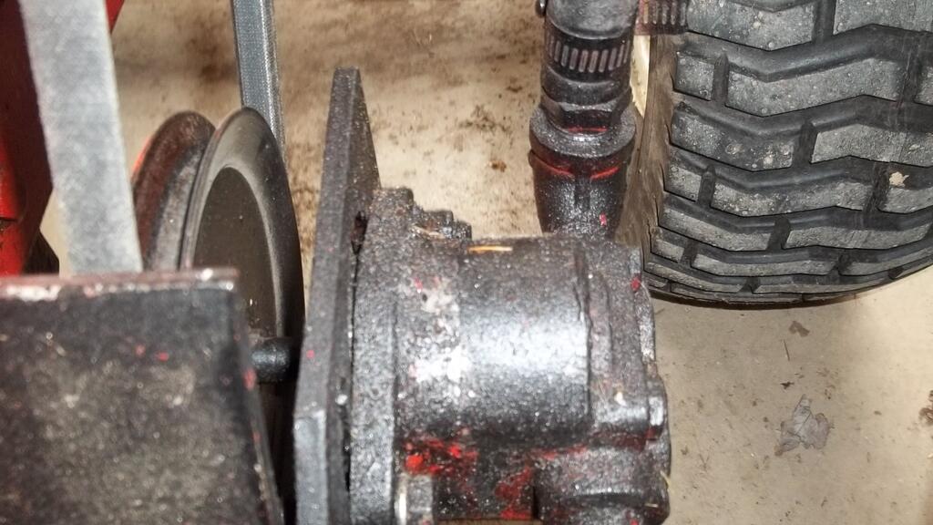

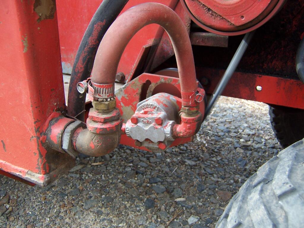

953 nut 68,455 #3 Posted May 29 Your sub-frame for the loader probably is the best place to mount the pump. Mine is not an ARK and it is a bit tight for good photo shots but here are a couple. 2 Share this post Link to post Share on other sites

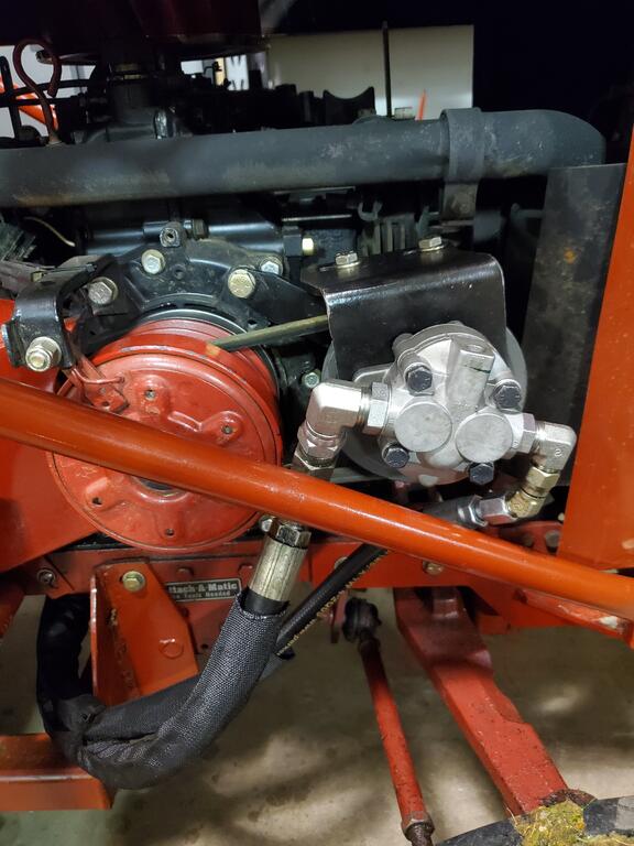

Thor27 892 #4 Posted May 30 This is only pic I have at the moment. i remember @ebinmaine posting some much better pics to explain on an older post, i found it but im not smart enough to link it on my phone.. He should be along shortly 3 Share this post Link to post Share on other sites
Thor27 892 #5 Posted May 30 @jeremi3210 i tagged you on the older post from Eric i was refering to 2 Share this post Link to post Share on other sites
