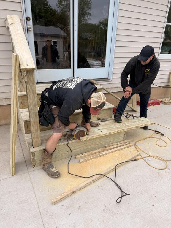

Pullstart 71,561 #1 Posted May 27 It’s a good day for a caption this, or better yet how many violations can you find? 5 Share this post Link to post Share on other sites
CasaytheMann 288 #2 Posted May 27 What's that string hanging out of the back of his battery circular saw?!?! 3 Share this post Link to post Share on other sites
Handy Don 17,735 #3 Posted May 27 Wow. It’s been years since I’ve done something like this. No blade protector on the saw. No eye, dust, or ear protection when cutting a hazardous material. Dubius support of the workpiece. Ripping without a guide fence. Possibly incorrect blade? Share this post Link to post Share on other sites
Sparky-(Admin) 26,898 #4 Posted May 27 No flip-flops…seems fine to me 2 1 6 1 Share this post Link to post Share on other sites

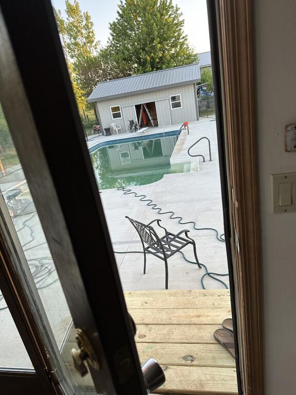

ri702bill 13,391 #5 Posted May 27 The lower end of the hand railing has no raised stop to help to keep a grip if falling. The width of the railing is excessive - difficult to grip. Looks like the door swings out - the landing is insufficiently short - does not prevent having to do a two step upon entry. 2 Share this post Link to post Share on other sites
squonk 48,427 #6 Posted May 27 36 minutes ago, Sparky said: No flip-flops…seems fine to me Stinky Cowboy boots with Jorts! 3 Share this post Link to post Share on other sites
Pullstart 71,561 #7 Posted May 27 1 hour ago, Handy Don said: eye protection surprisingly, I had it. And I’m glad, when a little cross cut trim cut shot pieces all over my face! 1 hour ago, CasaytheMann said: What's that string hanging out of the back of his battery circular saw?!?! Notice that string has been taped? 1 hour ago, Handy Don said: No blade protector on the saw. It’s custom 1 hour ago, Handy Don said: Ripping My table saw motor siezed up. Things happen, decisions were made 1 Share this post Link to post Share on other sites
Beap52 2,536 #8 Posted May 27 May be optical illusion, but it looks to me like the bottom and top risers are taller than the middle step. Share this post Link to post Share on other sites
adsm08 5,247 #9 Posted May 27 As an individual who still has all his proper body parts, I see nothing wrong here. 1 1 3 Share this post Link to post Share on other sites
My_horse 152 #10 Posted May 28 The only thing I see wrong is that saw with no guard. That thing belongs in the trash. personally, I wouldn’t be cutting, bending over like that. That’s what saw horses are for. I’ve never used eye or ear protection when cutting wood. Been doing carpentry for 30 years. 1 Share this post Link to post Share on other sites
Pullstart 71,561 #11 Posted May 28 1 minute ago, My_horse said: The only thing I see wrong is that saw with no guard. That thing belongs in the trash. It was modified for an actual purpose. I made the saw able to back cut 15 degrees, for a flush cut against a wall. I don’t use it often, unless it’s for a purpose. 1 Share this post Link to post Share on other sites
My_horse 152 #12 Posted May 28 (edited) 34 minutes ago, Pullstart said: It was modified for an actual purpose. I made the saw able to back cut 15 degrees, for a flush cut against a wall. I don’t use it often, unless it’s for a purpose. Makes sense then. Carry on! I have an old Makita that fell a couple times and the guard hangs up. That’s the dedicated “cuttin through shingles” saw. 😎 Edited May 28 by My_horse 1 Share this post Link to post Share on other sites
Pullstart 71,561 #13 Posted May 28 12 hours ago, ri702bill said: Looks like the door swings out - It’s an old door, and will some day be a slider. But it swings in 3 Share this post Link to post Share on other sites
JoeM 10,318 #14 Posted May 28 It took a while but I see what is rong Found it! No tools in pouch! 4 Share this post Link to post Share on other sites
Pullstart 71,561 #15 Posted May 28 Hey now @JoeM! The square and drill go in the big right pocket, screws in the left, tape measure in the small right. Mostly dark, or in use… but I enjoy the belt! 1 Share this post Link to post Share on other sites

JoeM 10,318 #17 Posted May 28 8 minutes ago, Pullstart said: but I enjoy the belt yeah yeah, just there to impress the ladies! "I got a tool pouch!" 2 Share this post Link to post Share on other sites
squonk 48,427 #18 Posted May 28 1 hour ago, JoeM said: It took a while but I see what is rong Found it! No tools in pouch! We don't want them Jorts fallin down! 4 Share this post Link to post Share on other sites
