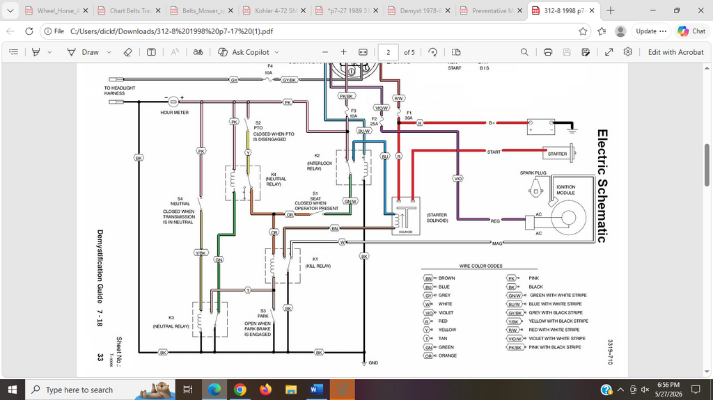

gwest_ca-(File Mod) 12,488 #2 Posted May 27 This should help. Click on the picture in the link for more Are you looking at the 5 pages of colored wiring? Share this post Link to post Share on other sites

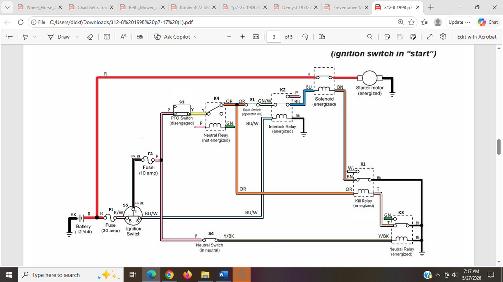

953 nut 69,298 #3 Posted May 27 8 hours ago, Rick8814 said: when I turn the key the first 10 amp fuse blows Can you give us a bit of background on what led you to replacing the ignition switch? What if anything did you do prior to changing the ignition switch that could have impacted your electrical wiring? Is the switch you bought the one Gary has given you information on? The drawing below shows all of the components that come into play when the key is turned to START. I do not own this model but suspect that the Neutral Safety Switch is located on the metal plate the shift lever comes through. Examine the wiring to that switch first. A pinched wire could be grounding out causing the fuse to blow. Check all of the wiring anyplace close to any work that has been done. Good luck and let us know what you find. 1 Share this post Link to post Share on other sites

953 nut 69,298 #6 Posted May 27 @Rick8814, Glad you are making progress. Have you attempted using a small jumper wire to the blue wire on the solenoid to confirm it works electricley. Are you in the seat (or have a weight in it) of the tractor when attempting to start it? Is the Parking Brake set AND transmission in Neutral. Both seem to be insectary to have the kill relay close. @gwest_ca, If I am not mistaken the main schematic is drawn with all switches and relays in the off the shelf position. No power to the relays and all NO switches open and NC switches closed. is that correct? Anything you could add would be appreciated. Share this post Link to post Share on other sites

953 nut 69,298 #8 Posted May 28 17 hours ago, Rick8814 said: kill relay not energizing If the kill relay is not energizing that will prevent the solenoid from closing even with power to the blue wire on the solenoid because there wouldn't be a ground path. The K4 neutral relay need to be energized and the K3 relay has to be deenergized for the kill relay K1 to energize providing a ground path to the solenoid. For testing purposes only, remove the small BROWN wire from the solenoid and replace it with a wire that connects to ground on the engine or frame, see if the engine will turn over with the key switch. If it will turn over you will know that the PTO switch and seat switch are good and the K3 relay is not energized. We will get this problem resolved, just a matter of finding out what is working and what is not. 1 Share this post Link to post Share on other sites

gwest_ca-(File Mod) 12,488 #10 Posted May 28 @gwest_ca, If I am not mistaken the main schematic is drawn with all switches and relays in the off the shelf position. No power to the relays and all NO switches open and NC switches closed. is that correct? Anything you could add would be appreciated. I believe you are correct on this one but not all are the same. That is why there are notes with the switches telling us the state of the switch or relay - open or closed. Many relays did not have the common wire correct and tried to make those corrections as I found them. They had the colors right but their location was not. That is why I added a short colored wire going nowhere on the relays. When the wiggly coil on a relay is energized the magnetic force created pulls the contact towards the coil breaking one circuit and energizing another. The contact pivots on the common terminal. 1 Share this post Link to post Share on other sites
