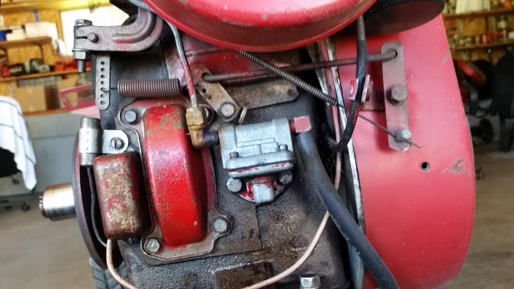

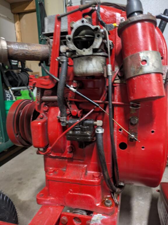

FarmallFarmer09 31 #1 Posted May 26 (edited) Just wrapped up the restoration on my 71 charger 12, with a kohler k301, but theres still a few adjustments that need done. I pulled the throttle lever and line off when redoing the engine, didn't rebuild or replace anything just took stuff apart to paint it. Before restoration, The throttle lever would work fine, all the way up on the throttle equals top throttle things like that. Well when i put it back together, It now is super touchy, like full throttle is now only half way up on the lever and now i only have idle and full throttle no in-between. Ive adjusted everything with the linkages and even bought a new spring and everything and it still doesn't work like it used to. What should i do? Edited May 26 by FarmallFarmer09 Extra info Share this post Link to post Share on other sites

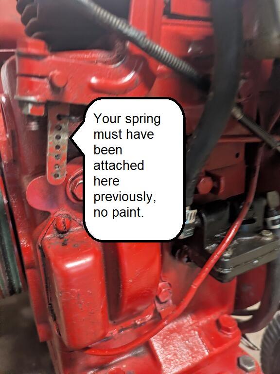

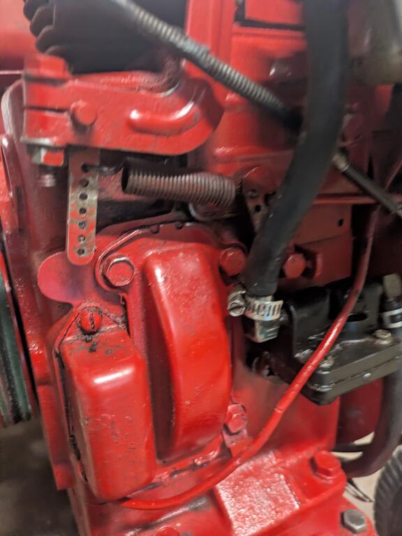

WHX?? 57,796 #2 Posted May 26 Move the spring on the governor arm to the third hole up from the bottom that's where mine like to be. Guessing you set the governor to the manual? 3 Share this post Link to post Share on other sites
pfrederi 21,046 #3 Posted May 26 3rd hole from the bottom. Make sure the clamp on the throttle cable on the valve cover is tight. 3 Share this post Link to post Share on other sites

pfrederi 21,046 #8 Posted May 26 Do you have a picture of the bell crank Share this post Link to post Share on other sites

FarmallFarmer09 31 #11 Posted June 22 On 5/26/2026 at 6:01 PM, pfrederi said: Do you have a picture of the bell crank Share this post Link to post Share on other sites
pfrederi 21,046 #12 Posted June 22 Is the governor arm ever contacting the control cable? Share this post Link to post Share on other sites
ebinmaine 80,278 #13 Posted June 22 1 hour ago, pfrederi said: Is the governor arm ever contacting the control cable? Looks awful close to the exhaust pipe too 1 Share this post Link to post Share on other sites
kpinnc 18,884 #14 Posted June 22 On 5/26/2026 at 3:20 PM, WHX?? said: Move the spring on the governor arm to the third hole up from the bottom that's 1 Share this post Link to post Share on other sites
FarmallFarmer09 31 #15 Posted June 23 23 hours ago, ebinmaine said: Looks awful close to the exhaust pipe too Yes it makes contact to the governer and the exaust pipe 1 Share this post Link to post Share on other sites
FarmallFarmer09 31 #16 Posted June 23 15 hours ago, kpinnc said: Thats what i did, but it didnt work either Share this post Link to post Share on other sites
ebinmaine 80,278 #17 Posted June 23 1 hour ago, FarmallFarmer09 said: Yes it makes contact to the governer and the exaust pipe Both of those are a serious problem. My experience shows me that the very first thing you need to do is get a proper throttle cable on there. The exhaust will melt the cable casing and make it so the interior will hardly move through the exterior. Also, the cable being against the governor arm is preventing proper motion of that whole system. 1 Share this post Link to post Share on other sites
pfrederi 21,046 #18 Posted June 23 Contact with the governor arm is a big problem.... Go under the lowest cooling fin stay behind the governor arm make sure it doesn't contact at any point in its motion 1 Share this post Link to post Share on other sites
FarmallFarmer09 31 #19 Posted June 23 2 hours ago, ebinmaine said: Both of those are a serious problem. My experience shows me that the very first thing you need to do is get a proper throttle cable on there. The exhaust will melt the cable casing and make it so the interior will hardly move through the exterior. Also, the cable being against the governor arm is preventing proper motion of that whole system. So i need a new cable on it Share this post Link to post Share on other sites
pfrederi 21,046 #20 Posted June 23 15 minutes ago, FarmallFarmer09 said: So i need a new cable on it If the cable still moves freely I suppose you could keep using it but REROUTE it 2 Share this post Link to post Share on other sites
