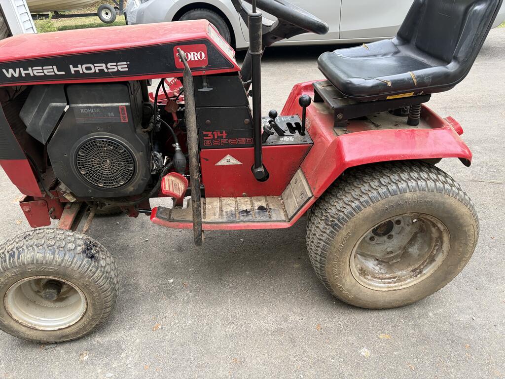

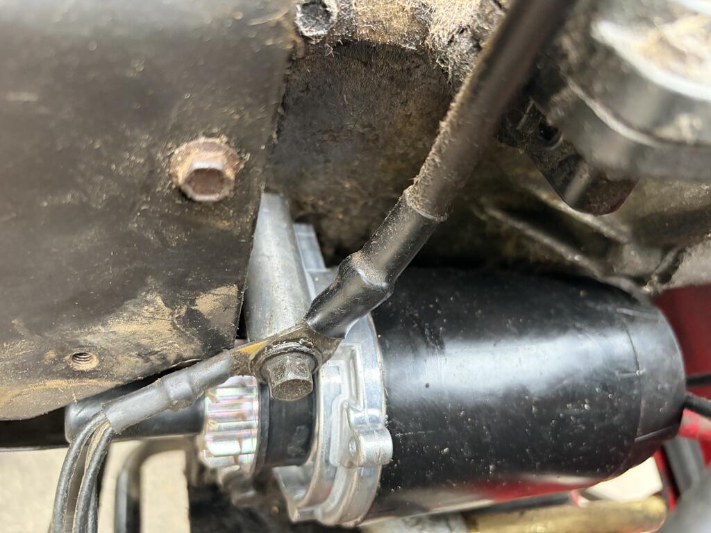

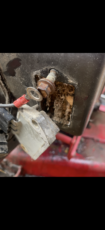

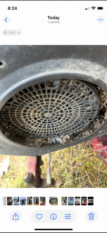

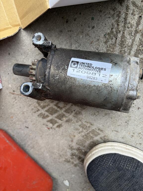

AHS 1,703 #1 Posted May 25 History of the machine; 11/25 i got it from up North, from the original owner. It hadn’t ran in 6 years, so i cleaned all the mouse nests out, (it was full of mouse nests!) , started it. It runs 100%. It’s got 464 hrs on it! The only issue with it, was the starter (so i thought!). I would go to start it up and the starter would engage but the motor wouldn’t turn, and then i would turn the key off and to start for a little bit until it got over that stroke and then it would start just fine! I figured the starter had mouse crap all in it, so i replaced it yesterday. It’s been thru 3 starters!?!? United technologies automotive was the starter i took out it, (it doesn’t look like a kohler brand starter). So, the new starter does the exact same thing! Now hears what i think! The original owner must have had stating issues with it at some point, so he replaced the starter. It must be the solenoid, the +/- system, the key switch or the compression release of the motor? Im stumped! Has anybody had this issue? My next thing has got to be replaced the solenoid and check for cracked wires? Share this post Link to post Share on other sites

squonk 48,427 #5 Posted May 25 Clean the starter mounting pads on the starter and where it bolts on the engine. Check and clean the ground cable. 2 Share this post Link to post Share on other sites
AHS 1,703 #6 Posted May 25 1 hour ago, squonk said: Clean the starter mounting pads on the starter and where it bolts on the engine. Check and clean the ground cable. Ok! I was sure the starter was the problem. Cleaning the connections and fuses. Like @ebinmaine answered, valve adjustment. Could the valves be to tight? That would make it hard. Share this post Link to post Share on other sites
