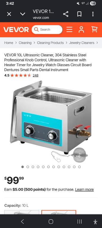

ebinmaine 79,492 #2 Posted May 24 I bought the Vevor 10L size 3 years ago. Works good. 1 Share this post Link to post Share on other sites

ebinmaine 79,492 #9 Posted May 25 8 hours ago, Brockport Bill said: how many minutes do each of you run the unit to get your item clean? how many minutes can your machine operate in cleaning cycle before it times out and has to be re-started? thanks. Bill The unit I posted a picture of above has a timer for 35 or 40 minutes. On an average cleaning I'll do 3 or 4 sets of that. I've had particularly nasty cases where I've left a carb in the lacquer thinner for a couple weeks and cycled the machine a dozen times or more. The usage alone will generate some heat. Not much, but definitely a noticeable change. I do NOT use the additional heat because of the fire potential. 2 1 Share this post Link to post Share on other sites
