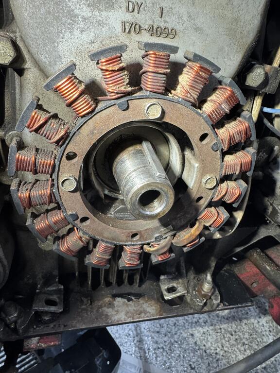

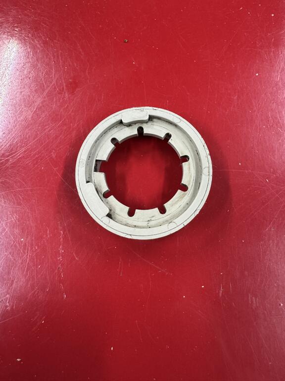

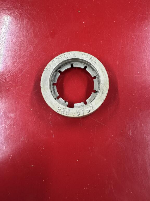

Took off the plastic trigger ring using a small hook-end pic.

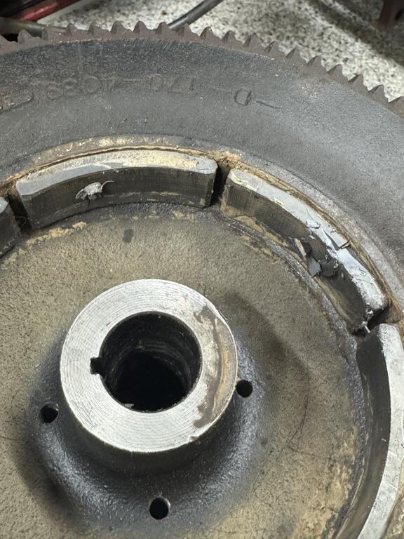

Found a few small pieces on the flywheel magnets of what I assume are old flywheel key and/or pieces gouged off the crankshaft.
Cleaned the trigger ring with acetone.
Reinstall the ring with correct side out.

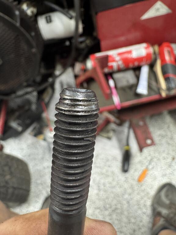

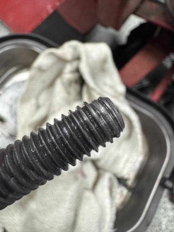

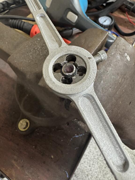

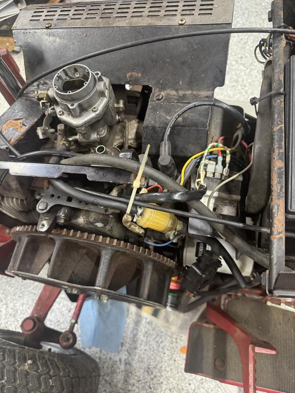

But now…I don’t like the way the flywheel bolt threads in. The first few threads look sketchy so I rethreaded them. Still don’t like the way it threads in - to tight. I tried a standard 7/16-14 and it felt the same way. I’m thinking I just screw it in…
Edited by PWL216
  • Like 1
Bill D
You should replace the flywheel.  That magnet will shed more pieces, jam into the charging stator and ruin the stator or break the stator mounting tabs off the cam cover.  You can chase the threads in the crank with a tap.
  • Like 2
sqrlgtr
This would be my biggest worry and would really check magnets out. If I were in doubt, I would try and run down a good fly wheel. Its hard to tell in Pic how much damage has been done through and if you're not worried about them then go for it.

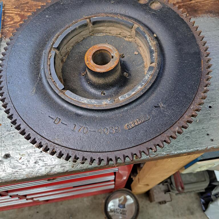

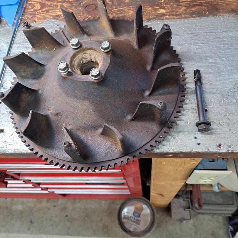

WHX??
Posted (edited)

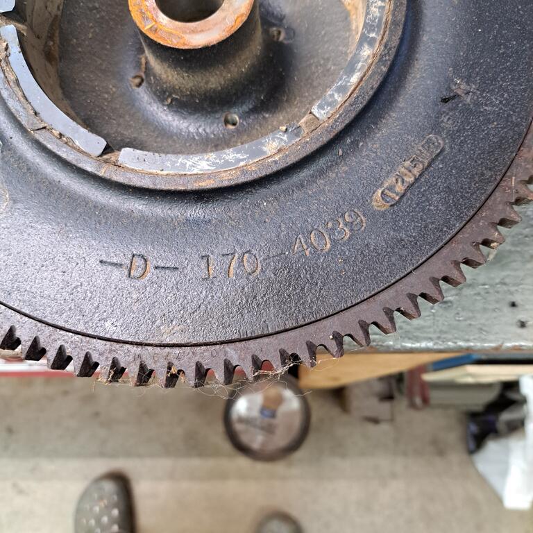

I have a flywheel. Might have the bolt and key way too. Yours for a case of beer. I parted out a PPG20 awhile  ago and pretty sure all i sold were the pistons.
Will get it out for pictures when I get home. At my cabin for a couple days yet.  Remind me PW or I WILL forget

WHX??

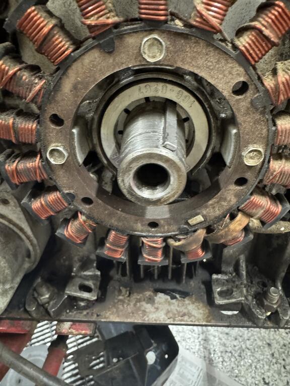

Lookin at your pics it doesn't look like the crank is tapered. Might be just the pic.  The one I have is tapered for sure.  I haven't looked up part nos yet but looks like it sports the same one I have.
What do you guys think ... right one? Hate to send it out if it ain't.

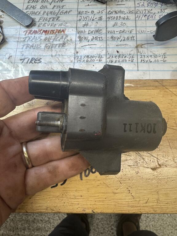

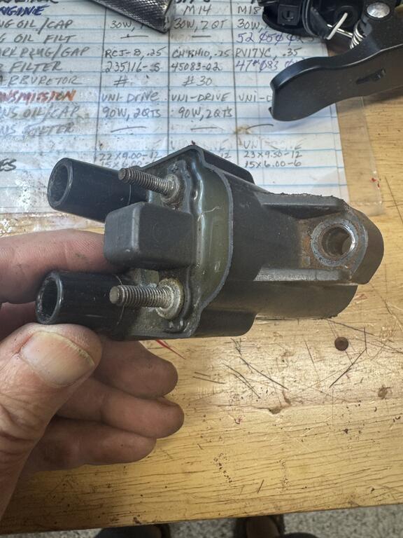

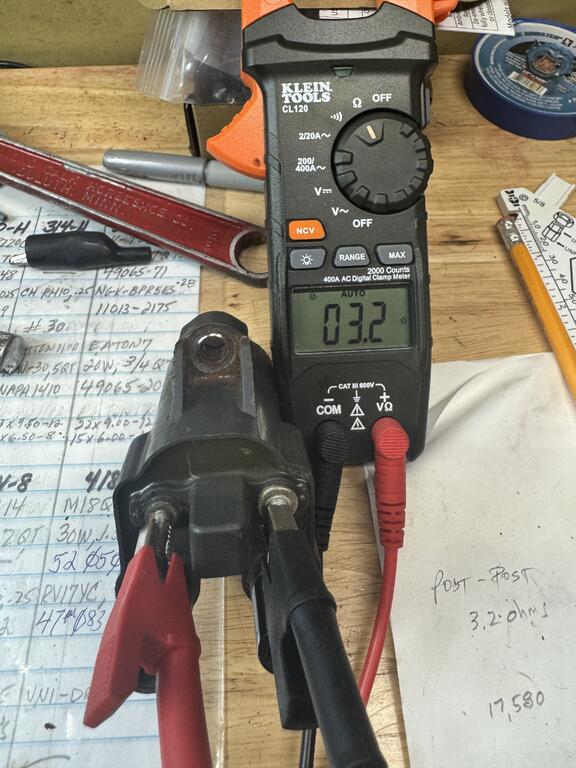

Update….
1. Timing ring installed
2. New flywheel installed
3. Spark plugs are new and gapped at .025
- not starting still
4.  Installed new coil wires

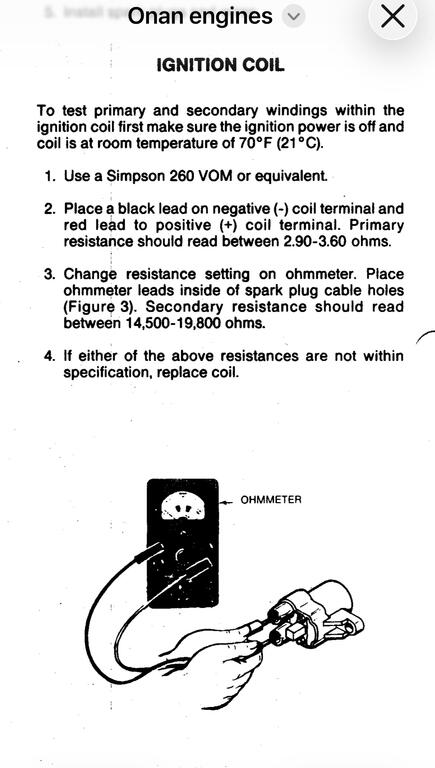

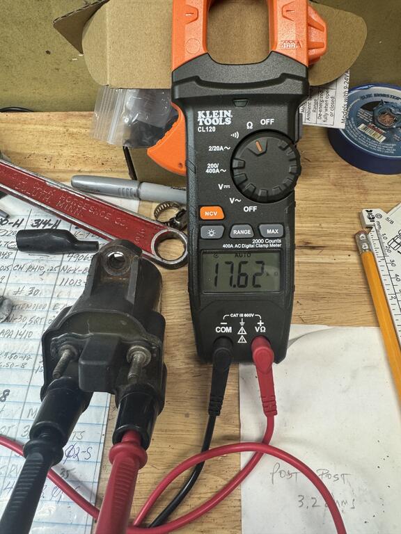

5. Removed starter coil
- no cracks
- ohms out fine (pics attached)
* confirmed proper oil level to eliminate the possibility of the low oil sensor preventing it from starting
