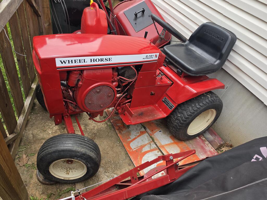

Goldnboy 1,156 #1 Posted May 17 Picked up a decent C161 auto yesterday at a local WH show.. any ideas why the motion control will stick in reverse and only way to disengage is to turn off the engine? It does has a hack wiring job that I will redo from scratch once this is resolved. Share this post Link to post Share on other sites

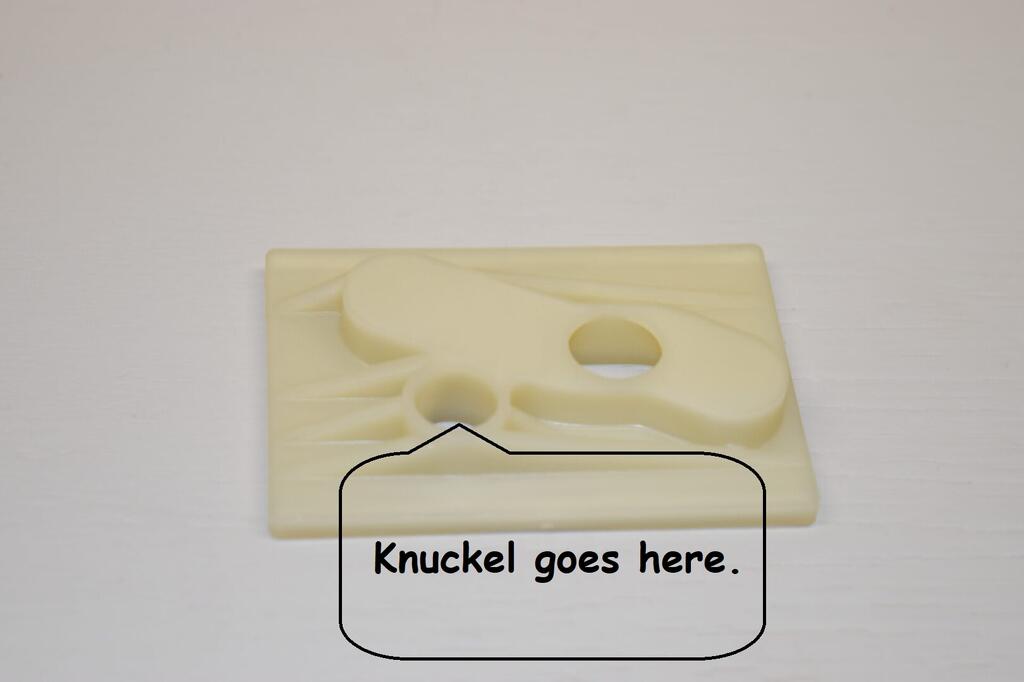

953 nut 70,649 #5 Posted May 17 27 minutes ago, Goldnboy said: sunstrand auto You probably need a new plastic cam plate to cure the problem. 1 Share this post Link to post Share on other sites

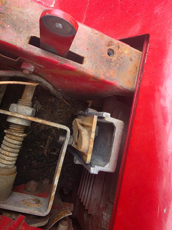

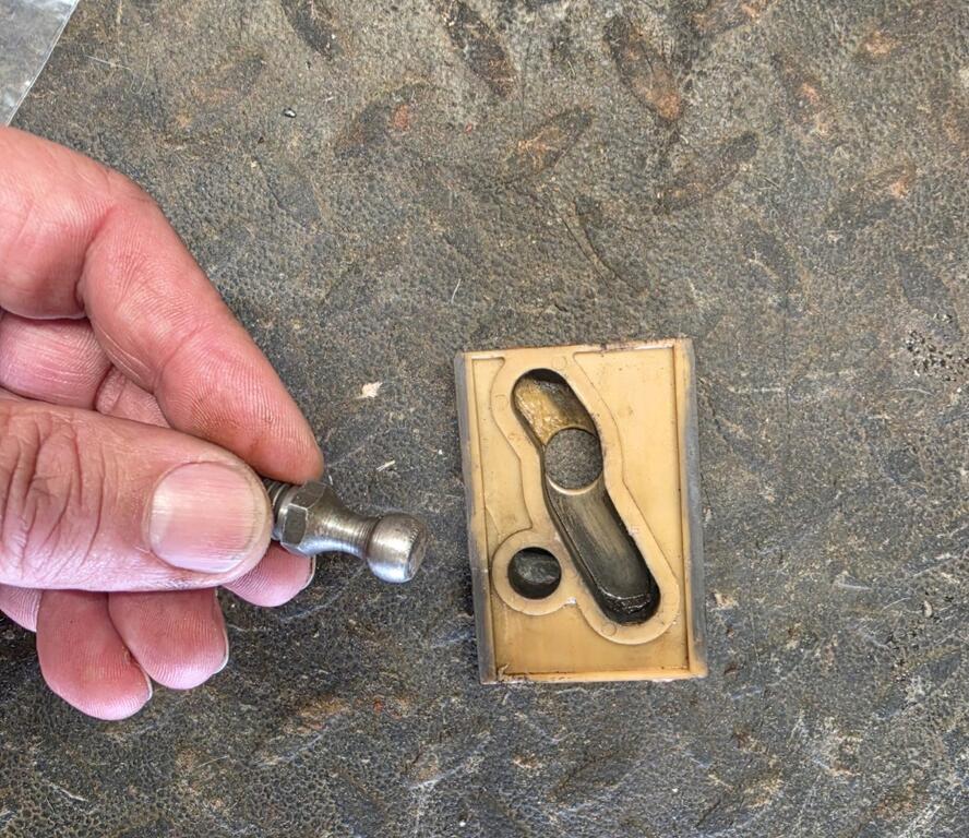

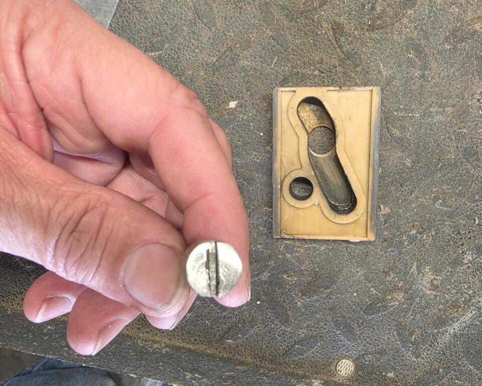

Goldnboy 1,156 #12 Posted May 26 (edited) @squonk was good on his method worked well but I needed to remove right foot rest and belt guard to remove drive belt. The eccentric wouldn't move but I worked it loose with vise grips. It was rough and had burs along with the ball. I cleaned up with wire wheel mill file and sanded very smooth. I put everything together with new plastic cam and motion control worked really good and stayed in neutral. Unfortunately in the process I noticed I have cracked frame mounts.... Edited May 26 by Goldnboy 1 Share this post Link to post Share on other sites
squonk 48,427 #13 Posted May 26 20 minutes ago, Goldnboy said: @squonk was good on his method worked well but I needed to remove right foot rest and belt guard to remove drive belt. The eccentric wouldn't move but I worked it loose with vise grips. It was rough and had burns along with the ball. I cleaned up with wire wheel mills file and sanded very smooth. I put everything together with new plastic cam and motion control worked really good and stayed in neutral. Unfortunately in the process I noticed I have cracked frame mounts.... Good thing you did it that way. Otherwise you wouldn't have discovered it until maybe it was too late! I had a leak at the shaft that cam operates and was putting it off until I felt the seat moving around whilst mowing. Discovered this! 1 2 Share this post Link to post Share on other sites
