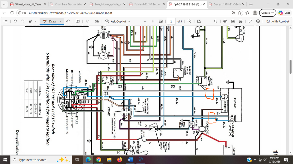

gwest_ca-(File Mod) 12,488 #2 Posted May 16 First thing I would do is disconnect the wires between the engine and tractor harnesses. Wires will come out on the back side from behind the flywheel. If it then runs it will not shut off because the ignition wire is not grounded. A model number and serial number will give us a chance to look at how it is wired. 1 1 Share this post Link to post Share on other sites
953 nut 69,297 #3 Posted May 17 The four wires blocked in red are the two oil switch wires are blue, white for charging and Dark Blue is the one that grounds the Mag to stop the engine. Share this post Link to post Share on other sites
