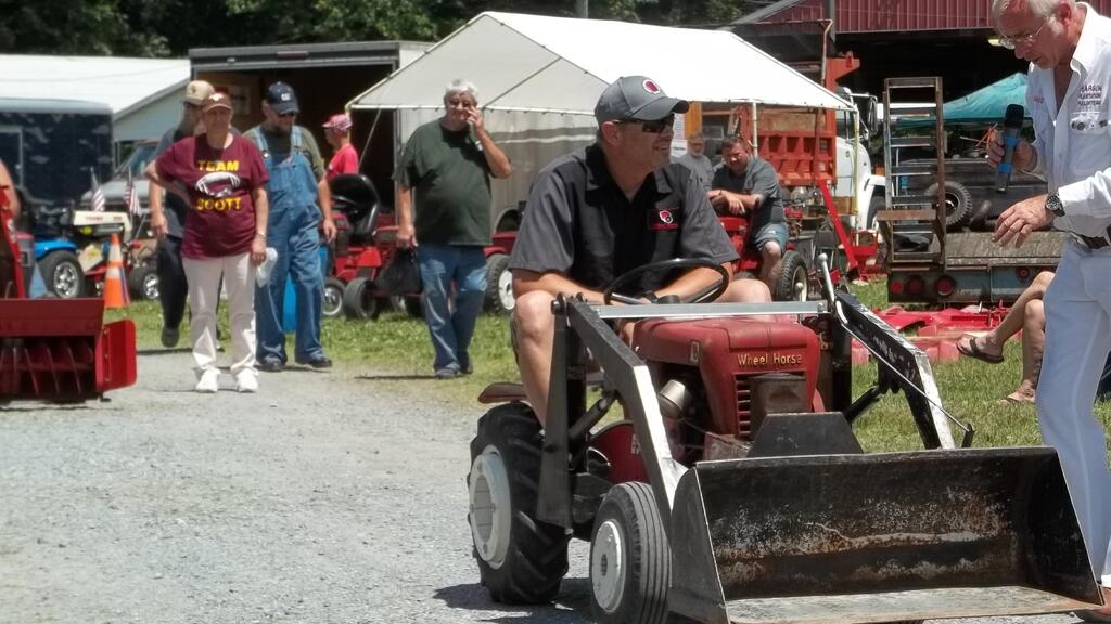

953 nut 70,649 #2 Posted May 14 (edited) Loaders have been fitted to most any Wheel Horse but as a practical matter the Commando 8 may be a little underpowered for a loader. The loader must be accompanied by a subframe which will be mounted to the tractor, most of them are made for larger long frame tractors. Here is a picture of a loader from the Big Show, I don't know who it belongs to. Edited May 14 by 953 nut add photo 6 1 Share this post Link to post Share on other sites

Pullstart 71,561 #8 Posted May 15 13 hours ago, 953 nut said: Loaders have been fitted to most any Wheel Horse but as a practical matter the Commando 8 may be a little underpowered for a loader. The loader must be accompanied by a subframe which will be mounted to the tractor, most of them are made for larger long frame tractors. Here is a picture of a loader from the Big Show, I don't know who it belongs to. That is DJ Harrison on the tractor, @hcminis. 1 1 Share this post Link to post Share on other sites

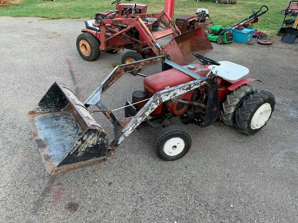

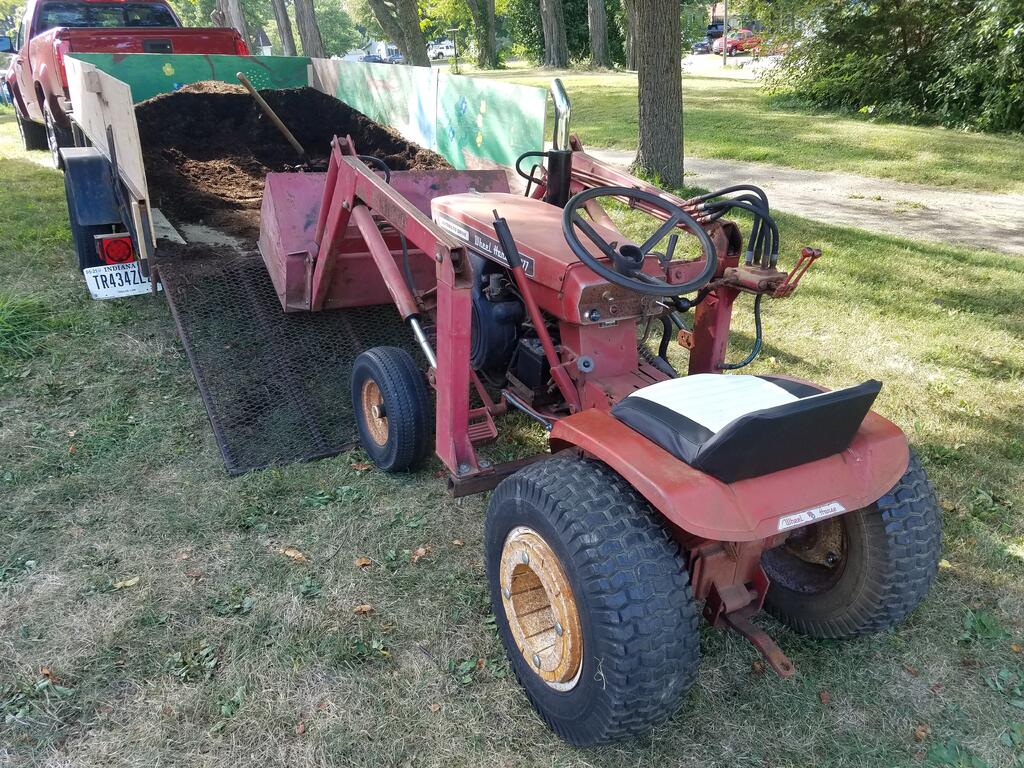

hcminis 1,818 #9 Posted May 15 14 hours ago, Pullstart said: That is DJ Harrison on the tractor, @hcminis. Yup, that was mine. Sold it several years ago and regret that ever since. But did buy the pride of my stables from the funds that were made from that rare Danco loader set up 2 Share this post Link to post Share on other sites

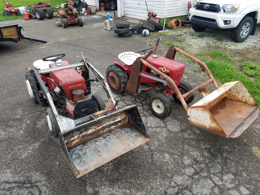

hcminis 1,818 #10 Posted May 15 Here are a few more pictures of that machine with a fellow collector machine also. Plus another picture of it with my other 1277 and ARC500 loader 3 Share this post Link to post Share on other sites

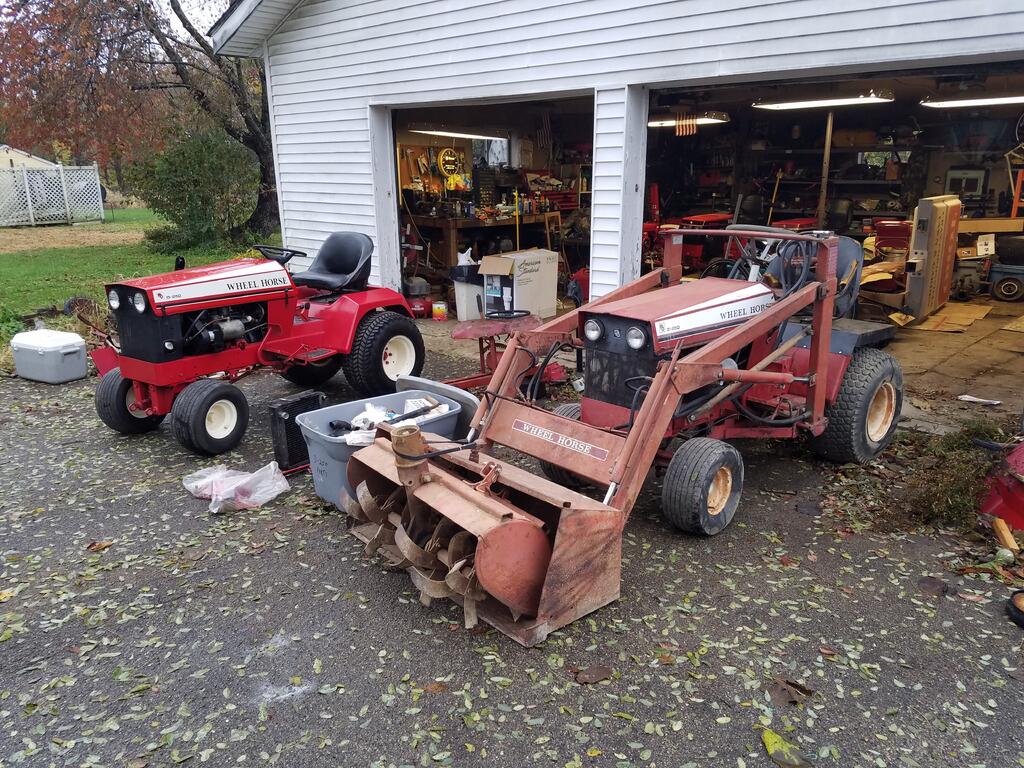

hcminis 1,818 #11 Posted May 15 Here is another picture of the 1277 working. Plus a D250 that had an ARC550 on it. 2 Share this post Link to post Share on other sites
1968Commando 189 #12 Posted May 15 48 minutes ago, hcminis said: Here is another picture of the 1277 working. Plus a D250 that had an ARC550 on it. What am I looking at for a wheel horse 1277 loader setup like that, that would be perfect, how’s if perform, can it lift alot? Share this post Link to post Share on other sites
hcminis 1,818 #13 Posted May 15 14 minutes ago, 1968Commando said: What am I looking at for a wheel horse 1277 loader setup like that, that would be perfect, how’s if perform, can it lift alot? Believe the max is 500 pounds Share this post Link to post Share on other sites
