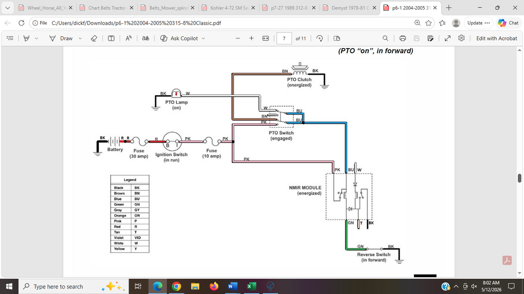

gwest_ca-(File Mod) 12,557 #2 Posted May 12 The pto switch gets it's power from the No Mow in Reverse module. I should rephrase that - gets it's power from the ignition switch but the NMR module controls the pto clutch. There is a test procedure for the switch. Click on the picture of it. Module test proceedure 2 1 Share this post Link to post Share on other sites
953 nut 70,651 #3 Posted May 12 As @gwest_ca pointed out, there is a lot going on to keep the mower turning. The first step should be to examine the wiring system for corrosion or loose contacts. The drawing below shows the electrical components that should be looked at. When the PTO stops turning does the PTO light also turn off or is it illuminated? Is the connector on the back of the PTO Switch good and tight? Are the connections at the NMIR switch good and tight? How about the reverse switch, it may have some debris that causes it to open thinking it is in reverse? Your fuses are near the battery and it is not uncommon for the fuse holders to have some corrosion in them. Just5 a few places to look before spending money to replace a switch that may be perfectly good. 1 Share this post Link to post Share on other sites
