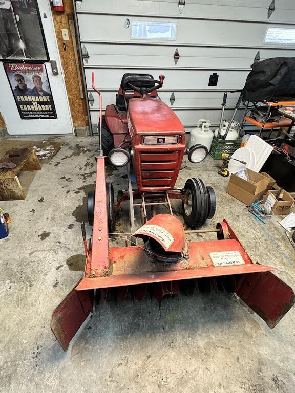

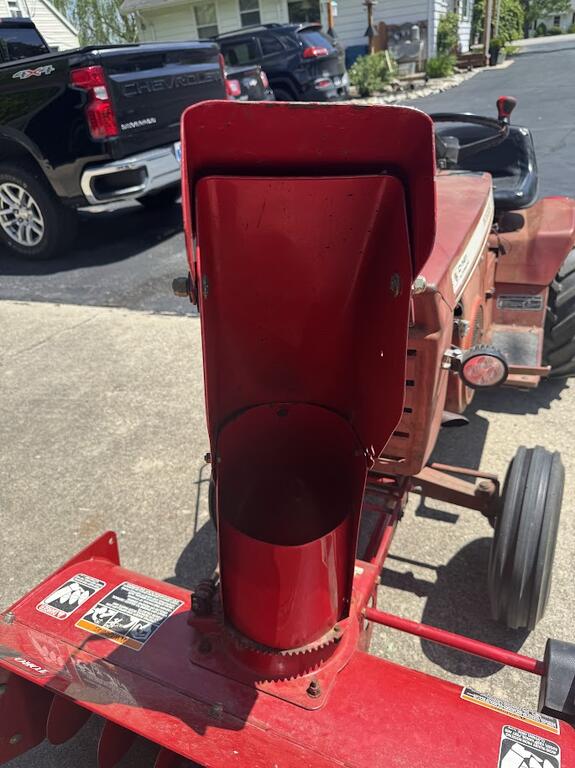

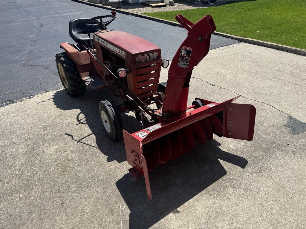

Bar Nuthin 3,643 #1 Posted May 10 Wasn't looking for a snowblower, but happened to catch a good deal on a really clean tall chute nearby our office in Plymouth, MI. Should be a nice upgrade from my crusty old short chute. Just need to take it the @peter lena school of lubrication before I store it for the summer. 10 Share this post Link to post Share on other sites

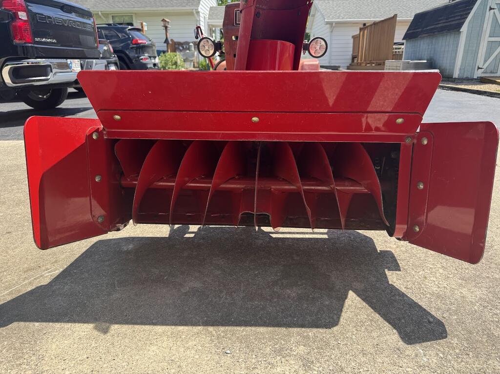

wallfish 20,744 #3 Posted May 10 A lot less blast spray off the chute compared to a shortie so you won't look so much like a snowman afterwards. You can tweak those auger ends back into shape with a crescent wrench. 1 Share this post Link to post Share on other sites
ri702bill 13,392 #4 Posted May 10 7 hours ago, wallfish said: You can tweak those auger ends back into shape with a crescent wrench. Yup - annual maintenance item. Sell the old one in the fall - and it's a win-win. 1 Share this post Link to post Share on other sites
rjg854 13,454 #5 Posted May 10 10 hours ago, Bar Nuthin said: Wasn't looking for a snowblower, but happened to catch a good deal on a really clean tall chute nearby our office in Plymouth, MI. Should be a nice upgrade from my crusty old short chute. Just need to take it the @peter lena school of lubrication before I store it for the summer. Hardly looks used, unless some touched it up. 1 Share this post Link to post Share on other sites
peter lena 10,125 #6 Posted May 10 @Bar Nuthin good score , if nothing else , get a good penetrating oil spray down on that , to feed that dried chalky paint , retain / recover original patina , also a good time to use a threading die nut , on the lever end of the chute swing rod ? what could you possibly do ? pick up a matching threaded screw on knob , local h/ ware , big box , much better with gloves / mittens , pam spray chute , for slick discharge . also like a snow slider gasket under the chute base , for effortless swing . agree on the auger blade , rebend , chain / cable spray on auger drive , have regularly tweaked , any hang up spots , sold one like that years ago , pete 1 Share this post Link to post Share on other sites

Bar Nuthin 3,643 #8 Posted May 10 10 hours ago, wallfish said: You can tweak those auger ends back into shape with a crescent wrench. Yeah, I noticed that after I took the photos. I think I have it dialed in now. gave it a test spin at full RPM and don't notice any vibration or shaking. I think it may have been bent in transit or storage, as there's nothing that would indicate impact from being used. Doesn't look like it's seen much use at all. 1 hour ago, rjg854 said: Hardly looks used, unless some touched it up. Appears to be original paint. The guy I bought it from had a few tractors, wagons, and implements, etc. - but his outside property was smaller than my driveway. His concrete drive was only about 50' long. He also had rebuilt K341 spec engine under his workbench, but he wasn't parting with that. 2 1 Share this post Link to post Share on other sites

Bar Nuthin 3,643 #10 Posted May 10 (edited) 1 hour ago, Razorback said: I thank GOD that we generally don’t need snow blowers here in NW Arkansas (ONE time, we got 2’ of snow all at once… would have been handy then!), but THAT is the kind of deal I’d hope to stumble upon if I was searching for a blower, that’s for SURE! 9 times out of 10 my snowplow blade is adequate here in NE Indiana. This past winter we had a couple of storms that were a challenge because I couldn't get enough snow out of the way to start cutting into it. My old snow blower got the job done, but the short chute and its cable control were problematic. I needed more control over where I shoot the snow. Also, I lived through the Blizzard of '78, so I know we're not immune to some ridiculous drifting. Edited May 10 by Bar Nuthin 2 Share this post Link to post Share on other sites
